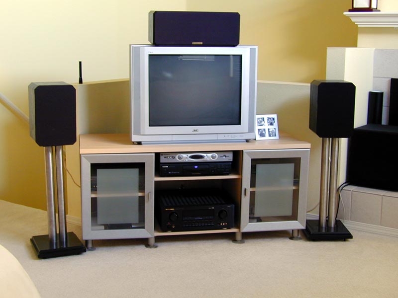

Here is a picture
This is of the Ed Frias DIY bookshelf speakers that I built last year along with the speaker stands I built as well.

description of speakers in picture
The left and right speakers are the Ed Frias DIY's I spoke of. The center is a BIC DV62CLR-S with a modification on the crossover to match the left and right speakers (performed by Ed Frias himself). All of this powered by a Marantz SR6000. The drivers in the DIY's are Peerless. Peerless Mid-woofer Model # 850122 and Peerless Tweeter Model # 812687. The crossovers are made custom by Madisound specifically for the Ed Frias DIY. I'm not sure you can get all this over in India but if you can I would make the effort, you will not be dissapointed.
