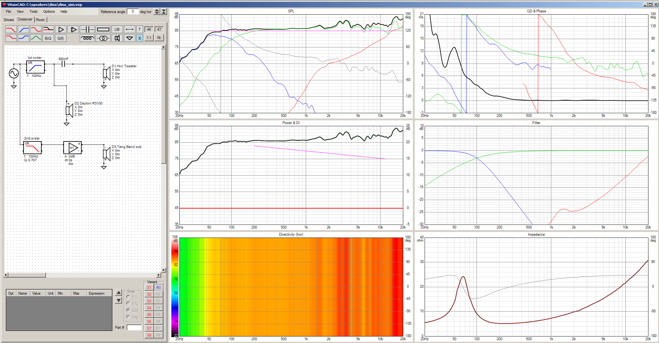

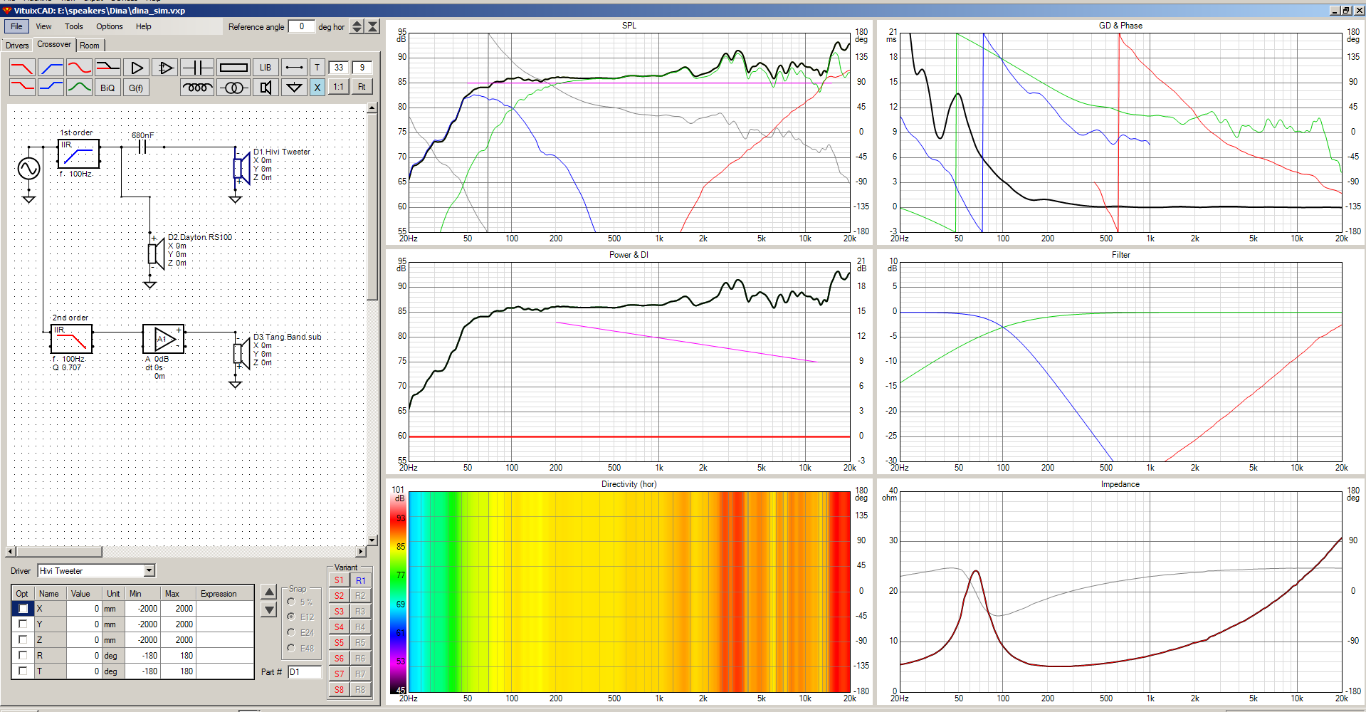

I got curious and decided to download the dayton frd and zma files and traced the tang band and hivi response and impedance.
Put the whole thing into vituix cad and below is the result. Note that I have not adjusted any of the manufacturer curves for bafflestep so this is not a particularly realistic sim and in fact I would expect the bass to be lower than what it shows.
The tweeter is having more of an effect that I anticipated, but I wouldn't necessarily call it positive 😉 It does smooth out some dips to a degree but accentuates the peaks as well.
The (unadjusted) curves for the tang band and the dayton do actually blend quite well using the 12db / octave LP on the woofer at 100Hz and the 6db / octave HP on the dayton/hivi, so I think the issue is with the large variations above 3Khz.
I've attached a zip file with the frd's and vituixcad project file. Vituixcad can be downloaded here Software
Note if you extract to c:\ it will create folders c:\speakers\dina and the project file will load and all will work properly. If you want to put it elsewhere you will need to edit the dina_sim.vxp project file and change all instances of c:\speakers\dina\ with whatever the new path is.
To do a proper crossover model for tweeter to mid baffle step compensation (based on the dimentions of the box) should be incorporated.
edit: I've not put in any of the speaker offsets either which also should be present. This was a quick and dirty sim to get a rough idea of how the speaker was working.
Tony.

@wintermute rite on man, this is way more then I thought. I ordered new plate amps to come in Tuesday and am going to wire it up and see what it sounds like after tweeking some things. Will upload some pics and or video and let you know the outcome. Thanks a ton for the info, i might just go the route of cross overs any way. Just ordered the Marantz 5013 to start a new system .

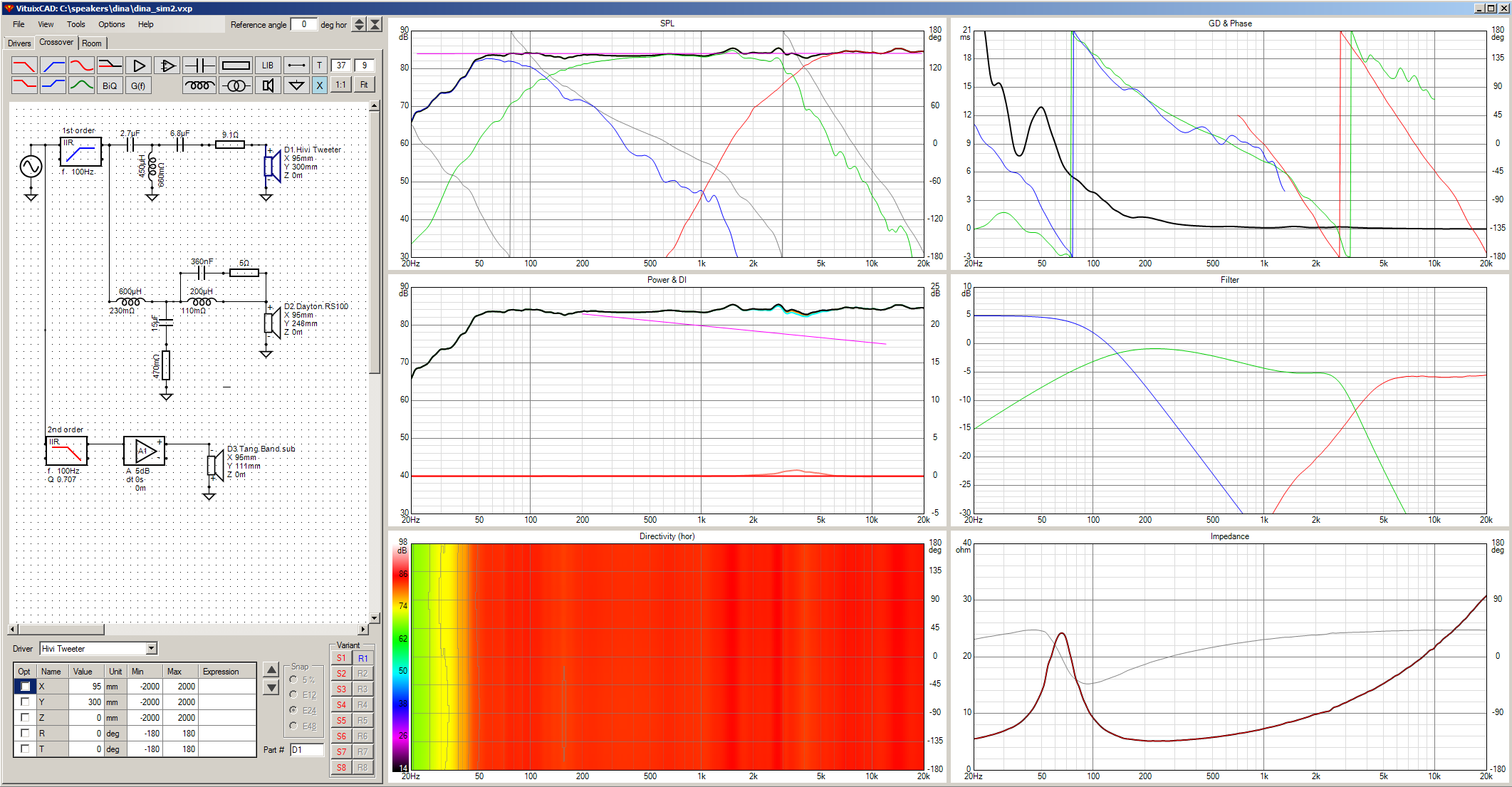

OK so a new upload of the SIM. I fixed the tweeter impedance, and since I already had all the frd's decided to do the baffle step (using vituix cad) and see how it looked with that, then I decided to do a passive network to cut the tweeter in at a more reasonable point. I also found that the downloaded dayton frd's and zma's weren't minimum phase, so fixed that.
This was an academic exercise to see what may be a possible improvement on the design. As it is using the manufacturers curves I wouldn't put too much weight on it, but it would probably be a good starting point, especially if you could get some good measurements of the drivers in the box. The biggest difference is likely to be the tweeters response on the box, as I can't sim the diffraction effects it will likely be subject to.
I looked at a youtube video from the designer, and the tweeter in the as designed position is supposed to be time aligned, so I put no Z offest in the sim. I took a guess for the tweeters vertical offset (it makes only a small difference to the sim).
I'm not very good at 2nd order crossovers, so I have gone with a 4th order acoustic L/R at 3Khz with 84db target level. This does reduce the sensitivity a bit, but I suspect it would be more balanced. I think it equates to between 3 and 4db of baffle step compensation. For the sub I increased the gain 5db (i think the plate amp can do 6db boost on the sub.
The phase matching isn't fantastic, but they aren't real measurements so there was no point in going for perfection. Obviously this is a much more complicated crossover than the single cap, but I suspect something like this would make a pretty big difference to how the speakers sound.
As I said before, 4K may be a better crossover point for the tweeter, but 3K is probably better for the dayton...
So the new sim is attached, same as before but now has corrected (hopefully) frd and zma files and also three sims. The original dina_sim, dina_sim_bs (with baffle step corrected sub and mid) and dina_sim2 (4th order L/R at 3Khz) Note that the FIR block to simulate the 100Hz HP in the plate amp turns off the real impedance of the network, you can see it by temporarily shorting the FIR block.
Anyway I had some fun with this, hope it is at least a bit educational 🙂
Oh and one other thing. Since the plate amp has speaker outputs, you could always put some binding posts on the back of the box and run a wire from the plate amp output to the binding posts and avoid having to solder to the connections on the amp board. Little more hardware, but hopefully safer!
Tony.
