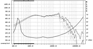

It seems so. I made this only last night and made only a couple of quick measurements.
The straight horn in this size seems to load the Neo from 400-2.5k. Below 400Hz I had to add a plateau of about 4db, then the neo was essentially flat from 200-20k. I think a bigger horn would load lower on the expense an earlier HF rolloff. As my crossover is at 265Hz, I'm happy with the size.

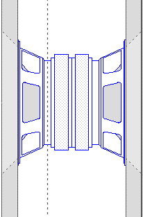

Planet10 suggested a push-push TL for it but I don't know how to make such a line.. Planet, how's the project going ?
Check out the push-push sub thread and the cheap SET thread -- i've just posted push-push pics in both that aren't on my site... and there are some examples on my site too (mostly in the FALL section).
Push-push just means mounting the drivers in the relative configuration shown below... usually it is not practical to get the magnets touching (which is ideal). In this case the speaker needs magnetic shielding, which the magnet-to-magnet provides.

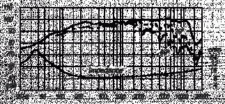

ashok said:

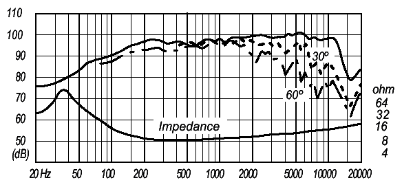

Can anybody suggest a good 10 inch or 8 inch that will sound absolutely clean up to about 700Hz. Any break up at 1 or 2 Khz will in my opinion be very audible as noisiness. Any units with a controlled response beyond 700Hz ?
Thanks.
Ashok.
You could try one of my favorites, the Audax hm210z12, freq plot below;

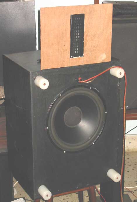

Thanks for all the suggestions. I searched the web for 8 inch and 10 inch drivers with smooth response above 700Hz till it rolled off. Many have severe cone break up beyond 2KHz. The 8 inch units were much better generally. Paper and PP cones seemed to be a bit smoother . Then I accidentally came across the response of the Peerless 12 inch driver 831857 and was surprised that it looked relatively flat over its whole range except for a dip just after 500Hz. You can find this driver in the Peerless Classic range at http://www.d-s-t.com/main/index.htm
I just happen to have a pair of these drivers. One is boxed in a sealed enclosure and is a down firing sub and generally not used.
So I put it on a stool and set the Planar Neo8 on top. Crossed over at 700Hz and bi amped. The system sounds very good. The box is not very good and I will have to build a narrower and taller one.
Vocals are good and bass is deep and tight. The system will not beat other expensive implementations. BUT it still sounds very good. I think some tweaking and a lower crossover frequency will make things even better. The drive units cost about $140 per channel. Less than about $300/- for a stereo pair ! I have attached a picture of the quick implementation I made. I will tweak the system to see how much better it can get. Note that the dispersion of the 12 inch driver is very good at 500 Hz. The listening test seems to confirm what we see in the graph.
It looks like you cut a hole in a piece of wood, mounted the BG from the rear and made your amp connections.
Is that true??!

Yes I mounted the Neo8 from the rear on a 3mm piece of ply.
The speakers were connected to the amp directly. Th ecrossover was not great. I'm sure it will sound even better with a proper crossover.
Subsequent tests showed that the Neo3 tweeter did help to improve the extreme high end.

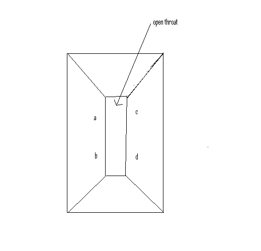

fcserei - do you mean you surface mounted lines of neo8's facing (@75degrees) each other near the throat? Has this done anything to the neo8 peak around 10K? Thanks.
PS How's the vertical response strike you? sorry for all the questions, just a cool idea you have.

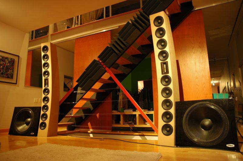

Oh boy! It's been a long time since then... I made many iterations of the line array with various tweeters and midwoofers. This is my last version. I now use nine widebands with no Xover ( MaxFidelity PR65Neo) and one Fountek Pro5i with a 3,3uF cap. The lines are curved open baffles 102dB/watt . Subs are MaxFidelity 21" in sealed boxes. So far best setup by a large margin. The main difference between a line and a point source is the radiation pattern. With a line, the sound is more holographic. You are part of the music. Presentation is very forward. Soundstage is immense with abyssal depth. If you like to be seated in the front row of a concert, this is it. If you prefered a more laid back approach, a point source might be a better choice.
Never tried the Mundorf ribbon. Look like a nice tweeter. Raal's are very impressive.

How are the PR65's on their own? I thought they were midrange drivers with a high fs?
This system is cool! Do you call this a 'point source' due to the central tweeter? It looks like a dipole line mid, point source treble and monopole bass -? Are you doing anything electrical with the mid line or just using it full range?
