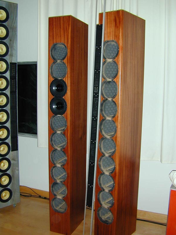

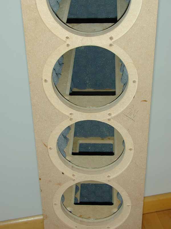

Dimensions are 86"x9.5"x16". The baffle is 1.5" MDF. The enclosure is heavily braced. One brace per driver. I used Black Alsphat Saturated Felt on all surfaces except the baffle. Same with Grey Convoluted Open Air Cell Acoustic Foam. Veneer is African Bubinga. Internal wires are QED Silver Anniversary. Total cost of the project: around $3000 Canadian which is not much in U.S. currency 😉

Yes they are SA071 Brian. For the price, it is indeed a good driver. Probably the best buy you can make for $10. But from my experience with them, you should Xover them below 2000Hz@24dB/oct.

Be-aaaa-utiful job, I would be scared to put a watt through those. I am about an hour away from you, right on the Canadian border in Northern Vermont, about a mile into the woods on a dead end private road.
Thanks for the crossover info. How are those neo 8's mounted?
I cannot bear to raise the crossover frequency, so have been experimenting with an asymmetrical cross at 4-600 hz with 48db/oct on the neos and 24db/oct on the Peerless csx. I have settled on an MTM design with the 10" peerless wired in parallel. I thought this would bring the sensitivity of the woofers from 88 to 94db, which would match the neo's 93db nicely, but didn't coun't on the rear radiation from the dipole, which increased it to 100db! I am also using a Marchand cross...eerie.
Last night I sat about 4 feet away from them in my cellar with about 20 ft behind them. These speakers dissapear, and set a firm, wide image well behind them. On track 13 of big head todd and the monsters' Midnight radio ( all 2 track digital live), the guitarist was sitting about 12-15ft in front of me.
The Peerless composite sandwich cone is very smooth, yet with 9mm x-max, four of them can shovel some serious air in a dipole, and bass is satisfying without the subs. A freinds wife is buying these for him this christmas, and I am now looking at the 28" ribbons for my own speakers!

If you happen to go to Montreal, let me know. The Neo8 are wired by pair in parallel and then the four pairs are in series for a total impedance of 8 ohms. The HDS are tapered. Driver 1,2,3 in series (24ohms), driver 8,9,10 in series (24 ohms), driver 4,5 in series(16ohms), driver 6,7 in series(16ohms). The four groups are paralleled (total impedance of around 5ohms).
I will probably try a lower Xover frequency when I will have the time. Something like 1000Hz. Are you satisfied with the treble extension of the Neo8 above 12kHz with only one driver? What are you using as a source and electronics?

What are those rails you have mounted the neo's on? Those things are going to be a be-atch to flush mount, I will have to make a template for the router. Also, are you getting any hot spots off the window? Using any absorption behind the neo line, or is closing the drapes enough? Even with some distance behind them, I have to use absorption on the cellar wall so images are not pulled to highly reflective areas.

The rails you see on the photo are aluminum "L" shape. I'm using heavy drapes to block reflections so I don't have any hot spots from the window. I tried both sides but found that putting the Neo8 line outside of the enclosure improved imaging and soundstage. I'm in fact really impressed by how wide they image. Wider than 180 degree on some recording. My biggest problem right now is a hole in the 100Hz region. Any suggestions?

After looking at your line, I think I will try putting the neos slighltly to the outside of the center of the 2 peerless to improve time alignment between the cone and planar.
