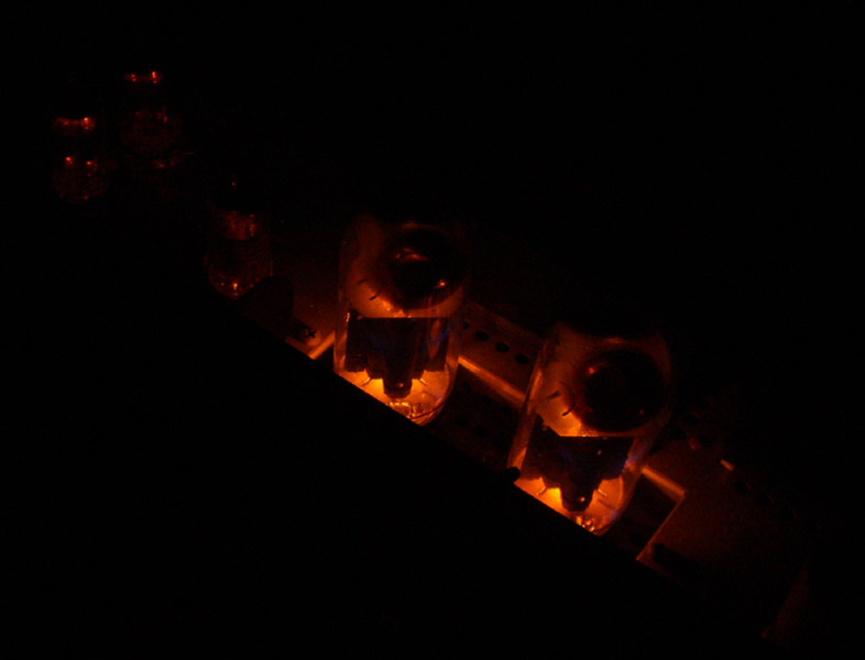

Well, I switched the tubes and fired it back up. To me, they both felt pretty much the same. My method of testing is hardly scientific, basically touch the tubes with two fingers and whichever one stings the worst is hotter, and sometimes one tube felt hotter, and sometimes the other one felt hotter. If I had to say one for sure, it would be the tube that got hot before in the other socket, so I guess that points to more of a tube problem. If one of the tubes was shot, wouldn't there be a fairly large difference though?
What kind of places would be likely to test tubes? The only place around me that I thought there would even be a chance was the local music store, and they don't so I'm out of luck as far as that goes.
