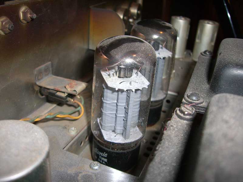

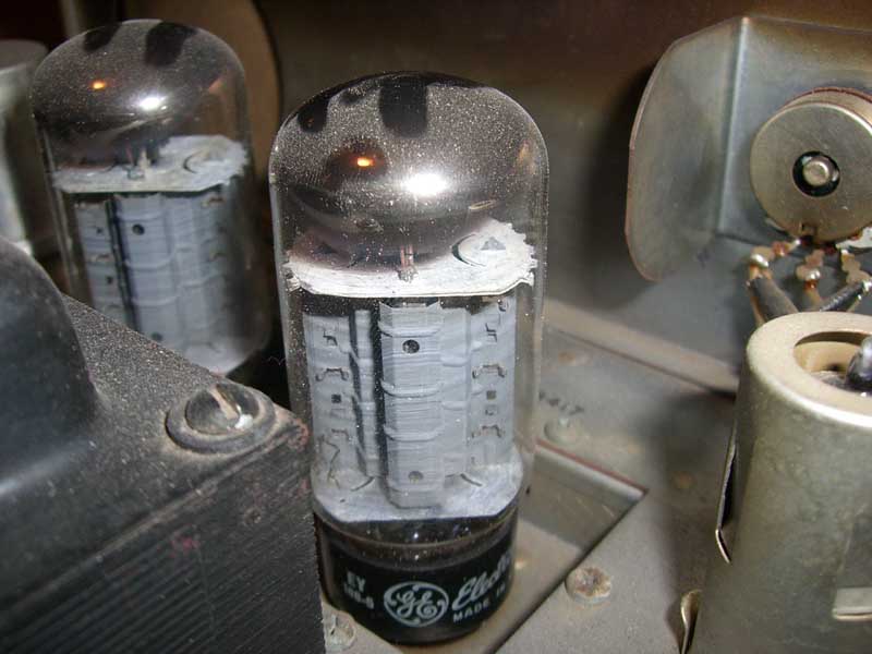

Pics of the GE 8417s. They look to be in good physical shape, haven't tested them yet though.

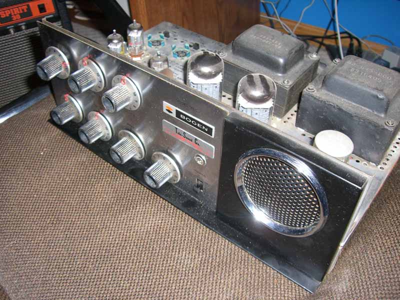

Wow, haven't updated this in a while. It did fire up nicely, I did have a problem to begin with that turned out to be a bad speaker wire (yeah, ran it with no load and it's still fine ) but I've been playing through it for most of the week with the insides still original for now. I ghetto-rigged some conectors to plug in the guitar and speaker cab.
I'm not sure I even want to mod it. I was expecting something that would be pretty clean until I modded it, but the disortion this thing is capable of is insane. I can't really get a clean tone out of it, but I can get pretty nice heavy metal tones without any sort of pedal.
The thing that concerns me is that it seems unnaturally quiet. I'm playing it through a Peavey cab with a 12" and 10", and it's about loud enough for a practice amp in my room, but if I were to take it on stage I would almost certainly have to mic it. I know it can't possibly be putting out the full 60W. Anyone have any ideas?
-Darren
-Darren

Hmm, no I didn't test the output tubes. This thing uses a pair of 8417s that are incredibly rare and expensive, I plan on using this pair until they die altogether. The only thing I really tested before I plugged it in was to make sure there was -17 volts on pin 5. I don't even know where I can get the tubes tested.

Okay, I looked and couldn't seem to find what you are talking about. I'm going to try emailing Bogen to see if I can get a schematic for this thing, I have no idea what I'm doing right now.

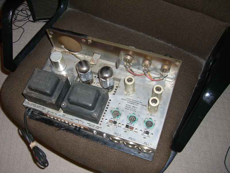

Anyway, here's a shot of the inside.
http://www.teamfc3s.org/forum/attachment.php?s=&postid=514341
Closeup of the output tube sockets, but a little out of focus.
http://www.teamfc3s.org/forum/attachment.php?s=&postid=514342
I can get pictures of anything else. I'm not one to randomly start prodding into high voltage stuff without knowing exactly what I'm looking for, so I'm going to hold off doing anything with it until I get a sense of what to test.
If in fact one of the tubes is bad, will it hurt the amp any to keep playing through it?
-Darren

Those thick black wires are connected to the cathodes. From the picture it looks like they lead to the pot in between the tubes. It appears to be a bias pot of some kind. It's hard to tell from the picture what the pot does exactly. If the amp were on the bench in front of me there are a lot of things I would look at, but if you don't feel comfortable probing around in there, then I don't feel comfortable giving you suggestions here.
