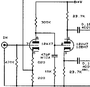

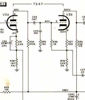

Now for the 2nd iteration of the driver circuit.
Actually it's pretty much the same thing apart from the impedances are different + the bottom input valve doesn't need to be a pentode.
In practice in behaves in a similar fashion at similar voltages/currents & not quite so much "Neve" stuck in there.
The heater differential will also be more like 30V between the 2 valve halves on this one, rather than about 10V on the last one, and that could be an excuse to use the UCL83 instead, although I'm not sure they series wired the heaters in them or parallel.
It DOES matter.
It DOES matter.

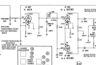

Another variation on a theme.
This one again, with different load impedances, less gain & more triode distortion.
This time the split heaters will see about 7V difference .
Of course it's now using one more valve with some PSR "a la broskie white"...
The majority of the gain will now be confined to the input valve which now has a Mu of 70, instead of the original 12AX7 (100) with all its attendant hum, noise, distortion et al.
This circuit is more similar to the original but with 2 more valves, DC coupling, and considerably better impedance & linearity.

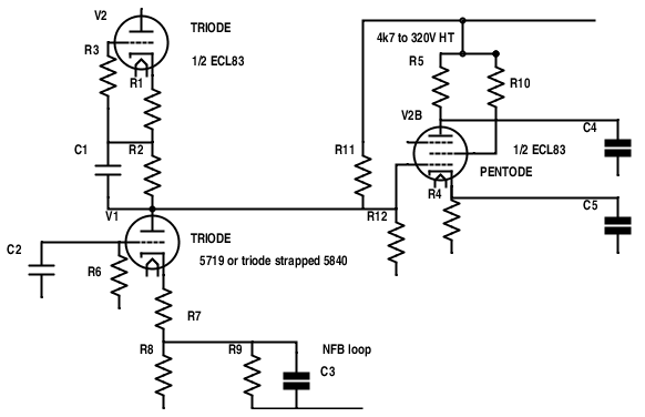

Maybe I didn't make perfectly clear what the object of this exercise was.Which of course is good reason to do something else. LTP of power pentodes
If you notice is exactly what I am doing all in ONE valve, that's exactly the same size as the original 7247, but a quantum leap better, costing no more than 10-20 Euro for the whole conversion.
I reckon the little headphone amps using the ECL83 probably work quite well too,- even better if they were made to run SRPP into 300 ohms.

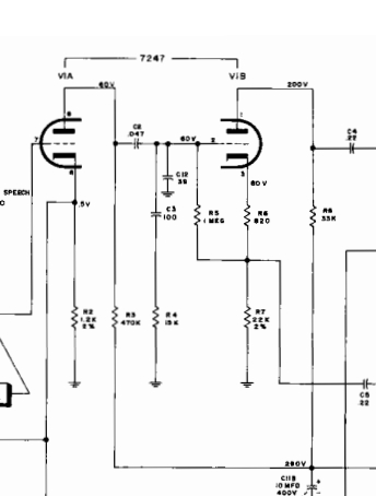

I mean,- you will never get a 12AU7 to conduct 25m/a with 4k7 loads.
The Rp of this triode (EL85?) strapped pentode is 2,4k instead of the original 60k...
The distortion falls by a factor of 4 using this idea, so judging by reports, something of the order of 0.05% THD is a strong likelihood.
The 12AU7 in the original 7247, is struggling to get to Rp of 7k.
Forget anything over 5m/a per section, as our mosfet friend reminded us, and THD is anything from 1.5-4%. No wonder it sounds bad.

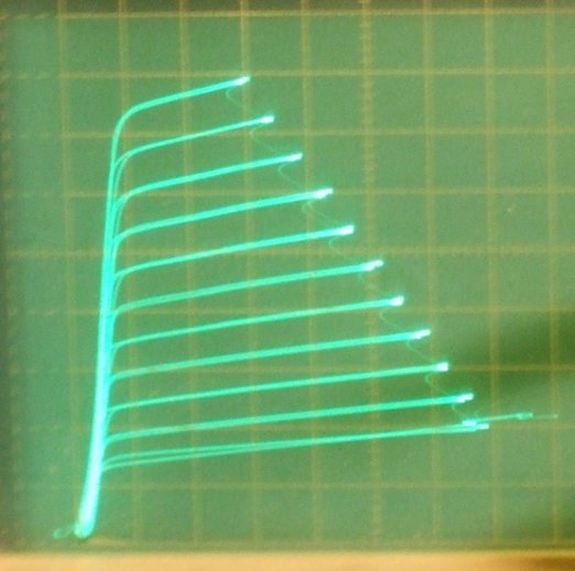

This left a choice of the 6Ж9Г / 6Ж9П which are essentially a E180F....as shown here
Amazingly the little wire ended submin is a version of the SAME THING!

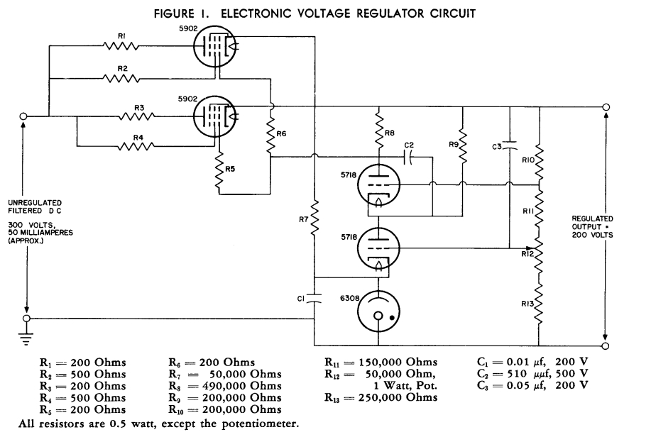

The last bit I wanted to add to this bogen amp is a decent bit of voltage stabilisation, which was sadly lacking originally and drops the 50hz ripple through the floor.
Fortunately the Russians also developed a sub miniature tube shown on the last circuit which is brilliant.
There are 1000s surplus and usually cost about 50cents...the SG5b-V
These devices are pretty much the same as zeners, and not much bigger.
Put 2, in series you can regulate the OP valve screen valves fine (2 x 150 = 300V), so perfect for eg. an 807 screen.
The US equiv is the Sylvania 6308 series at 87v, 5644 for 90V, 5787 which gives 100V, 6213 for 130V but no Sylvania wire ended one for 150v....
The SG5b fills this gap perfectly and the 6p30B delivers a lot more current than the 5902.
Put another small zener in series and you can adjust the thing which ever way you want so long as the steady current draw is between 5-10m/a, otherwise you will need to add a stabiliser valve circuit.
Funnily enough the 6P30b above works beautifully as a series regulator valve also...
Here's the 5902 circuit it can be substituted in:-
What's not to like?

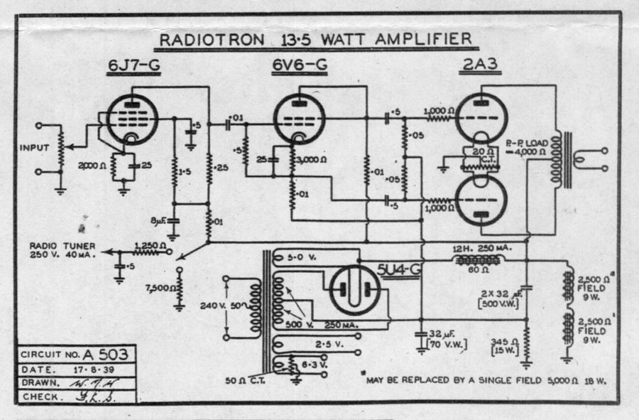

It looks like this could be the last post on here for various reasons:-
I searched to find ANY previous amplifier which ever used a pentode as phase inverter and finally came up with one dating back to August 1939 hosted on Oestex.
This a very good design, with some rather novel ideas.
The original image was way too big, so I reduced it to a readily visible form.
The 6V6 is connected as a power triode, so behave in an extremely similar way to the EL41/85/_L83 based tube proposed, but there, all AC coupled.
The 6J7 is almost exactly a 6J5 triode with an extra grid, so it shows the plan to drive the Bogen 100A amp with an ECL83 in the place of the weak old 12DW7 is very good, and will turn out extremely well.
I made some extra refinements to the circuit by adding a Russian СГ5ь 150V series stabiliser into the sensitive input valve circuit.
That effectively removes all the ripple from there.
This was the source of a lot of the noise and hum as it stands and would even better support full DC coupling.

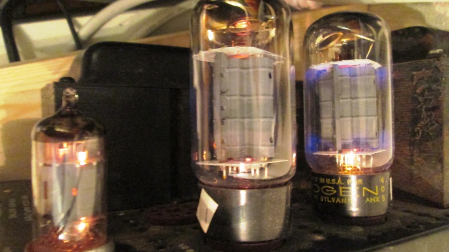

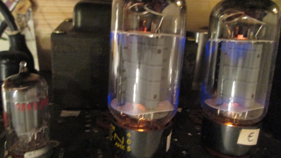

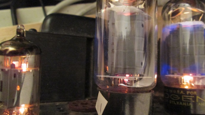

Here it is folks.....OLD versus new:-

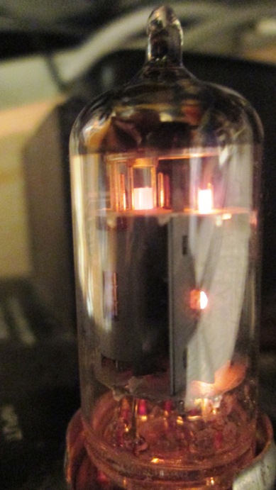

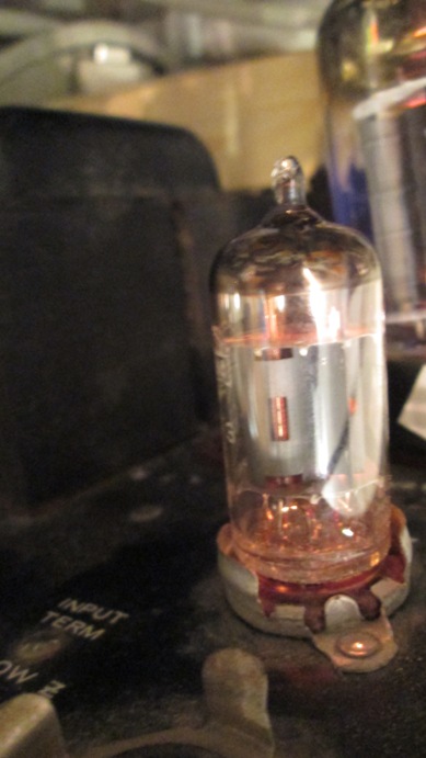

The 7247 driver/ps...
The new driver/ps, they sure glow a fair deal brighter....
In natural unplugged light they don't look so much different...
So here it is...
Compared with the (tweaked) old one
So here it is...

Here are some final figures & some thoughts :-
Factory E*L83 pentode section:- anode impedance at 170V (as pentode 56K, 65k at 200V)
Original Bogen circuit 7247 section 2 anode load 33k, voltage across valve 107V anode impedance, 6k5....
Voltage across it now (Anode 220V, cathode 85V = 135V)
Recommended anode load 6.5-7.5K
Actual load 7k1.
Anode impedance Triode connected 200V 2,4K,
This at 135V is probably 1,8K, - a very low figure for any driver valve.
For ref:- 1/4 of the original circuit, the Va is 25% higher and the Ra load impedance is nearly 5x lower, so this circuit meets 8417 requirements for class AB2.
Va 135V
g1 bias -10V.
Rg1-k 470k.
Ig2 1.6 m/a
Ia 10 m/a (Original 7247-[12AU7] Ia 3.2m/a, voltage across valve 107V, Mu20)
Mu 9.4
Power dissipation in "L" section 1.6W (quite hot to touch, original 0.34W)
This means the external screening has to be removed, or it will get too hot, but it turns out this valve doesn't need anyway. On the original circuit the 7247 without an external screen was much noisier with a lot of PS hum & noise at full volume.
NEW Insertion loss 0.9 AC (input 25VRMS, output 22.5V RMS)
Original phase splitter AC drive insertion loss 0.6 (input 25V output 15V....), which is why it was being driven into distortion in both the preamp stage and phase splitter stage leading to heavy inbalance at high signal levels.
EC*83 Triode section input stage.
Va 210V (original Bogen design 60V was increased to 135V)
Ia 1.4m/a (original Bogen design 425uA)
Anode dissipation 300mW (originally 20mW changed to 120mW)
Anode impedance 33k (original 7247 80k)
Mu 85 (original 7247,section 1 = 100)
Gain 50 (input 500mv output 25V)
Vk 1.82V (originally 0.5V)
Rk 1k2
Coupling capacitor 0.047uf (unchanged -3dB at 7hz)
Output circuit.
Original output coupling capacitor 0.22Uf into 22k gives -3dB at 33hz.
NEW coupling capacitor 0.47Uf " -3dB at 15hz
Va 8417 660V.
Bias -17.5V
Transconductance 23ma/V. (eg. 6L6, 6ma/V)
Drive requirements of 2 x 8417 valve in AB1 class original amplifier 29V (110W)
Drive requirements of 8417 in AB2 class (Grid current >1.5m/a) 39V (135W)
Voltage drop over G1 resistor 1V.
Maximum grid drive to 8417, +4V positive.
Actual load 7k1.

Looks like 2 x 6HB5 or 21JV6/21HB5 TV Sweep tubes in parallel would give an equivalent (same gm and Watts) to the 8417, except g2 screen voltage would need to be 150 V instead of 300V. (21JV6 $3 each)
Have to agree on the absurdity of converting the Bogens to KT88 etc.
The 8417 datasheet plate curves look awful, I assume there are some errors in the graphing (300V g2).
21HB5 etc. look MUCH better. Although, clearly more 2nd harmonic.
http://frank.pocnet.net/sheets/123/6/6HB5.pdf
http://frank.pocnet.net/sheets/168/8/8417.pdf
Screen grid drive for the 6HB5 though is fabulous:

Then the Bogen design had an outright biasing error issue in the 7247 stages that caused it to "pulse" at high power levels. Apparently never corrected, since the same problem occurs in other Bogen models.
It may have been a bargain, but you have NO choice but to re-design the Bogen amp. Using Edcor OTs and sweep tubes can get one in the same price range if some ingenuity is used for the power supply xfmr (industrial conversion xfmr or Ebay stuff) With $5 sweep tubes, one can afford to fill the closet with spares.
Actually if you read the whole long thread,there were reasons for the poor bandwidth that were a plus for PA use,The thread goes on to give schematics and distortions of both the 8417, and 6550 conversions to a good audio amplifier that would rival many.The output transformer is actually pretty good when used with the proper taps.
