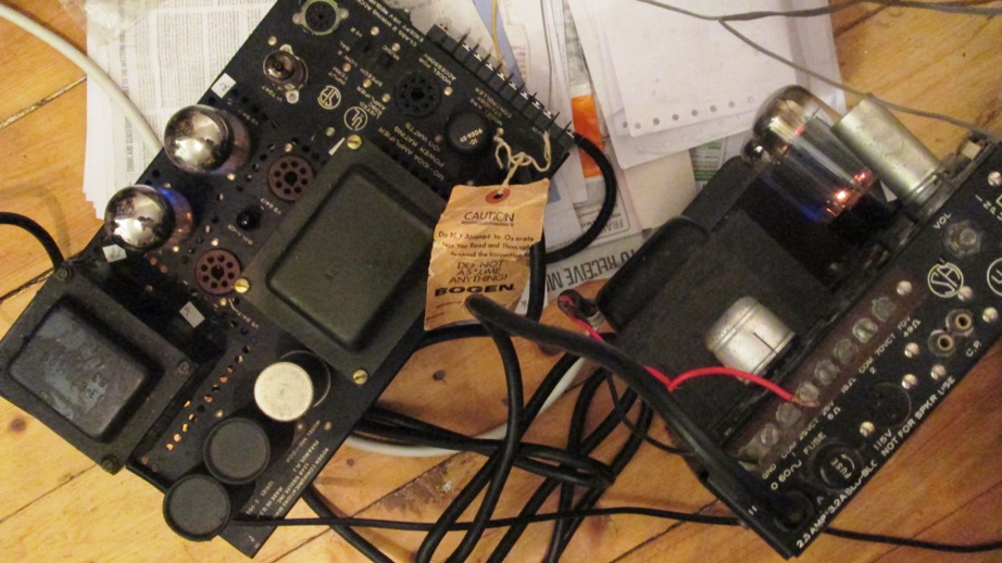

1:-I would say these tubes were specially developed for Bogen so that a cheap amplifier could be made with a wimpy driver. The poor power supply regulation for the screen and bias voltages in the Bogen amp cause the distortion to go out of control at high power. 6%
2:-The low bias currents in the Bogen amp caused crossover distortion, and the bias adjustment range won't allow fixing that.
3:-Then the Bogen design had an outright biasing error issue in the 7247 stages that caused it to "pulse" at high power levels.
Any more complete nonsense to add here?
FYI The 8417 was really originally designed for a portable HF amplifier and/or sweep tube app, nothing whatsoever to do with Bogen, who are (still) just another OEM.
It make a very good transmitter valve as does the 807 which also has to have very careful g2 regulation.
If you like, it's like an 807 "on steroids, 4x the gain needing much less demanding drive requirements but with no top cap or UX base to mess with.
The 807 as we all know well makes an excellent amplifier valve, but with the proviso the G2 is regulated carefully and dissipation not exceeded.
From what I heard, the Quicksilver (8417) amp which is nigh on a clone of the Bogen, is highly regarded and very sought after.
I simply don't get any of the other things you are somehow saying (?based on hearsay?), especially once the input stage & driver and taken to a decent current condition.
Poor regulation?
What on earth are you on about?
This amp already has solid state rectification from the mid 60s.
My measurements suggest neither any weakness in the power transformer nor the 300v regulation line at all.
Perhaps you don't know, likely you are guessing or are just making it up as you go along?🙄
I read the long AudioKarma thread, guess you didn't.

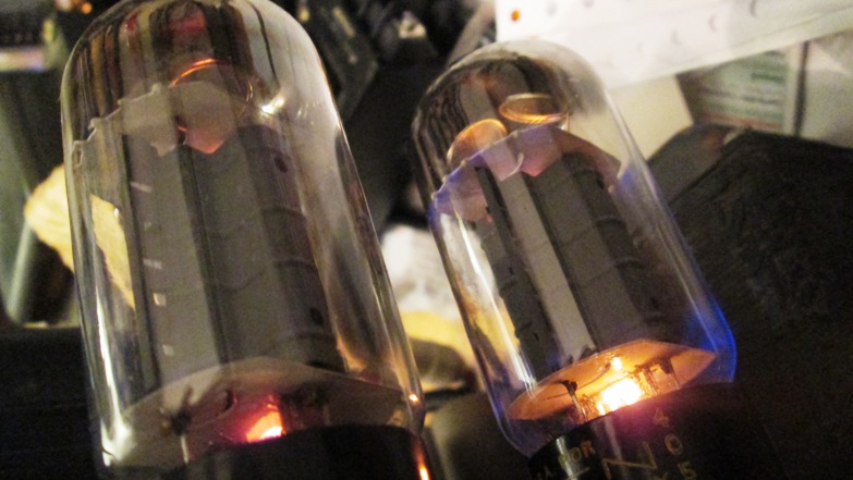

Having done this mod, I will definitely use it again to rework the pair of Bogen DB units which are coming next week chock full of 6V6.
We know the originals sound beautiful anyway, so the mods described (such as going to solid state rectif + making the driver & Voltage amplifier stages more rugged) will just make them even better with a wider bandwidth, less noise and lower distortion.
In this case I'll almost certainly drive the output pentodes with a triode connected 5902 (submin).

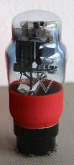

I bought some 8417's many years ago; as they appeared to have so many advantages and so easy to drive but they are so unreliable. Most of my stock is gassed; yet I have lots of 807's from the Second war that show no sign of Gas. I would think it would be hard to find any that are any good. Used or unused . The 8417 is a Good design but the manufacture was very bad..
Phil
Phil
The original ones in the amp are perfect, except for one slightly weaker one.I bought some 8417's many years ago; as they appeared to have so many advantages and so easy to drive but they are so unreliable.

So I can believe Sylvania got it right, while RCA apparently not.

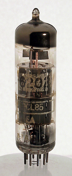

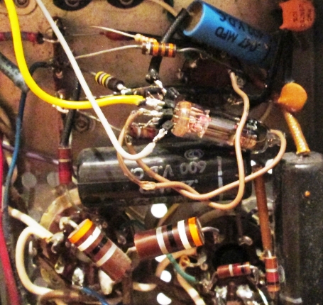

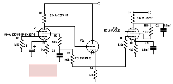

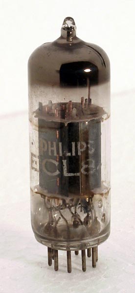

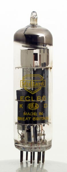

The main object of the project was to locate the weak point in the amplifier causing distortion and limited bandwidth.
This was NOT the output stage at all, it was the drivers.
Using a really horrible budget triode pentode but in the RIGHT way, to give very low distortion, wide bandwidth and extremely low noise, (the ECL series were always though of as really yuck hi distortion budget audio valves), to obtain a silken purse from a sow's ear, was the fun part. 😀
