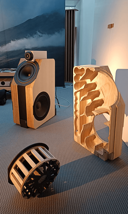

Orginally w22 had no woofers. It was 2way with two tweeters, one facing back.
And vented. The funky scroll work inside forms 4 pipes of (looks like) slightly different lengths. I wonder if this is the Hegeman thing which we now see in things like the KEF meta tweeters.

Now it has two 15" woofer

Re the W22, the opicture of V1 with no woofers seems to be teh same, same volume, as the one with 2 x 15”. I doubt the box is big enuff and the DSP is there to fix that, and i suspect that the ionfluence of the large bass drivers on the midBass will not be a positive thing.

Accoya or Mahogany solid-wood enclosure with custom-made side panels on proprietary Swing Base flotation; custom AER tweeter of high 101dB/2.83V/m sensitivity with ultra-linear cone, powder-coated bell-bronze curved baffle, friction-free suspension, paper voice coil former, special aluminium-alloy voice coil wire, double C37 lacquered carbon membrane, bell-bronze phase plug, Harmonix RF 5700 on magnet; Audax rear tweeter; custom 28.5cm Overconductor mid/woofer with bell-bronze phase plug, C37 lacquered cellulose diaphragm, paper voice-coil former, aluminium voice coil both C37 lacquered; no electrical crossover on widebander; proprietary suspension mechanism for the mid / woofer and tweeter; proprietary linearization network for acoustical phase; 600W Class D module with programmable DSP for active bass amplification; twin 15-inch long-throw woofers in sealed enclosure delayed by extra samples to phase-correct minor DSP latency, Lessloss, Furutech, Deulund..
