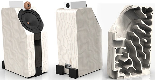

Open back as in no sealed rear cover on the 8", ergo the woofer modulates it, so fundamentally the same as the W22.
It appears to be an elegant acoustic solution to an acoustic problem, i.e. acoustic XO.
Elegant??? It is certainly interesting to see how the company goes about differentiating themselves and building high value in the eyes of a small number of enthusiasts. Good luck to them. I would suggest though that they may not be a wise place to look for guidance on addressing issues of an engineering rather than marketing nature.
Basically an awful waste of material, elegantly dished up to impress the potential buyer. In order not to raise my blood pressure & stay relaxed, I will not read the Boenicke lecture about their-latest?- contraption. My guess is this will be an 8K or so thingie. Andy19191 sums it all up in has last sentence.
Definitely not. In the video posted above, author boenicke himself describe woofer being actively powered by built in plate amp.
Orginally w22 had no woofers. It was 2way with two tweeters, one facing back.

The bass driver is definitely not isolated from the mid but with the labyrinth in theory they try to avoid some issues, especially using class d DSP amps for the woofer is good for surpressing some unwanted stuff in the frequency response 😉
Regarding the "poor" midrange - we are not talking about a small chassis, it appears to me more like a full range speaker often used by Boenecke.
If I'm guessing right from my first coffee in the morning, these types are mechanically stronger build and won't be affected as much as a simple soft dedicated midrange - please correct me here!
The best solution would be of course two chambers but I guess the housing would increase by alot according to what is done here.
The full range driver needs volume to play deep enough without constraints and the bass surely too.
By separating both drivers you need nearly twice the volume - if necessary according to tap and so on.
Just my 2ct!
Just my 2ct!

My own comment needs some type of correction, full rangers are not by default build stronger surely depending about what size we are talking.
What could make a difference in the end is beside the labyrinth structure the amount of stuffing.
If this thing heavy damped in the woofer section that could reduce the infliction of both systems.
For this type of housing and discussion we need a 3d plot for the air pressure inside to see what really ends at the midrange and how hard/soft the impact would be.
Talking about unicorns - just to be funny - maybe it's engineered to use the midrange as a PR ;D

The excursion that is pneumatically enforced on the mid by the woofers does probably lead to euphonic distortion. 😉

well i do not want to talk about there marketing fluff i've seen a few alineas where i wonder if they where talking about loudspeakers or something that has to do with light.. photons etc... anyhow, yeah in a nutshell i only wondered if the midrange would see to much pressure from these 2 15 inch beasts.
since my idea was you normally combine 2 drivers when they both are the same and play down to the same frequency. then most mids i seen have there own little cabinet.
The engineering in strongly audiophile brands like Boenicke is there to serve the marketing stories that can add high value for a small number of nontechnical audiophiles that respond positively to them. If it improves or worsens technical performance a modest amount is largely irrelevant (a lot wouldn't be) it is how well it serves the perception of the product by potential customers that matters. This is quite different to the engineering in speakers like Genelec, Neumann and such where technical performance is important to adding value in the eyes of their customers.
The woofer moving the cone of a mid in-and-out would be unacceptable in a high technical performance speaker but, if not excessive, would likely be fine in a strongly audiophile speaker like a Boenicke if it served a marketing purpose. I am not familiar with the marketing to know what that might be.
