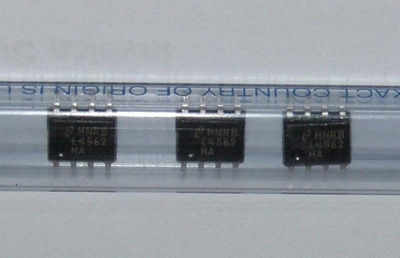

first SMD mod ever!
Hi all 🙂
I successfuly made my first SMD swap 😎
I replaced output opamp of a cheap Samsung multiformat player that I'm playing with.
As I lack other gear to practice with, I trained myself desoldering the opamps for the 5.1outs of the same player 😀
I even develloped my own, non-destructive (I hope) method 😎
It consist of using a 5-6mm, 20AWG copper wire, pre-covered with soldering, installed across the opamp tinny legs (1-4 or 5-8, you know what I mean...). Then applying a little amount of heat and solder to get all the opamp's leads hot at the same time. Then gently lifting upwards the unit with a thin lever. Repete the same with the other side legs 😉
It allways works. PCB is intact!
I tried to measure Tº, perhaps not fast enough. The surface of the opamps never passed from 42ºC.
Actually, as someone said before, it is easier than desoldering regular devices.
Now, soldering SMD is a little more difficult.
Now that I feel brave I will upgrade my UCD's.
Maybe time to a GB, as Tubee wanted
Ah!...the sound...I am still hoping for improvement but it sounds way better than the humble JRC4560? that the unit used (the DVD has some Sony and Burr-Brown digital chips that seem quite good). First thing apparent is much less HF noise; cleaner, softer and more detailed sound. HF is extended but not aggressive. Bass is deeper (strangelly the stock DVDP has very respectable bass depth) and better articulated. Midrange is also much detailed but I find it still a little thin for my taste. Maybe all OS dacs sound like this
Anyway, the cheap Samsung P650K (?) after a few basic mods, now sounds very honest and gives space to play with clock and further caps/PS changes.

Three sample LM4562NA units arrived by UPS today and I replaced the OPA2604 in a headphone amplifier. The difference is very audible; it will take a while before I buy Op-Amps from TI again!
