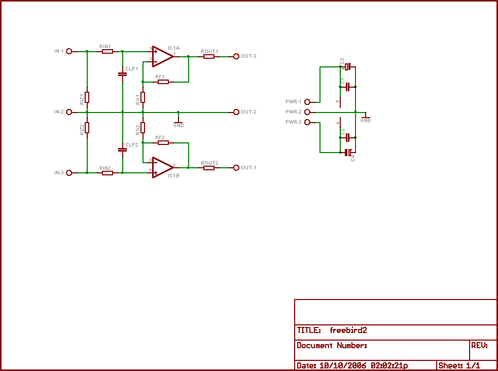

Here is the circuit/layout I am using for some tests. It is all SMD. I would be happy to provide a DIP version with through hole parts if people want it.
Cheers!
Russ
thanks, can you share the circuit? what value of pot are you using?
schematic
Here is the circuit.
I actually use a logarithmic attenuator (Joshua Tree) on input, but you could use just about any pot depending on what you use for RIZ. For 100K I would use 10-20K pot.
:EDIT:
Also note that for ROUT I have been using just a jumper. For a capacitive load I would use 10-220R. Try to go as low as possible.
:EDIT:
