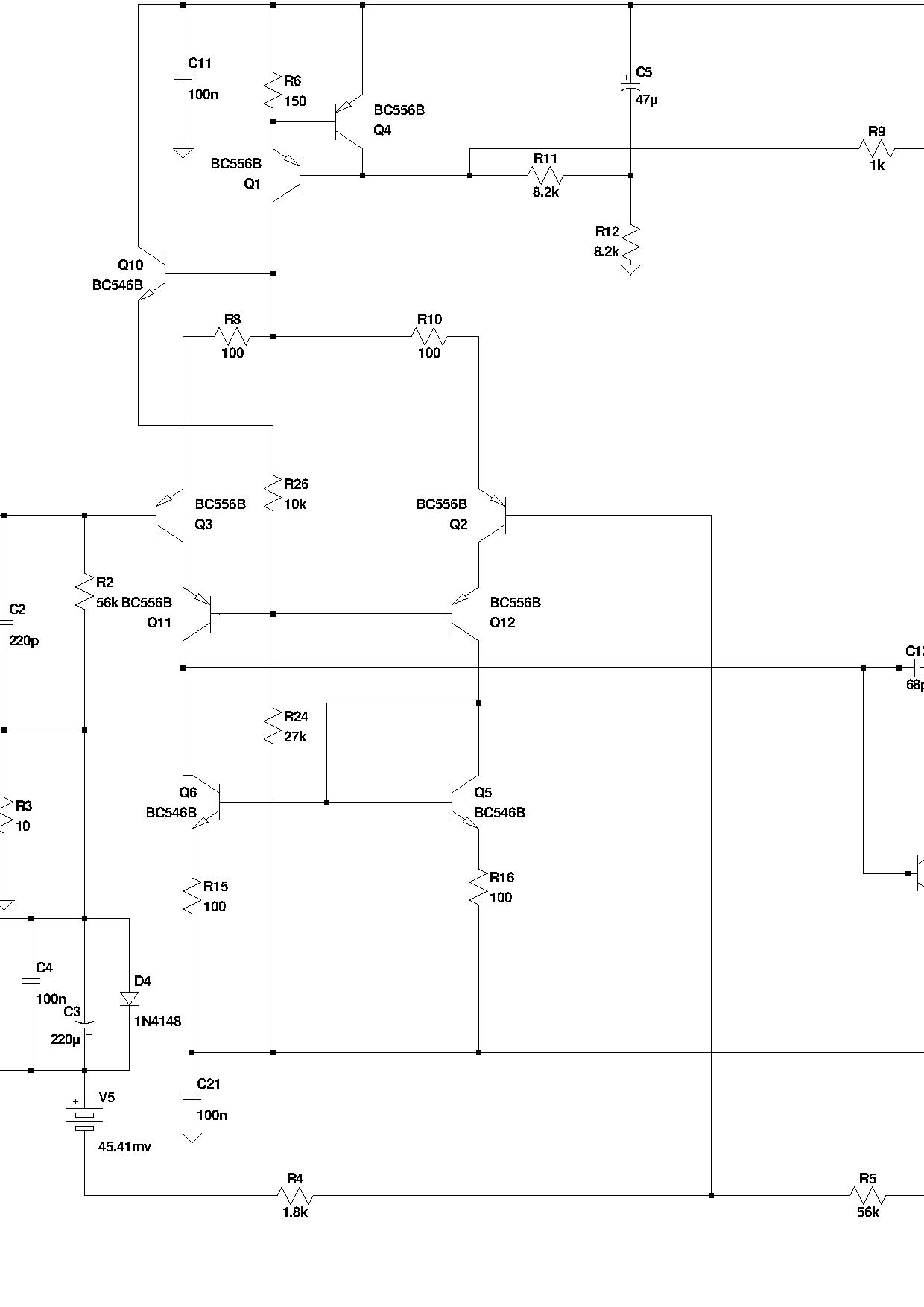

Off-course, anyone is free to comment on the clamps, but on the whole circuit too !!!
For now simulation shows 1.6ppm THD20 at full swing - not loaded (only vas & ips, no ops!).

I am aware of the relativity of THD figures, especially if it is w/o OPS. Maybe a bit surprisingly, I am not specificaly searching for THD world records, far from it. So why the the complexity? Well because I like the Mirror Image topologies with current mirror loaded LTP's combined with a Cascoded darlington VAS. Off-course there is the VAS Iq issue, and I see it as a challenge to solve it (even if I have not invented the solution for it - my capacities are too limited for that). As a matter of fact I started out with this circuit reading Randy Slone's book. I lost much time with, but I learned a lot of things while burning down too many transistors... So I have a strong will to make it work...
My concern for the moment are thos clamp diodes in the VAS and in the IPS. I have seen so many different options ... is this a good one?

Hi Bob,
Thank you for your comments.
I wanted to keep drain - source valtage constant. Luxman amp did it simple with resistor devider. Roender is using something similar in his one stage amp.
I don't understand what you mean by using emitter follower. How to connect it to feedback signal? If you could put some diagram here, as I did not find, how to best bias a cascode, in your book.
C7 is suggested by Samuel Groner in his comment on D.Self. It enhace slew rate. And indeed in my simulation it increased dow slope from cca 70V/us to cca 90V/us. http://www.diyaudio.com/forums/soli...r-amplifier-design-handbook-douglas-self.html
R42 is used to adjust the bias. I used your suggestion for ThermalTrak from the tread http://www.diyaudio.com/forums/soli...n-thermal-trak-transistors-2.html#post1265193
I included a new LTSpice with simpler cascode bias, TTP tail current of 6mA.
Damir
Hi Damir,
I guess the use of C7 is a way of getting the VAS to act in a push-pull sort of way at HF without going to the trouble of a complementary VAS and complementary VAS drive arrangement. It may increase the slew rate, but I just would not go there. Whether it increases slew rate depends on where the slew rate limitation in the amplifier without C7 is occurring.
The emitter follower I was mentioning would have its base connected to the tail of the LTP and its emitter would be used to drive the common mode signal to the bases of the cascode. This buffers the tail from having to be loaded and to have the extra bias current injected.

Hi Bob,
I hope I understand how to do that. Something like this?

Hi Bob,
Reading about Bakerclamps in your book I implemented some in the joined circuit. Are these well placed?
For information : OPS is still not implemented nor is the bias circuit.

Hi Olivier,
You've got a lot going on in this circuit. It looks like you are using clamp diodes that effectively feed back from the output of the VAS to the input of the VAS to keep the VAS out of saturation. This is not the usual use of Baker clamps in a power amplifier. The usual approach is much simpler, and was used, for example, in Tom Holman's APT-1. The clamp diodes go from the output of the VAS to a fixed voltage reference, preventing the VAS output from going more than a diode drop beyond the reference. The arrangement assumes a current-limited VAS.

Hi Bob,
regards Damir
Hi Damir,
Yes, but you may want to replace R26 with a zener diode. As shown, it looks like there will be attenuation of the common-mode signal before it reaches the bases of the cascodes.
