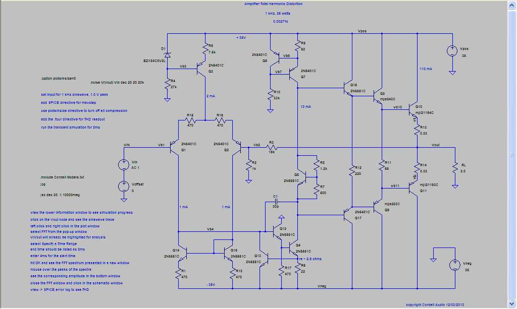

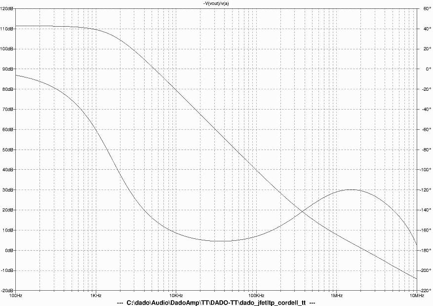

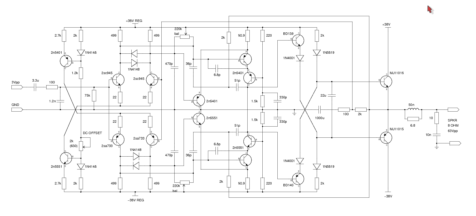

not Bob, but I can run a sim, have read a little about amp design...
rather odd choice of bias current - I would expect with the VAS ~10 mA the buffer/pre-driver of the triple to be at least several times higher than that - you have ~2 mA there - little wonder you see no improvement with the triple!
R24 I expect does nothing - at 330K and connected to 1K that is bootstrapped to ~90% of its V I don't see how it can have much effect - in AC gnded 2-pole it would put a limit on low frequency loop gain if the Q parasitics didn't limit it 1st
random comment:
R18 collector R gives some Miller multiplication and should be Zener or C shunted/bypassed if you need the V drop or current limit
random comment:
random comment:

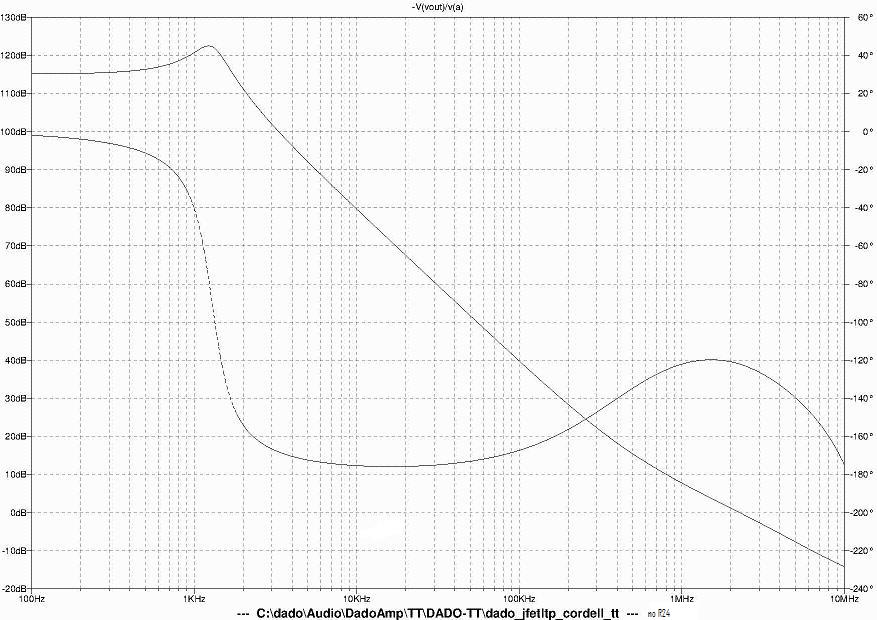

Thank you jcx for your coment.
You say that it odd choice of bias current. The less predriver load on VAS is better, isn't it?
Triple I used was suggested by Bob in Thermaltrak tread and I changed it a little.
Regarding R18 it is for beta enhancemet BJT protection. It happens that in some transient condition Q7 could be burned. Haw you will do that? Can you show a diagram?
R24 makes OLG looks better, no 8dB bump on amplitude graph and phase is a bit better.
I appreciate your help here.
I will try to change the currents in predriver and see if it helps.
Graphs are without and with R24.

Hi Bob,
I received your book today, and I am starting to read and enjoy it.
You did not coment on the TRIPLET with TT tranistors I presented in #1506 and #1509.
I understand that you do not have time to look in every qustion, but I still hoped.
Now I have to find all answers from the book.
Damir

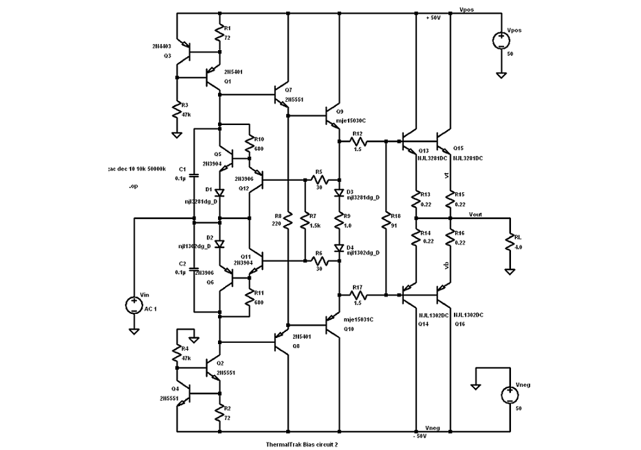

Hi Damir,
I apologize for not getting back to you on that amplifier circuit. You've got a lot going on there.
I normally recommend caution in regard to the type of circuit you are using to bootstrap the input cascodes; I'm not crazy about injecting extra current into the LTP tail circuit. I might have used an emitter follower into whose emitter I would have flowed that current. I prefer the driven cascode that is driven by a replica of the feedback signal, which, under normal conditions, is pretty much the same as the common mode signal.
Your capacitor C7 is curious, and could seem to create a noisy VAS bias current, since C7 straddles the power rails.
The ThermalTrak biasing circuit is interesting and requires some thought, but how do you adjust the bias? Am I missing something here?
Bob

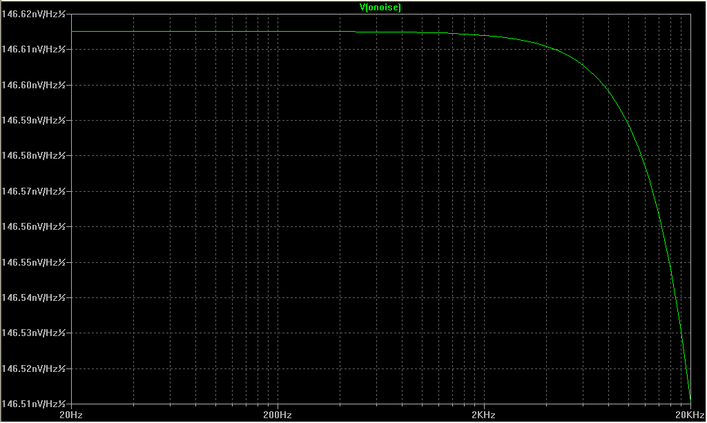

Hi Bob,
I saw this from you in the Douglas Self thread:
I must be doing something wrong, using your models and noise example I get the following for your Figure 3.10. Help!
For example, the feedback network shunt resistor is often the biggest contributor if the feedback network resistance values are not kept very low (500 ohms or less). Also, any power amplifier whose input-referred noise is less than about 10 nV/rt Hz is already quite exceptional in the noise department given the line level signals present at the input. In my amplifier of my book Figure 3.8, input-referred noise using a 200 ohm NFB network is 6.5 nV/rt Hz using 470 ohm current mirror degeneration resistors and drops to 5.7 nV/rt Hz using 1k current mirror degeneration resistors. Nevertheless, if one can pick up a couple of dB by just a modest increase in the current mirror degeneration resistors that is a good thing.
Bob

Hi Bob,
Thank you for your comments.
I wanted to keep drain - source valtage constant. Luxman amp did it simple with resistor devider. Roender is using something similar in his one stage amp.
I don't understand what you mean by using emitter follower. How to connect it to feedback signal? If you could put some diagram here, as I did not find, how to best bias a cascode, in your book.
C7 is suggested by Samuel Groner in his comment on D.Self. It enhace slew rate. And indeed in my simulation it increased dow slope from cca 70V/us to cca 90V/us. http://www.diyaudio.com/forums/soli...r-amplifier-design-handbook-douglas-self.html
R42 is used to adjust the bias. I used your suggestion for ThermalTrak from the tread http://www.diyaudio.com/forums/soli...n-thermal-trak-transistors-2.html#post1265193
I included a new LTSpice with simpler cascode bias, TTP tail current of 6mA.
Damir

Hi klewis,
You are seeing about 147 nV/rt Hz at the output of the amplifier. You must refer it to the input by dividing that number by the closed-loop gain, which is about 20, yielding about 7 nV/rt Hz.
Bob

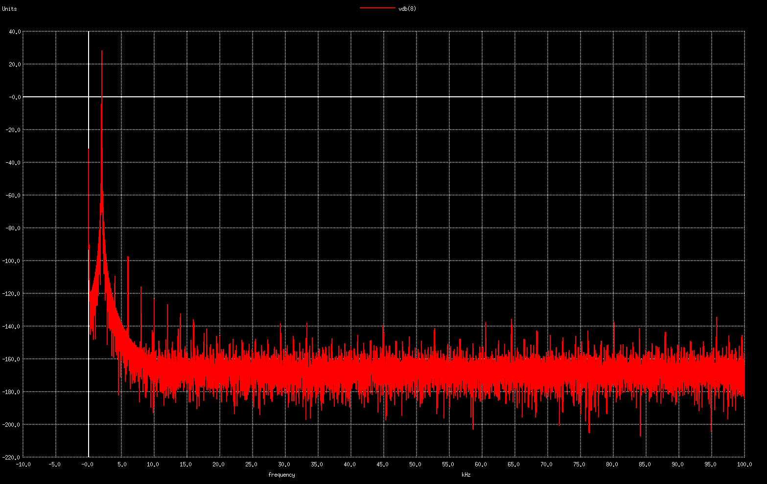

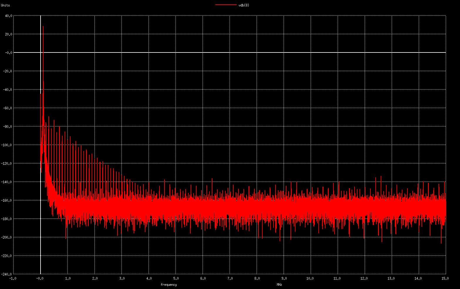

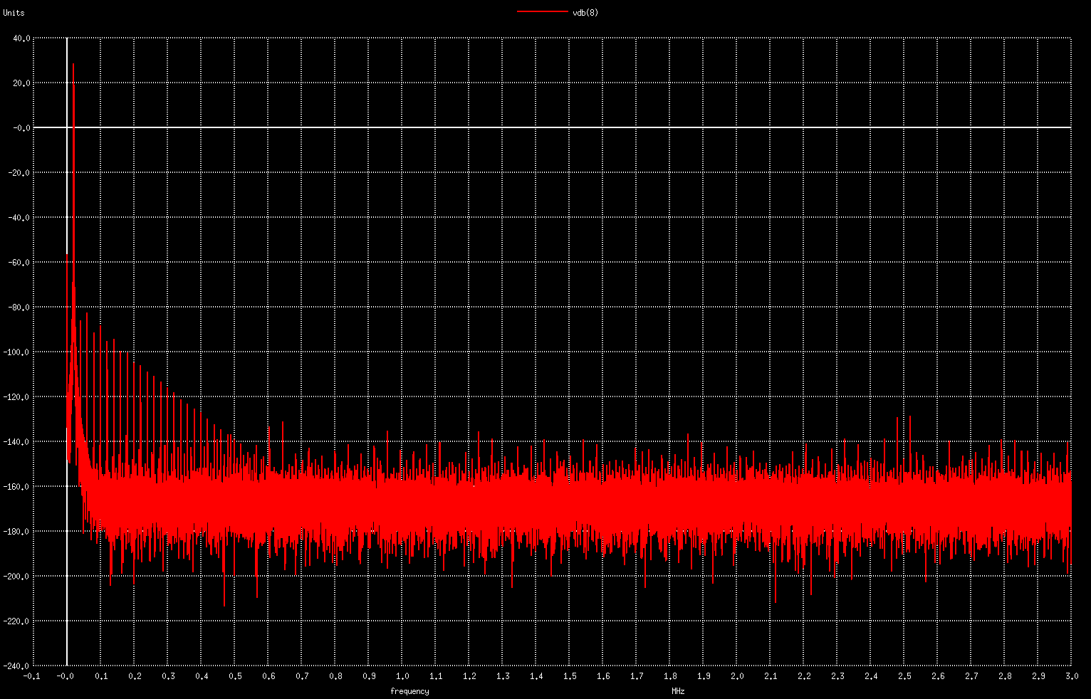

Carlos raised the following question over on Samuel Groner's thread concerning comments about Doug Self's book:
This is an old question and touches on numerous mis-understandings and paradoxes. I have touched on some of this in my book.
This question is also related to the question: why do some amplifiers that measure well on the test bench sound not so good?
The short answer is that extremely low distortion, as measured by conventional lab techniques like THD+N, is neither necessary nor sufficient to create an amplifier with very good sound quality as perceived by the listener.
That statement from a guy like me should get your attention.
First paradox: else why do some tube amplifiers sound very good? Their distortion taken as a lump is larger, but the nature of the distortion may be different; e.g., lower order.
The first question is whether we are talking about 1 kHz THD or 20 kHz THD? The former is nearly worthless as a measure, and is relatively easy to achieve in even a relatively crappy amplifier.
Assuming it is 20 kHz THD, over what measurement bandwidth are we measuring it, and are we taking into account the greater importance of higher harmonics? The same THD composed of only seconds and thirds will sound much more benign than the same distortion amount with significant energy at high harmonics out to the 5th, 7th, 9th etc.
Recognize that the badness of distortion we hear is usually the intermodulation products, not the harmonics. This destroys the argument that some make that we cannot hear harmonics above 20 kHz.
Recognize that distortion like 20 kHz THD is a symptom of a lack of linearity, and linearity is what we seek, including in the open loop.
Comparing amplifier distortion to loudspeaker distortion is rather meaningless, since speaker distortion is more of a soft, more benign nature, mostly low-order. Moreover, louspeakers that are 2-way and 3-way have crossovers that tend to prevent the formation of some of the IM products.

Hi klewis,
Bob
Bob,
Well, that explains it! 😛
Ken
BAKER CLAMPS
Hi Bob,
Reading about Bakerclamps in your book I implemented some in the joined circuit. Are these well placed?
For information : OPS is still not implemented nor is the bias circuit.
Off-course, anyone is free to comment on the clamps, but on the whole circuit too !!!
For now simulation shows 1.6ppm THD20 at full swing - not loaded (only vas & ips, no ops!).
Olivier

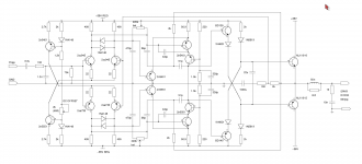

Hi Bob,
Olivier
fft profiles
Hi Bob,
abusing of your attention ... and apropos of this insightful discussion about NFB.
What do you think about these FFT's profiles? It is a 62W (8 OHM) Class AB amp, Gain=21, output quiescent current of 500ma, 70° PM, 165V/usec slew ... note the exponential monotonic harmonic fade out. The FFT's are at 30W output power pix 1: 100KHZ, pix2: 20KHZ and pix3: 2KHZ . It is the final design of the prototype I plan to build.
Cheers
Arturo
