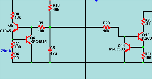

VAS Current limiter
Hi Bob,
I incorporated the classic VAS Iq limiter. The base-emitter of the protection Q stands across the VAS Q (not the cascode Q but the amplifying Q). The collector of the protection Q goes back to the base of the beta enhancer Q. Nothing special here.
However I would like to have a led lighting up when the circuit goes into protection. How can this be done? It should not interfere with the signal nor with the protection function itself and it should be quite binary, I mean led on when protection is on and vice versa ... Reducing in betweens as much as possible ...
cheers,
Olivier

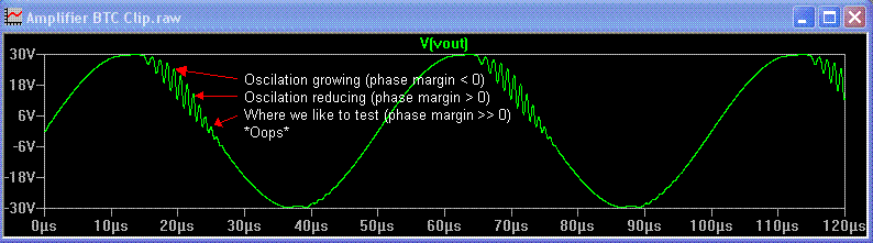

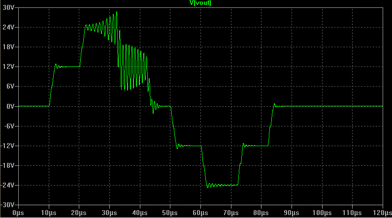

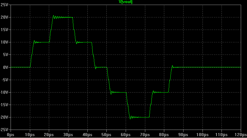

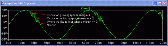

Hi BobThe stability of power amplifiers can be rather different in different operating regions...
I can't tell you how many times I've seen amplifiers break out into a burst of oscillation on the falling slope at high amplitude of a sinewave just under clipping...
You gave a perfect example of this back here:
I was surprised by how bad the ringing was with TPC and decided to do a little investigation. My starting assumption was that reduced phase margin will increase the tendency to ring, but that you still have to kick a thing to make it ring. E.g. Rail sticking during clipping will give the circuit a nice kick when it "unsticks", and could initiate nasty ringing.I've done some more simulations on CMC, TPC and TMC and have attached a zipped folder of three simulations ...
It is easy to see that both TPC and TMC do not recover from clipping as well as CMC. However, TPC is much worse than TMC...
So my first step was to modify the VAS to get inherently clean, fast, symmetrical clipping. This resulted in a big improvement, but there was still visible ringing, and it was still much worse on the positive half.
That made me curious about whether the phase margin was varying with output level, so I tried a quick test with a staircase waveform. The first run showed the ringing getting slightly worse at higher levels, but about the same on both sides. Increasing the output level a bit revealed the problem, though.
When the NPN output device is conducting more than about 5.5A, the amp is totally unstable. Testing with various loads and output levels seemed to confirm that. Adding an extra pair of output devices fixed the problem (although it would probably still have problems above 10A, I didn't bother testing further.)
This was quite an eye-opener for me. I have thought it a good idea to operate output devices "below the knee" for other reasons (e.g. distortion), but it never occurred to me before that it might be important for stability too. It also served as a gentle reminder that checking bode plots under quiescent conditions doesn't even begin to tell the whole story.
Cheers - Godfrey
By the way, is there a possibility to make ion LTSpice AC analysis at various level? It seems changing the AC voltage doesn't change anything while I may observe that stability is level dependant.
AC analysis is by definition carried out at infinitesimal AC level. To vary operating point add DC voltage sources in the feedback path (shifts output voltage) or DC current sources from the output to ground (shifts output current).
Samuel
Samuel

Hi Olivier,
If I understand you correctly, you are talking in the context of a single-ended VAS that is loaded with a current source (correct me if I am wrong, and what I say might apply to certain complementary VAS stages anyway). If you are in te context of the single-ended VAS, the LED will only light when the amplifier is clipping in one direction (trying to turn the VAS Q on too hard).
The challenge in illuminating an LED when this classic VAS current limiting scheme is used is that it appears you have only one Vbe plus the VAS emitter resistor drop to work with when the circuit is protecting. One approach might be to use a matched differential pair of transistors for the protection transistor and make it part of a current duplicator, where the added transistor is arranged to conduct approximately the same current as the protection transistor. Maybe put a little bit of degeneration in each emitter of the pair, but no so much that it interferes with the protection action. Also, you might want each of the pair of transistors to have their base go the the VAS emitter through a 100 ohm resistor to make life safe for each of the pair of transistors and to prevent the added transistor from dragging down the base of the protection transistor if the added transistor saturates. Use the current flowing in the collector of the added transistor to light the LED. Just thinking out loud here.
Bob

Wow! It seems so obvious now you point it out!AC analysis is by definition carried out at infinitesimal AC level. To vary operating point add DC voltage sources in the feedback path (shifts output voltage) or DC current sources from the output to ground (shifts output current).
Samuel
thank you for the tips, I will now step a param for output voltage to check that!
