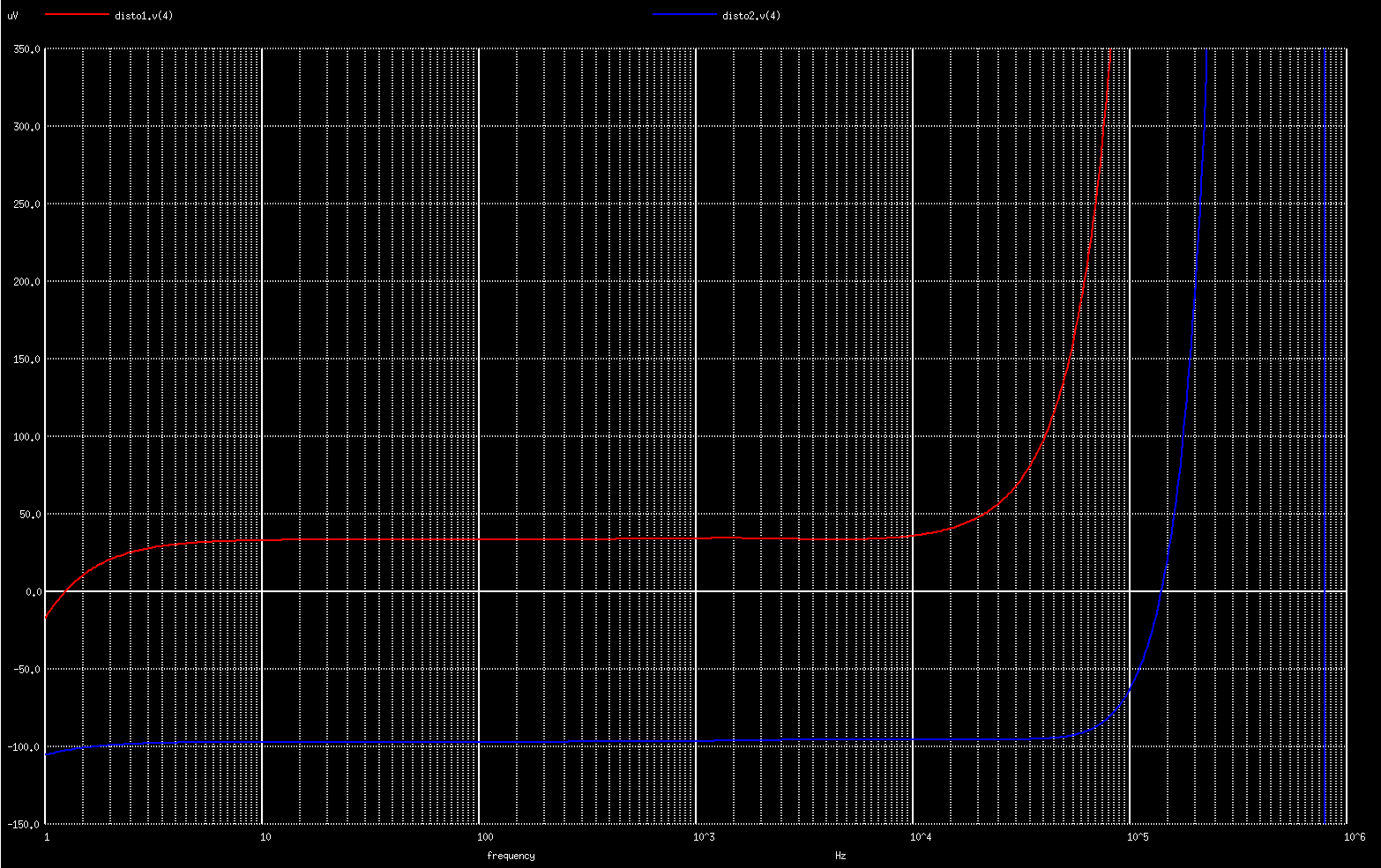

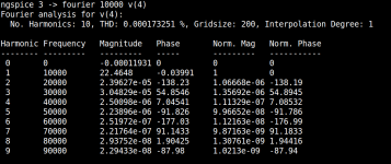

Hi Bob,
Yes you are right, I should say that it is a bad idea lowering too much the degeneration below PM of 60° (to put a value). Also degeneration 'linearises' Gm, it makes it less dependent on BJT internals. With my compensation scheme at the VAS (I should empathise this, and the topology and the components used, as I didn't verified with other topologies yet) PM can be lowered safely to as low as 34° !!! (I bet that most amp's oscillate with this value). Also distortion has a ceiling where the amp as a whole increments distortion as degeneration increases (OLG decreases and the FB network becomes 'suboptimal'), so there is a trade off between stability and distortion.

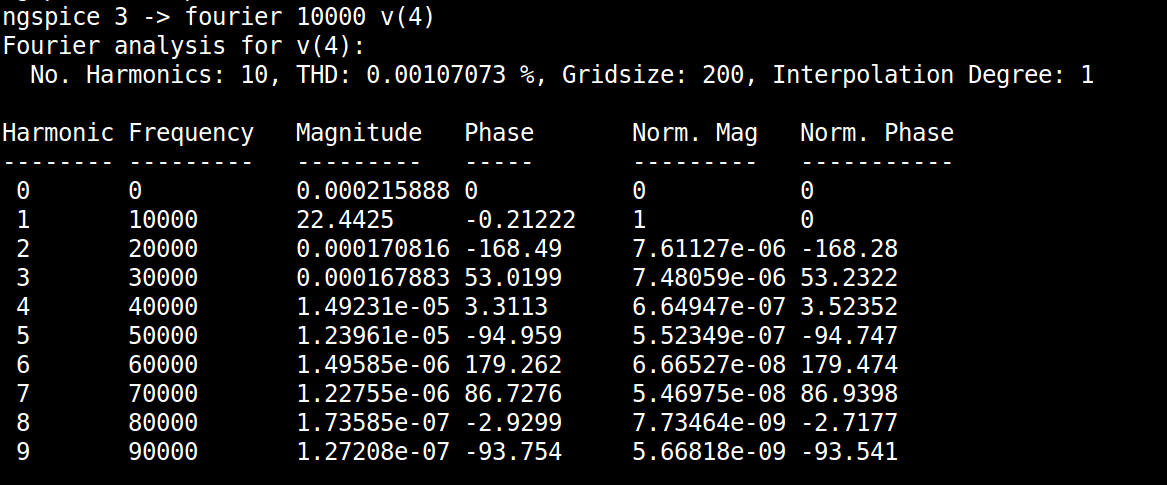

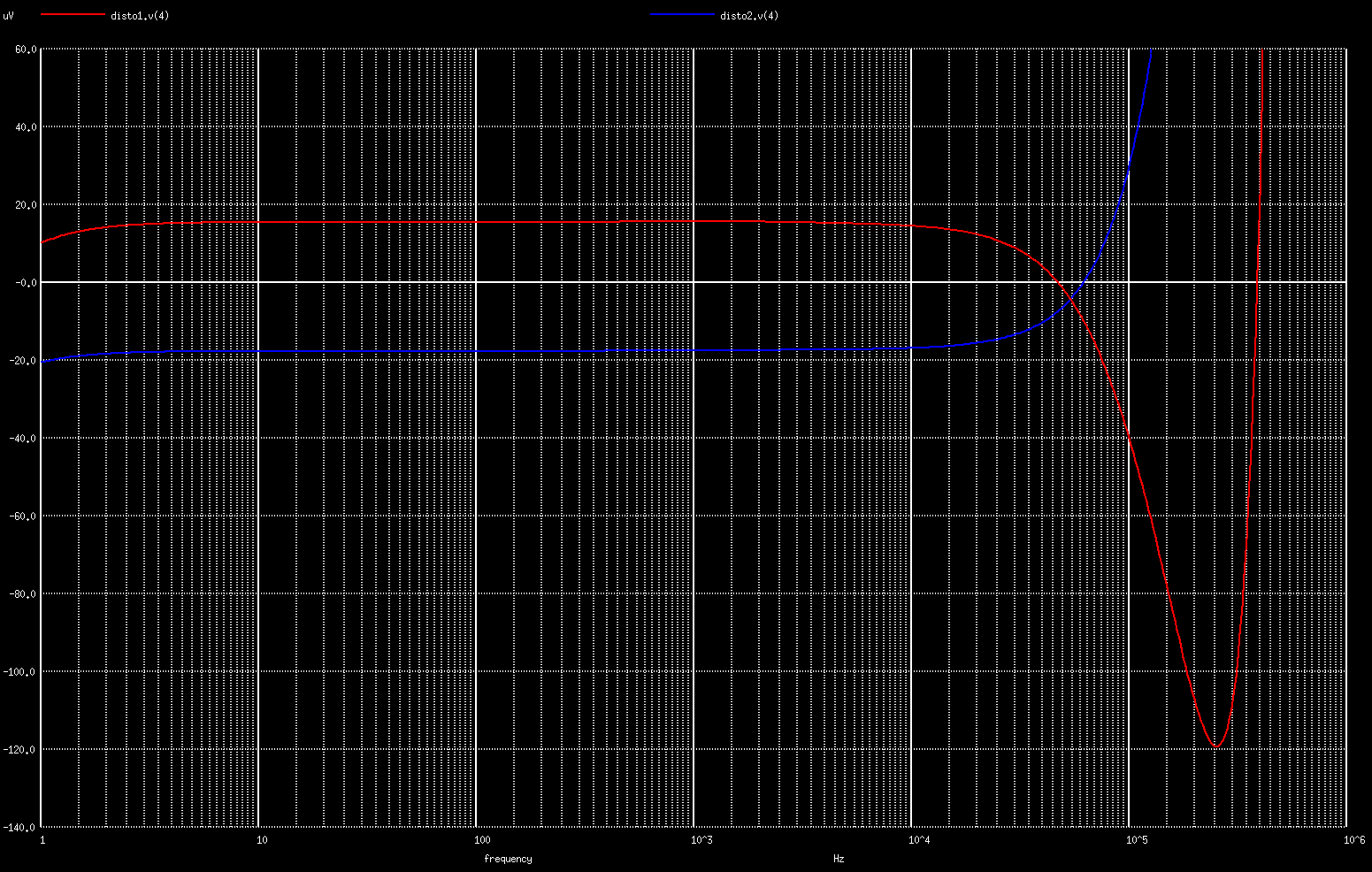

I show the results of distortion at 10KHZ 1V input for 2 stable amps.
1) without compensation caps and 47R degeneration, PM=60° f180°=23.7MHZ pix 1 is THD and pix 2 is H1 H2 profile over audio BW, H1 ~= 33.5uV and H2 ~=97.7uV
2) with compensation caps 680pf, 5.1R degeneration, PM=34° f180°=14.4MHZ pix 3 is THD and pix 4 is H1 H2 profile over audio BW, H1 ~= 15.5uV and H3 ~=17.7uV
The comparisons:
THD 2) is 6.1 times lower than 1)
H1 2) is a half of 1)
H2 2) is 5.5 times lower than 1)
So you may ask me, both levels of distortion 1) and 2) are inaudible so it worth all this stuff? and I am afraid that it maybe not worth, but I like the FFT profile of 2) because it lowers the same the even's and the odd's harmonics, if this thing works as I expect should be a killer amp, I am waiting the PCB to assemble it and begin the 'experiments' to see how 'close' or 'far' are the extensive simulations I've done, most probable I will end at 1).
I am sure that there is much more behind the scene than a simple LPF at 'loosed' leg of the diff. VAS that is a non-linear interaction between both emitters that splits oscillating energy out of resonance, it's my speculation a sort of 'mixing' process.
Cheers
Arturo
Sorry Bob the pix's didn't upload ???
Here they are ...

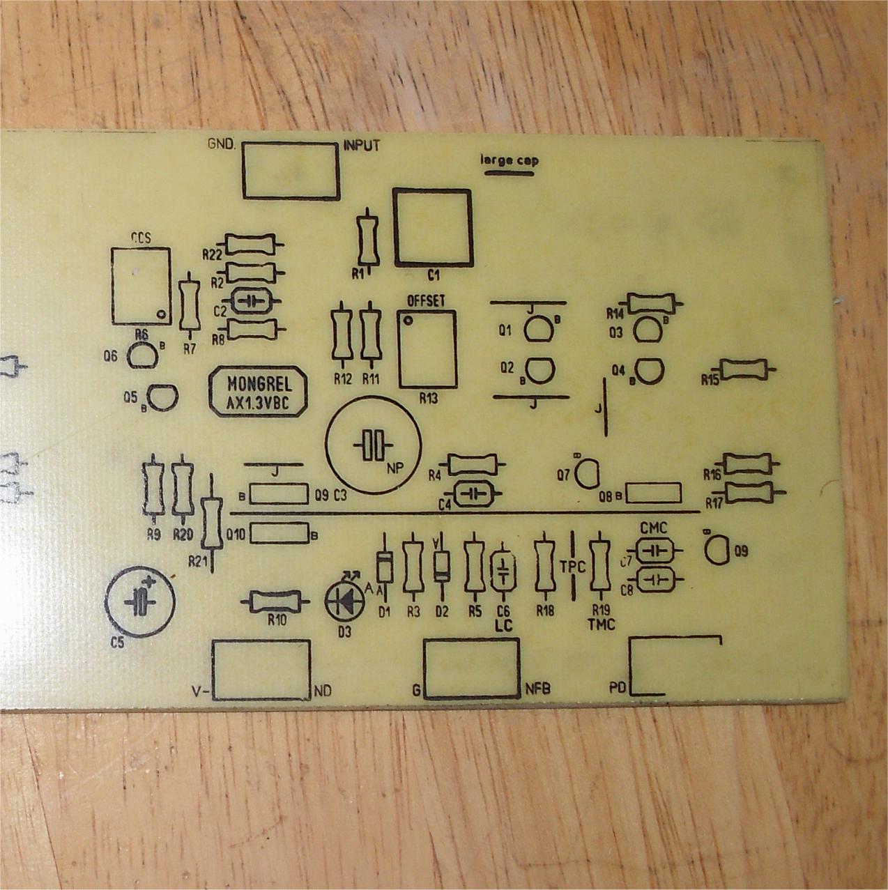

Not that it was planned , but this thread and the Cordell "negative feedback" thread brought about my favorite amp. E. Staurt and his injection of TMC made the "sterile" Lin topology amp "come alive". My thread (the mongrel - AX) - http://www.diyaudio.com/forums/solid-state/169590-mongrel-supersym-ii-27.html#post2444212 , and The "ultra ULD extreme" thread - http://www.diyaudio.com/forums/solid-state/142166-new-amplifier-uld-extreme-9.html#post2444449 is where "the book hits the pavement". The new book absolutely helped to both confirm and facilitate a real stable , super low distortion , "killer amp". Besides another similar design ( the quasi amp) these 2 threads are the most present ones that deal with mr. Cordells main Lin topology example. We used to call it the "blameless" ... but now we have someone else to "blame". 😀
Bob's book made me do my 4'th and ...hopefully final , revision (below) , all decked out with a compensation "playground". 🙂 -all the flavors (LC/TMC/TPC/CMC) ...
OS

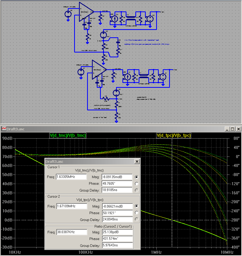

I hope I’ve established that the only informative way to view the loop gain of TMC is by measuring “inside” both loops – ie the total gain around the output Q as illustrated in my added delay sim http://www.diyaudio.com/forums/soli...lls-power-amplifier-book-134.html#post2420438 and my following post below
This clearly shows the ~1.7 MHz gain intercept of TMC which agrees with some of the circuit analysis that have been presented – and the analysis show how a lead network can be added to a TPC amp to give equivalent loop gain intercept, phase margins

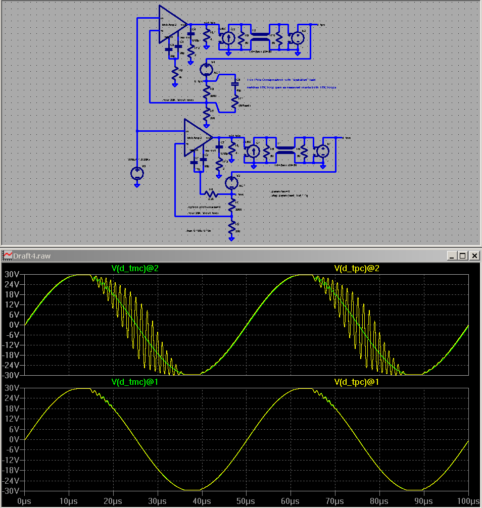

Bob posted a “comparison” of TPC vs TMC clipping behavior with some amp circuit modifications and an added bridging C across the T network of both TPC, TMC http://www.diyaudio.com/forums/solid-state/171159-bob-cordells-power-amplifier-book-137.html
... It is easy to see that both TPC and TMC do not recover from clipping as well as CMC. However, TPC is much worse than TMC, getting into an oscillation that does not cease until the polarity of the signal changes unfair comparison - this TPC example has ~24 degrees phase margin vs 57 for the TMC Clip example, the gain intercept freq do match pretty well with the bridging C
(interestingly, the negative polarity is more stable, probably due to differences in the output transistors.
I believe the pos/neg difference is due to the VAS being completely cut off - 0 Ic on the positive clip
BTW, the TPC and TMC versions have about the same amount of distortion reduction, and the total feedback around the output stage in each has about the same phase and gain margins. (possibly an error reading the stacked cursor report boxes with multiple sims open? - they are not the same) Also, small-signal squarewave response shows about the same amount of ringing.
Overall, TMC and TPC give up some stability in reducing distortion as compared to CMC, so they have to be evaluated carefully both in small signal and large signal. They are both very worthwhile techniques, but like any tool, must be properly applied. It appears that large-signal behavior of TPC is significantly worse than that of TMC when margins are close. Overall, I still am inclined to prefer TMC over TPC. I claim wrong approach to matching = wrong conclusion
Bob
I claim the conditions are “unfair” in that example because the loop gain's phase margins are very different with very small phase margin for Bob’s example TPC circuit
I modded my BobAmp to match the clipping example amp circuit, with an added lead network for the TPC amp that gives a good match between the TPC, TMC loop gains (properly measured) as shown in the 1st plot – with the delay stepping to show that they remain equivalent over a range of output phase shift
I then added the extra load, upped the input level to match Bob's Clipping sim conditions and changed the step parameter to switch out the lead network – you can see that with the lead network, which gives good loop gain, phase margin match, the clipping behavior of TPC, TMC are essentially the same in the @1 step of the 2nd plot
my TPC example below without the lead network rings badly – even worse than Bob’s Clipping example because I left off the 0.5pF bridging C on both TPC, TMC sims - to show the superiority of the lead compensation approach
The only “fair” way to compare TPC, TMC is to match the total loop gain and phase around the output stage, this can be done with an added lead network for the TPC case
With the lead network TPC matches TMC clipping behavior, unlike in Bob’s sim

oops, I had my loop gain probe in the "wrong" position...
I messed up the TPC, TMC Clip measurements and ran out of edit time - they do have different loop gain curves with different unity gain intercept frequencies but the rest of Bob's comments are correct in that phase margins are similar (and low, < 30 degrees) and both show good gain margin
despite the slightly higher unity gain intercept both the lead network corrected TPC and TMC without the bridging C show similar gain and phase gain margins compared to Bob's Clip examples when both have the added output loading - decreasing loop intercept frequency to match Bob's Clip circuit's intercepts gives a clear win for the lead corrected version
I believe that the TPC with added feedback lead network is a more "natural" means to match the response of TPC, TMC - easier to see with the wye-delta transform
the clipping performance improvement is clear
the implied sensitivity to strays with the tiny 0.5 pF bridging C having such a large effect is a little scary for either approach
I might "spend" some of the greater loop gain of the TPC to cut the input degen some - allowing larger compensation C, lower Z and hopefully less stray sensitivity
AC guarding the VAS input node may be a good idea too
(note to self: double check before pressing "save")

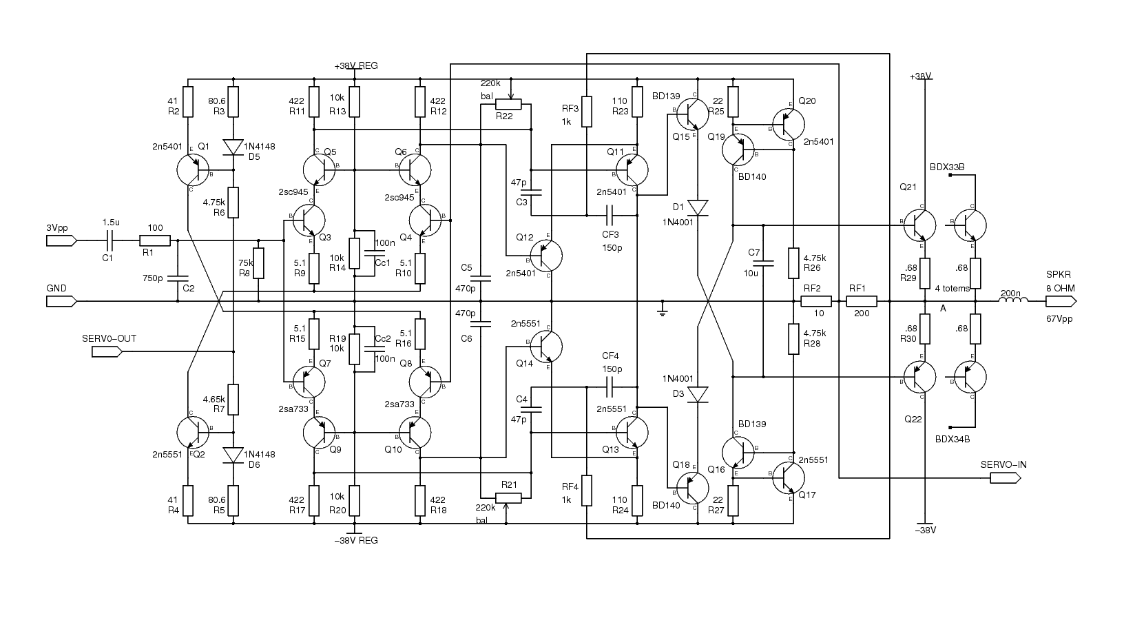

Hi, I am very sorry, my apologies to all, specially to Bob, but I did a GROSS error in the schematic of the circuit (it is a transcription of a .cir text file), I hope that nobody wasted time simulating the prior circuit (sightly changed), attached is the correct circuit, again apologies ...
Cheers
Arturo
