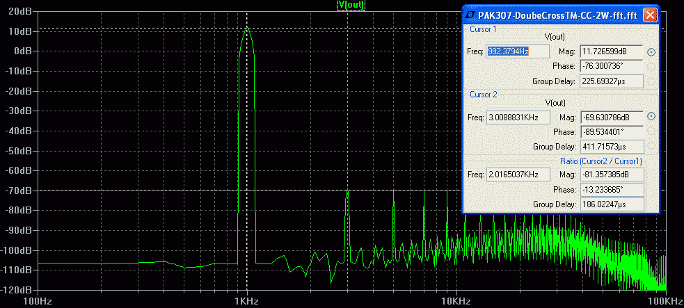

Fig 13.8a LTspice circuit download
An LTspice simulation file of the basic DoubleCrossTM CE output stage can be downloaded here PAK Project – Course Outline - PAK2 devo
A spreadsheet is also available there. It follows Bob's Fig.13.8(a) circuit.
Modifying the LTspice file allows FFT plots. EG changing it to a follower* and with Vin=6V for 2W out for the Class-A region, the THD is around -80dB (see attached). This basic output stage gives an idea of the best that is possible with DoubleCrossTM . (*To change the CE circuit to follower just move the ground on the load to the other side of the load).
Bob reports measuring for just the output stage 0.02% at 5W with a similar bias to what I used. So with 40dB of feedback I estimate the lower limit as 1 ppm at 2W, and 60dB nfb would be 0.1 ppm at 2W.
The big advantage of DoubleCrossTM for me is the wider Class-A region without gm doubling that you normally get when you over-bias in Class-AB. You can get a few watts in Class-A with 230mA total with DoubleCrossTM -- I expect Pass-amp and no-feedback fiends will love it.
