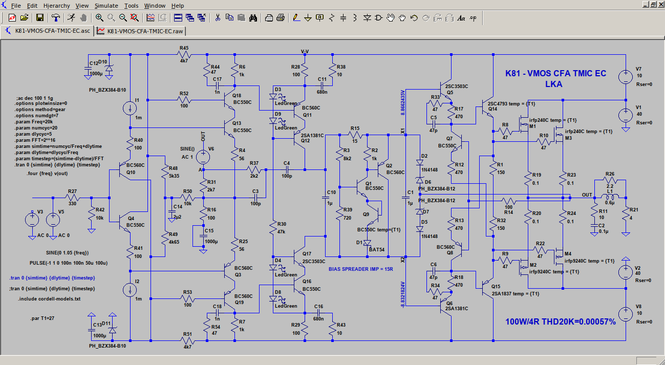

In my experience, is quite difficult to stabilize EC and two-pole compensation (TPC,TMC,TMIC)
One example is my last CFA VMOS amp which uses TMIC and EC (at least it's stable in simulation)
EC and TMC do require a bit more sophistication in design, but are both perfectly stable when properly implemented.
