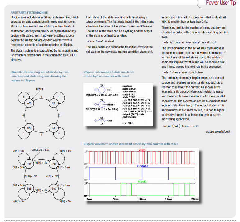

BTW, I ran across some other obscure LTspice commands: .state, .rule and .output.
See attached. Can probably be used to advantage also in analog circuits.

..... arbitrary waveform generator ?

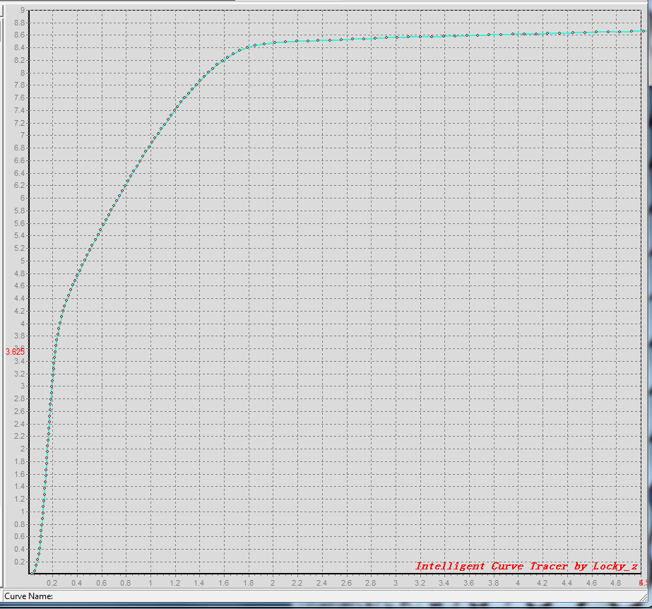

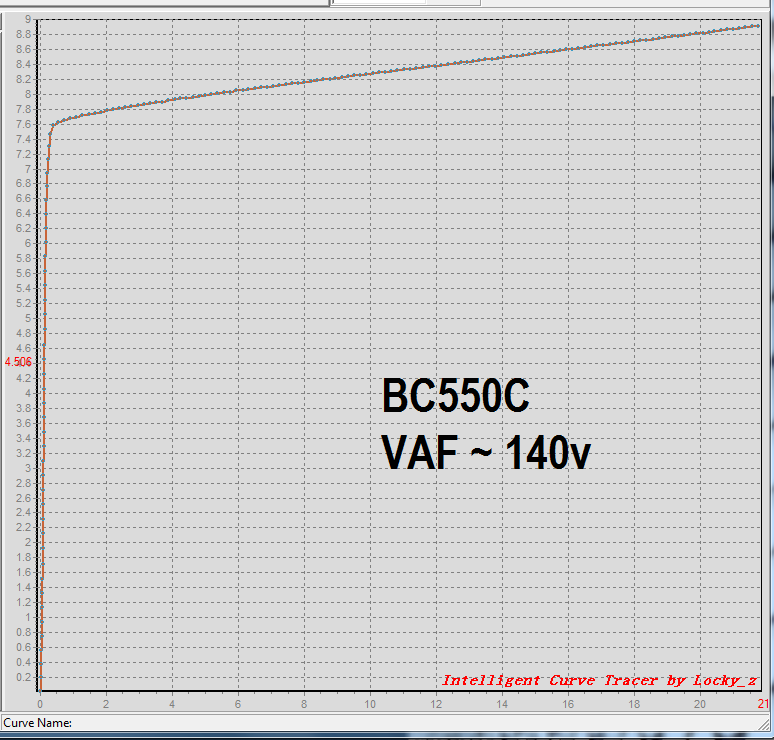

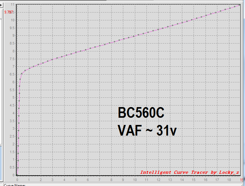

Yes, I measured them, and the measurements corroborate the performance of my Kmultipliers. There are some transistors with much higher Vaf but not many and none that I know of with comparable Hfe, noise and Ft.
Unfortunately a VAF of 30 is not pessimistic. VAF is actually one of the parameters that varies the most wildly between different manufacturers in my experience.
Also the idea that VAF varies inversely with Hfe doesn't seem to be very reliable. As far as I've seen it's a VERY loose relationship. I'd like to see someone test BC550A, 550B, 550C etc all from the same manufacturer to compare Hfe vs VAF. But if you're comparing different transistors or different manufacturers, it's all over the place.

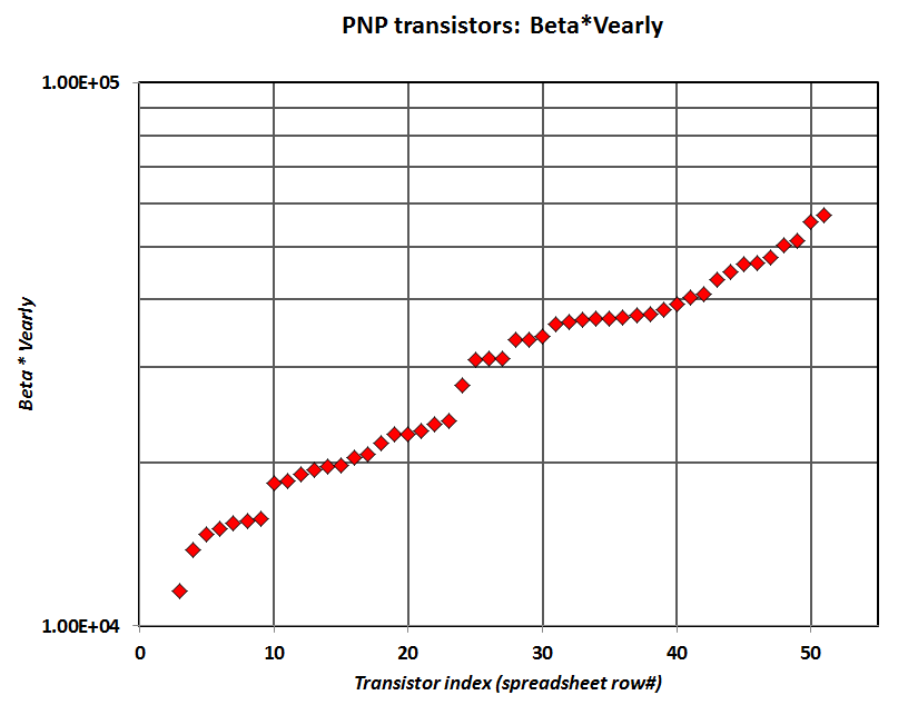

Thank you for sharing these and the results from previous post!A couple of scatter plots:
_
The results are in line with keantokens remark that the "figure of merit" is not that well behaved. Nevertheless, for pnp devices (are these BC560?), one finds VAF less than 100 for gain group "C".
Do you also have such a scatter plot for the npn devices? The Fairchild model BC549/50, e.g., states an Early voltage of 160V, but the current gain is clearly more in the "B" category. Other models I checked (LTSpice, Nexperia) even only state less than VAF=100 for group "B" devices.

Fascinating that there are no 100-150VAF PNP transistors sampled in the 300Hfe range. I wonder what that chart would have looked like back when thousands of 2Nxxxx transistors were available. Perhaps the chart is split due to a split between transistors characterized for high power and low power use, excluding those in-between.
The transistors with the highest FOM do seem to follow the inverse relationship more closely.
Also I wonder how many of those VAF values were contaminated with the quasi-saturation region.
