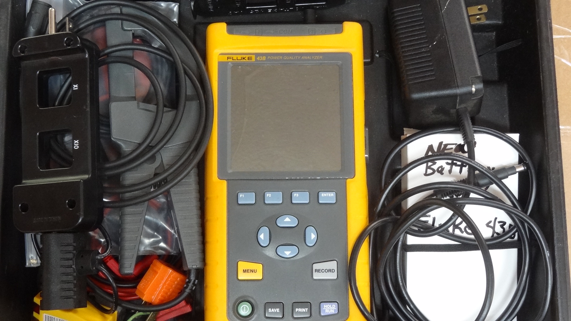

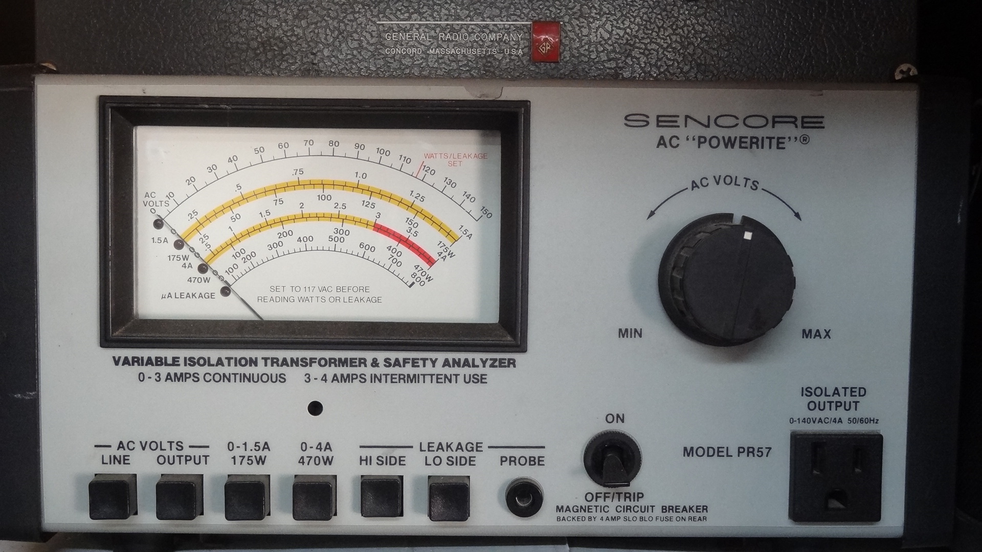

Here are two instruments I have to check on leakage ---> If I have a leakage issue, I will know it and where and how much etc.
I just measured a DAC and a receiver (2 yrs old)...... no leakage measured --- needle doesn't move at all. ... must be on the order of less than a microAmp. Both have 2 wire cords. 🙂 Now LP RIAA or long microphone runs etc could and do sometimes have issues..... But I haven't had an LP system in many many years... hum was sometimes an issue with phono IIRC. But even then I was able to reduce it to not be an issue --- still without Bal ips.

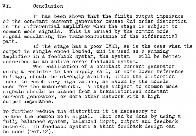

Our friend Ian Hegglun pointed me toward a relevant AES paper "Common mode distortion in differential stages" (preprint # 1742).
I am not allowed to post the whole paper (you can purchase it at the AES webstore) but attached is the conclusion. Supported by extensive measurements.

Makes total sense 🙂.
Bob

Hi Mr. Didden
Yes, that paper makes sense.
BTW: As far as I can remember it is written by Terje Sandstrøm, and it is nearly 40 years since he wrote that paper.
