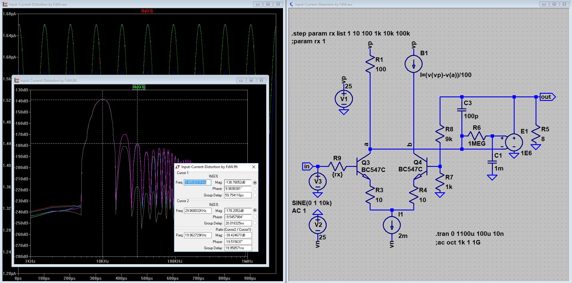

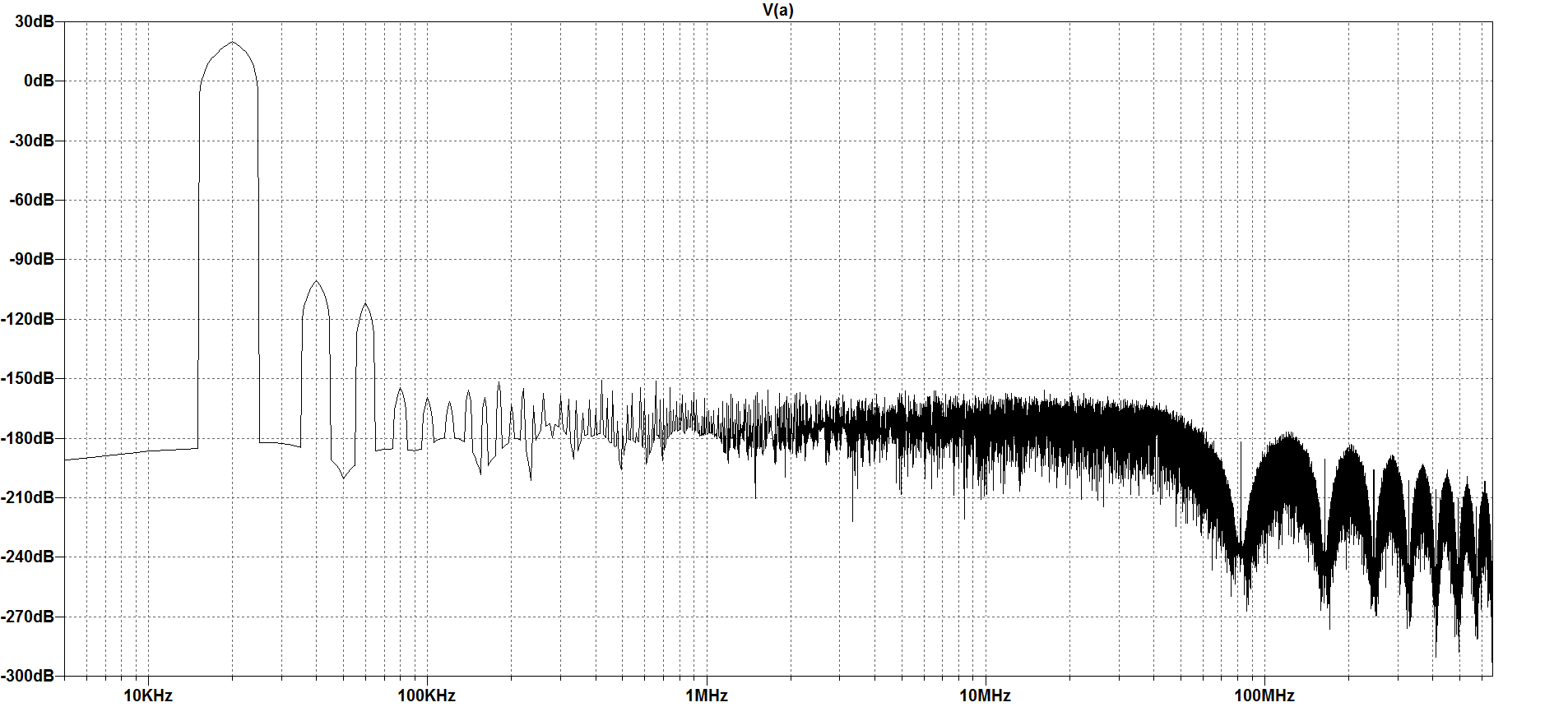

It seems to me this could be investigated with a 'real world' IPS with the rest of an amp composed of ideally VCCS and VCVS models. That way there is no internal NFB-required non-linearity because there is no nonlinearity in the VAS and OPS.
Jan

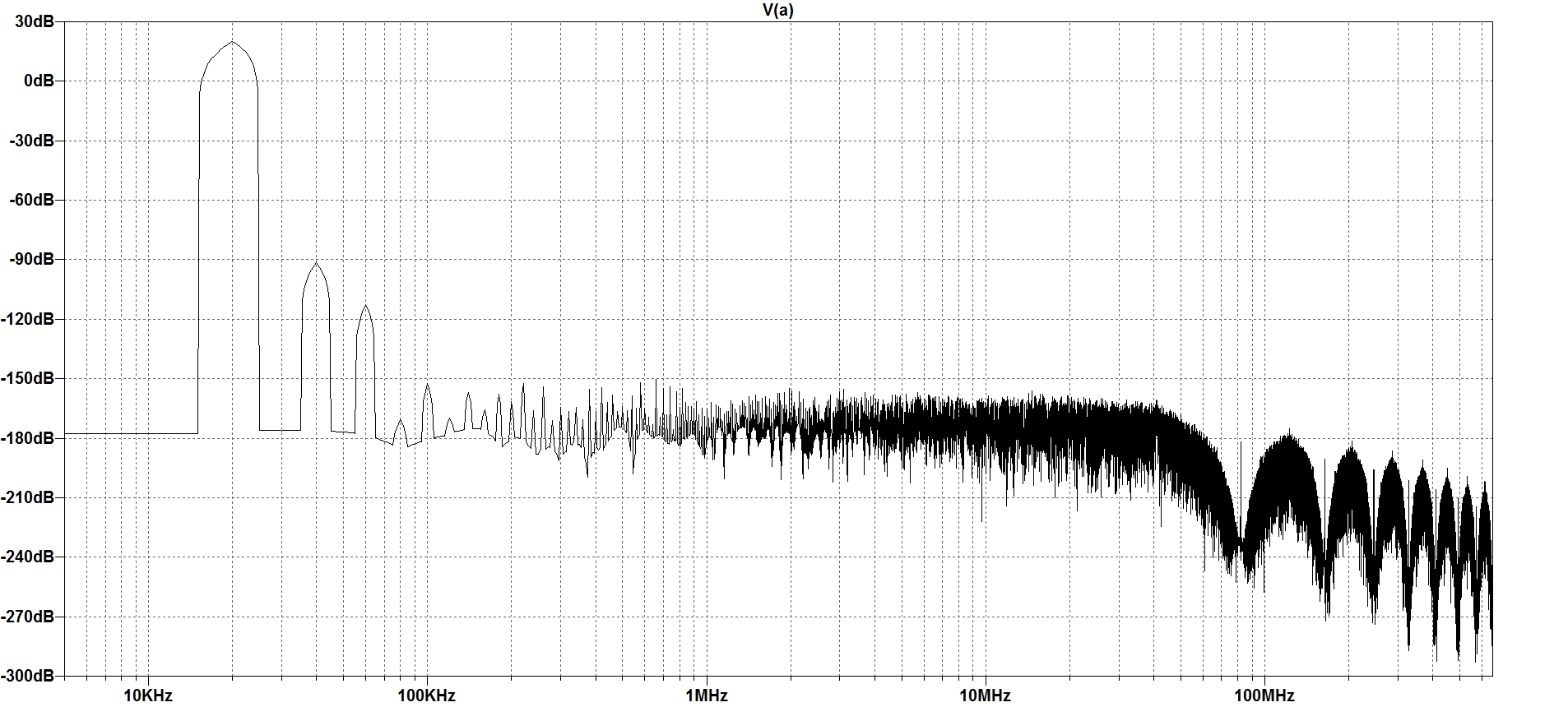

Some thing like this, the FFT shows about -80 (at Ib(Q3)) for the 3rd and no amount of gain in E1 is going to change that.
  • Input-Current-Distortion by FdW.asc

Frans what about a largish input series R, a few k? Does that make a difference?
Jan
Not much, only at the extreme end of the scale (100kOhm or higher) the THD steps from -75 to -50 (at the output) the noise raises with the resistor value. The input-current-distortion is in line with the output behavior.
This is to be expected, the input current is less than 2uA at 2Vpp (about 500kOhm Rin).

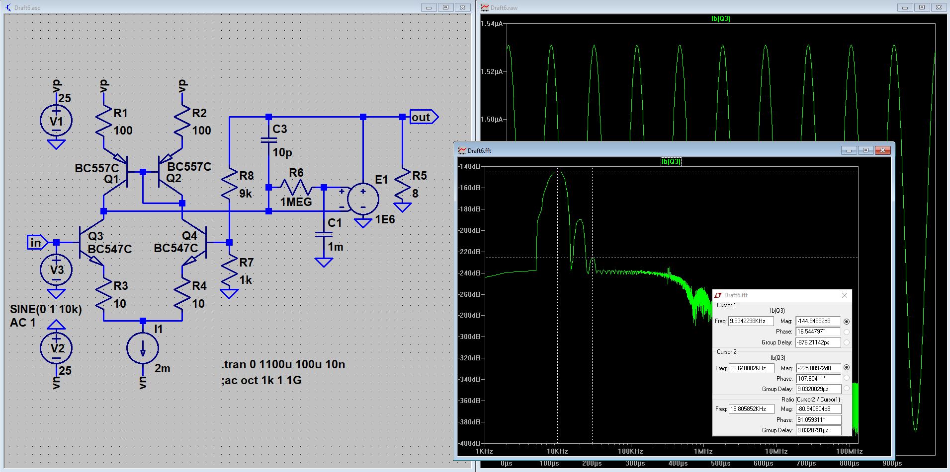

The response of the circuit can be improved by about 20dB by introducing an ideal current mirror.

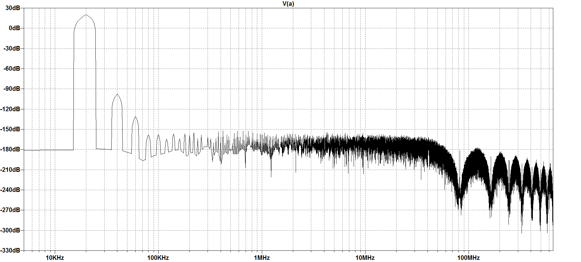

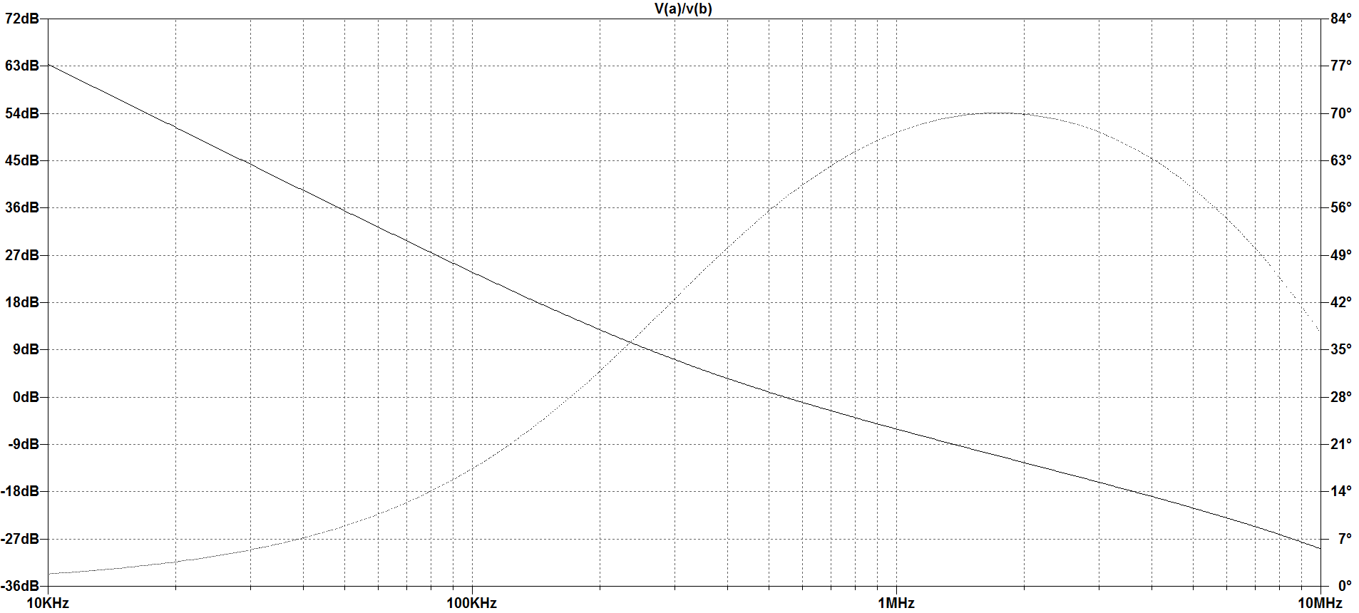

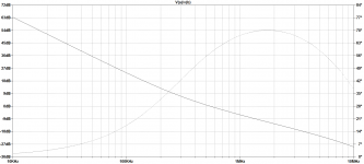

Influence of unbalanced impedances

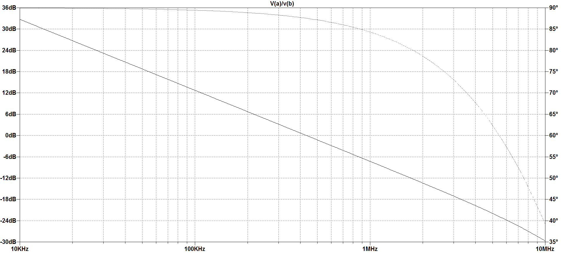

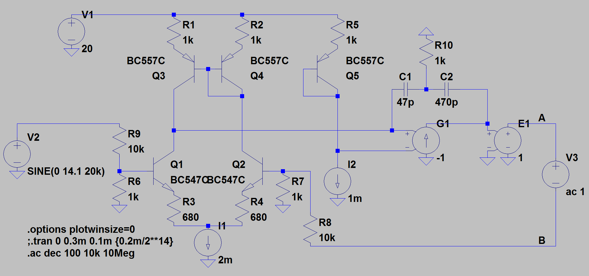

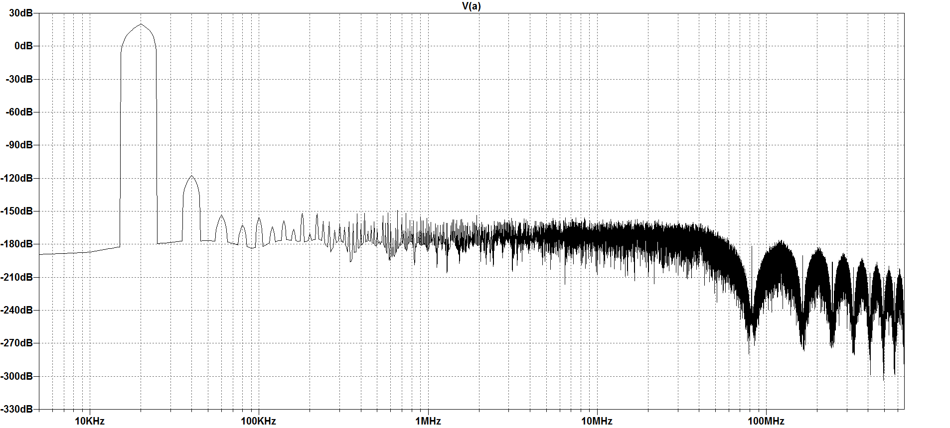

To conclude the experiment from post #8337 (page 834), I have repeated the same with two-pole compensation. In this case, distortion caused by the input stage is much smaller.
The schematic is in file schem.png, for single-pole compensation I just omitted C2 and R10. The loop gains are plotted in loop.png and loop-tpc.png.
As in post #8337 with single-pole compensation, the distortion reduces with unbalanced impedances at inverting and non-inverting inputs. The balanced version is the one in the schematic, for the unbalanced one I have reduced R6 and R9 to 100R and 1K, respectively. The files bal.png and unbal.png show the spectra for balanced and unbalanced impedances.
Result: Lower impedance at the non-inverting input leads to lower distortion.
When using two-pole compensation, the spectra of balanced and unbalanced versions are tpc-bal.png and tpc-unbal.png.
Result: Here, balanced impedances yield better performance.
As indicated in post #8337, the interplay of different mechanisms can lead to different results, depending on the baseline of distortion performance.
Matthias
PS. This is only simulation, and I do now want to touch the discussion about simulation versus reality. But as reality is more complex, there should be no surprise that one can easily get quite different results.
PPS. Of course, this simulation experiment does not touch the question, whether other (stronger) non-linearities in the complete amp can lead to non-linear input currents which may reverse the result again for two-pole compensation. Maybe, this is the reason that Damir got other results in post #8320 (page 832).
In contrast, the results in the current simulation experiment fit to the ones I get for my complete amp with two-pole characteristics around input stage.
