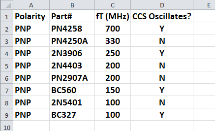

In my opinion, that's a matter of opinion; different people will give different answers, and all answers will be equally correct.How much Phase Margin does does a current source need. Is it not enough just to get them stable?
In my opinion, you want enough Phase Margin so that an ill-designed and sloppy implementation by the least experienced reader of Bob Cordell's 2nd edition, is nevertheless comfortably stable.
In my opinion that means it has a comfortable margin of safety even with the worst possible choice of device types (PN4258 @ fT=700MHz ?), and with the worst possible low impedance load on the current source output (5 ohms ?), and with the worst possible amount of stray capacitance on the sensitive feedback nodes (200 pF ?), and with the worst possible choice of current ratio between output transistor and control transistor (3:1 ?)

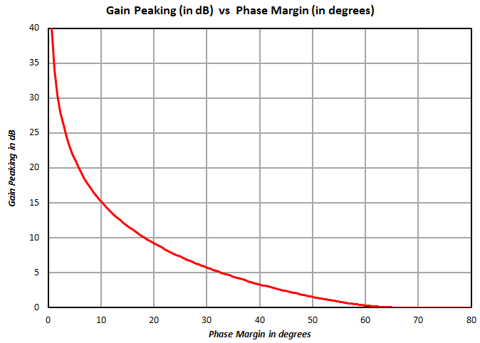

So, how much safety is "a comfortable margin of safety" in my opinion? Well, when I plot the equations in this web page I get the graph shown below. The standard advice given to undergraduate control theory students is "don't quit until you've got at least 45 degrees of phase margin" which corresponds to about 3 dB of gain peaking on that graph. But since I'm talking about phase margin in the worst of the worst case possible scenarios, I'm willing to tolerate, oh let's just say, 9 dB of gain peaking. From the graph, that's 20 degrees of phase margin. In my opinion.
I agree.
The only caveat I would add is that if the designer is willing to simulate in his particular arrangement, with his particular worst case specs of his transistors, etc., etc., he may be able to ease somewhat the definition of worst worst case that was given above.
Short of doing a formal loop gain analysis of the current source, either by itself or in-situ in the actual application, it can provide quite useful insight to do transient and/or ac simulation by injecting a pulse or ac signal current stimulus into one of the current source nodes and see if the waveform at the injection point shows a lot of ringing or if the ac response at the injection point shows a lot of peaking. Doing these sorts of tests can also be a decent sanity check on the loop gain analysis.
Bob

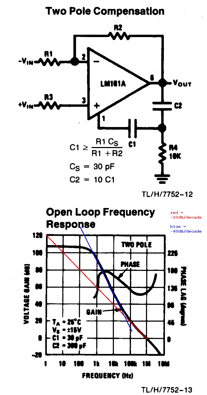

Those op amps were also TPC compensated for extra in-band loop gain for our Biquad active filters (we referred to it as "T" compensation).
NSC talked about Two Pole Compensation on the datasheet of their LM101, which dates back to 1967, image below. (click on the X in the lower left corner to magnify it to Full Size). Citation: Robert J. Widlar, "A New Monolithic Operational Amplifier Design", NSC technical paper TP-2, June, 1967.
My aggressive mentor and I worked here
_
Yes, TPC has been used for quite a long time, probably before IC op amps. That is a good reference you provided. We were certainly not the first to use it, but I am not aware of anyone else who integrated it into the IC op amp prior BTL.

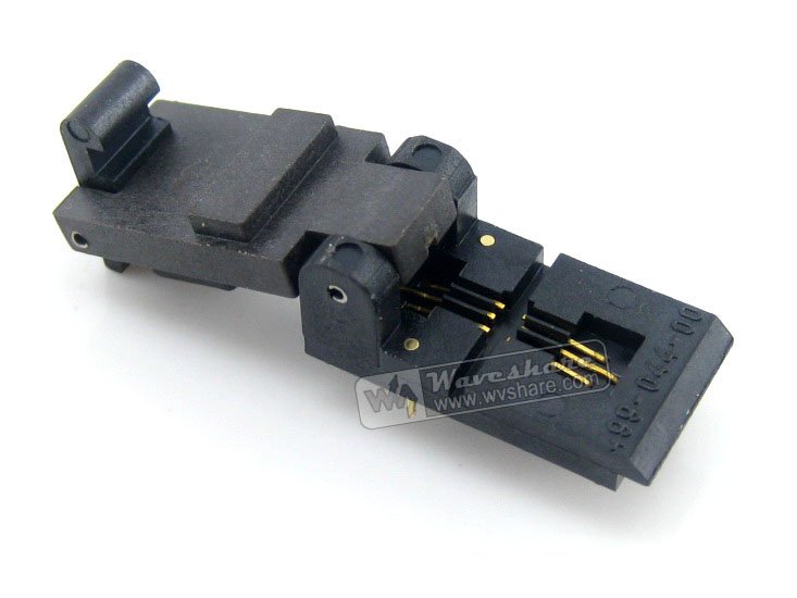

You would need to find someone who has access to a large number of NPN/PNP complementary pairs of transistors, AND who has access to a curve tracer. Then you would need to provide her with an incentive, a motivation, to take a whole bunch of data for you. Depending upon her age and financial condition, this might be as little as a few pizzas and a couple cases of beer. Or if you're really lucky you might find someone who would accept this arrangement: "I'll supply the transistors, you take the data, and when you're all done, you get to KEEP the transistors."
Personally, I suspect that "the answer" may include surface mount discrete transistors, just because all new semiconductor developments today are deployed in SMD. So you might very well need to supply your datataking employee with test sockets for surface mount devices, perhaps like the one shown below.
That is a perfect project for a 3D plastic printer......................So you might very well need to supply your datataking employee with test sockets for surface mount devices, perhaps like the one shown below.
Any volunteer to do the software to generate those two shapes?
Who could print these cheaply?
http://www.waveshare.com/product/sockets-adapters/test-burn-in-sockets/tsop-msop-sot/499-p44-00.htm
