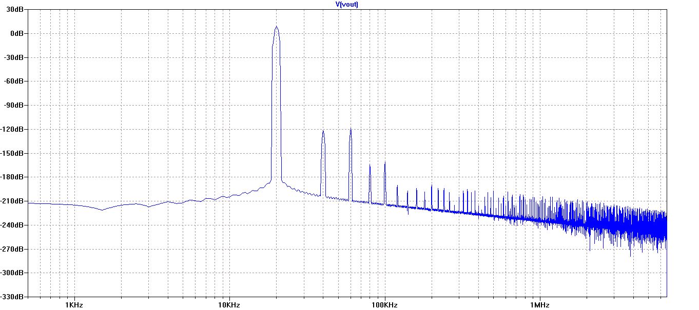

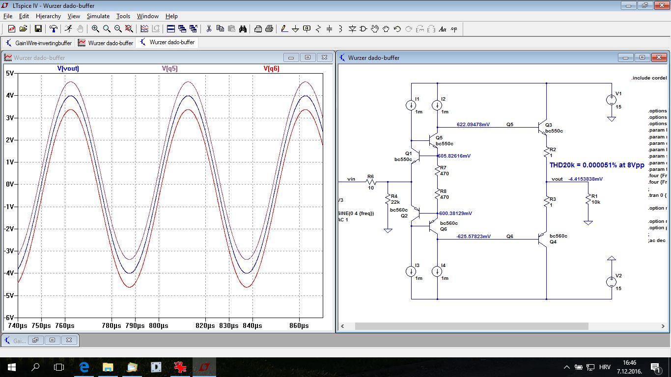

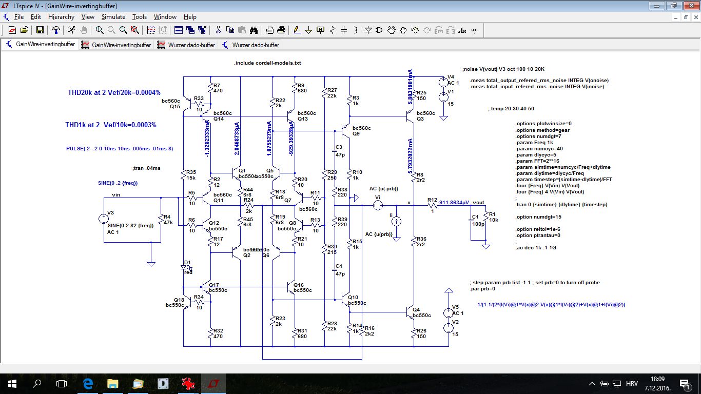

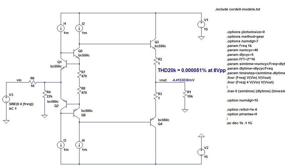

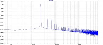

For some time I am trying to design simple inverting buffer but not satisfactory up to now.
During that process, I came to this non inverting buffer with no global NFB and very low distortion.
It has almost the same distortion as the one from the last Wurcer schematic.
BR Damir

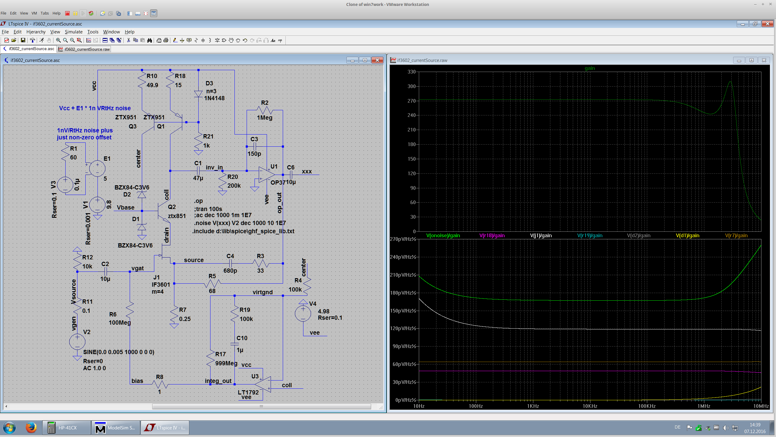

Finally we have the opportunity to ask ourselves: why does the world's lowest noise device (AD797) use current source loads on the input stage, rather than resistor loads? Are resistor loads STUPID?
Feel free to answer that for yourself. Replacing Q1 with a resistor that supports 90mA
bias current requires excessive Vcc or the gain of the first stage falls through the ground
and it takes the noise performance with it.
The expression "active loads tend to amplify their own noise" is a verbatim citation
from Gray&Meyer and that's one of the very few points where G&M stay vague.
regards, Gerhard
bias current requires excessive Vcc or the gain of the first stage falls through the ground.
I think I already answered his question, the 797 actually used resistors to Vcc with pnp's in folded cascode. Active loads frequently eat headroom. The real fun is mixing bi-polar and FET's the gm mismatch gives plenty of opportunities for unwanted noise gain. Some of the bandaids in the 743 are embarrassing. I was also told by the CEO/CTO of a major sonar company that these effects don't exist because he never saw them. So no surprise it keeps turning up.
BR Damir

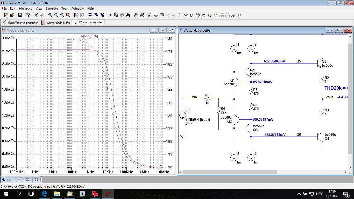

Seems the current in OPS is very high...... too high for those devices??
I tried also to make ULD buffer but also ended up with it being too many transistors.
THx-RNMarsh
How so? Humor me for a second. In the quiescent state you have two Vbe's across 470+470 Ohms which for any silicon transistor I have ever seen is >1mA, but the loop is trying to force Q5 and Q6 to be at 1mA collector current so the loop can not be satisfied and the collector voltages of Q5 and Q6 are undefined (actually they saturate).
Yes and thus force the Vb of Q3/Q4 very low - to the voltage across R7, R8 and thus lead to low current in Q3/Q4.
Jan
Yes you are right, the collector voltages Q5 and Q6 are very low.
Attached simulation with the collector voltages under signal swing. It could be that simulator gives wrong result in this case?
