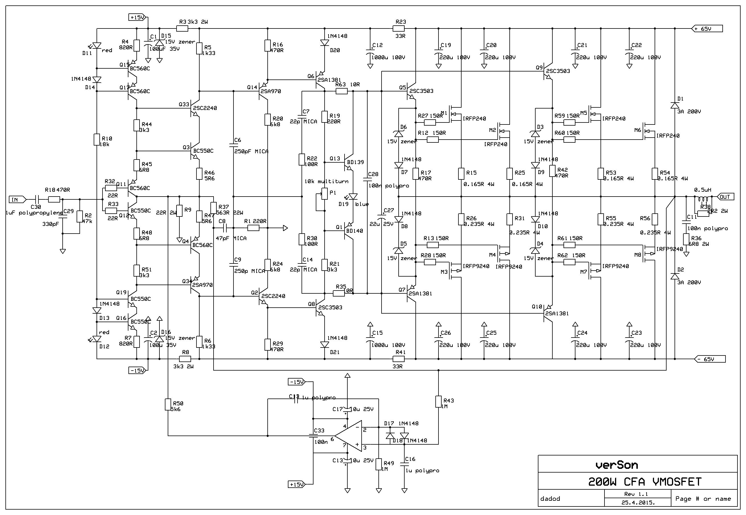

Hi Bob,
Thank you for your time. I attached the CFA schematic to show how it is quite simple, complementary IPS with supper pairs (Baxandall), enhanced VAS (EF VAS), and fast drivers same as used for the VAS.
I know there is not defying any laws of physics, and I know that I can manipulate a VFA to get similar Bode plot. I tried many VFA simulations (not with very low feedback impedance) but my CFA defeat a VFA by 20dB at 20kHz.
This IPS uses a resistor as a load and it works the best. I simulated with active load and in this case the loop gain increases at low frequencies, but the amp is nit easily compensated and more similar to a VFA and I dropped that approach.
A big advantage a VFA over CFA is no need for strict matching, in most cases CFA will need a servo, I think that CFA is not for a beginners.

Well if he is doing that in production as he says, we must be missing something. I don't think he's making that up.

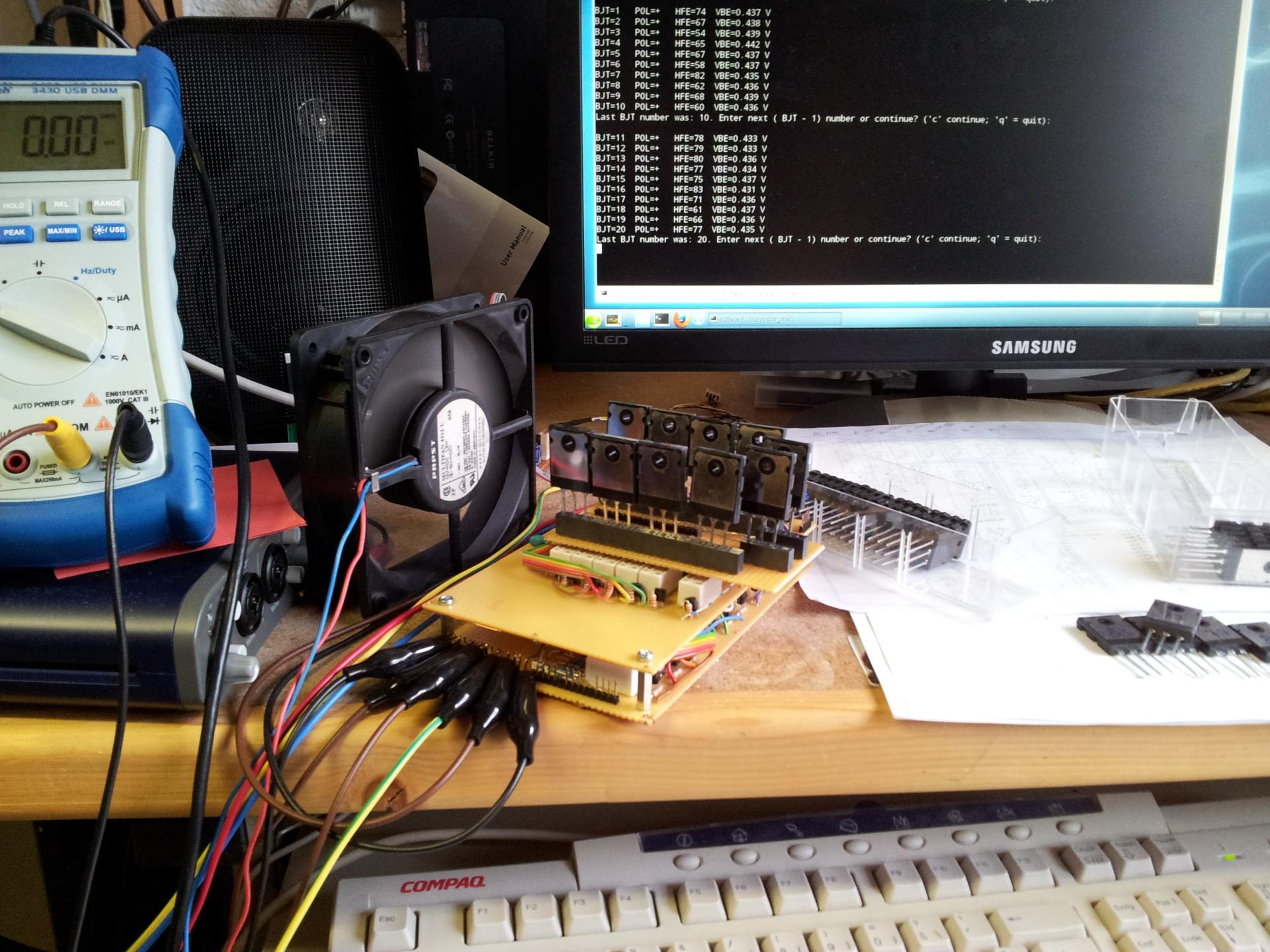

Use a fan during matching. Wait until devices have the same temperature.
Even touching the transitors for only 1 - 2 seconds will deliver completely different results. Room temperature should be stable too.
Attached a picture of my homebrew transistor matcher: Software starts with automated measurements and waits until values have stabilized.
