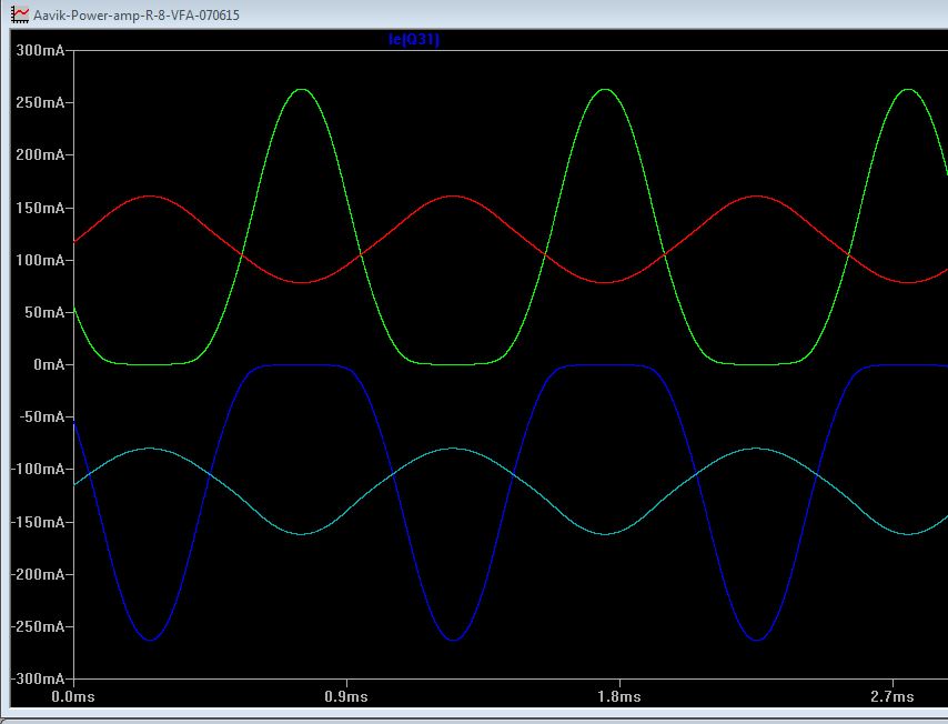

Device currents. Driver and output transistors currents 18VPP and 36vPP signal to the load. When the currents are above blow 0, they work in Class A, when signal is too large and the transistors runs out of bias they transition into class B
The other curves is the driver device currents.

To stay a little on the subject I do feel that a lot of quality can be gained by looking at how the output devices turn-on and turn-off, here the "drivers" are connected to the output and the output is biased with a low value resistor bias spreader, this makes the output switching much softer, as the "drivers" fill in the missing current from the softer turn-on/off.

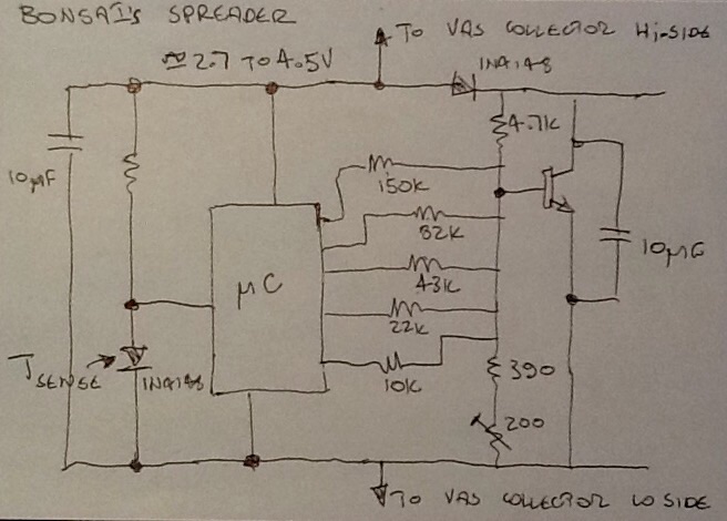

Earlier on I mentioned using a micro controller to manage the bias spreader. Attached is a concept diagram. As you can see, if you use a standard spreader to do the first order compensation, the controller is left with just the 2nd order compensation to do. With this approach you can quickly build very sophisticated compensation solutions. There is no reason why you can't use a number of sensors, or even look at the temp differentials and apply PID techniques. I have shown an adjustment pot, but this could also be eliminated. 16 pin 32 bit ARM SOIC devices go for about $2 and options with more than enough memory are readily available. The concept presented here is for a triple OPS.
You will note that the supply to the controller is not regulated, and neither is the current through the sense diodes - all the variability is taken care of in software.
A further potential benefit of course is that the whole thing could be made self calibrating.

Sensing bias can be done easy as a differential signal signal taken over the emitter resistors with a JFet op amp, then all below 5 Hz can be isolated (like a servo) all's left is the bias. With this you can make an algorithm that can hold the transistors with a defined bias. A uC and a R2R DAC resistor ladder inserted in the VBE can make it possible.
You could add I bias sense as an additional input - but that would have to be real- time and I think very computationally heavy. In the scheme presented above, Ibias is controlled wrt to temperature to 1st order by the standard spreader and to the 2 nd order by the MCU.
The nice thing about 32 bit processors is that you can comfortably work at a high, abstract level. When I was doing my PGA2320 based preamp with LCD display, I added automatic brightness adjustment and originally used a look-up table. One of my Japanese colleagues asked me why did I do it that way? I eventually just used a formula - plenty of computing power and lots of great development tools make this type of approach very doable. So, not a weekend project, but not 6 months either.
The R2R ladder need not be highly accurate - a simple approx binary relationship between the resistors is ample since you are correcting for 2nd order effects. If the 1st order effect is good to within say 30 % and the second order say 20x better than this you do not need accurate tolerance parts.
I always cringe when someone hints that it is JUST software 🙂
