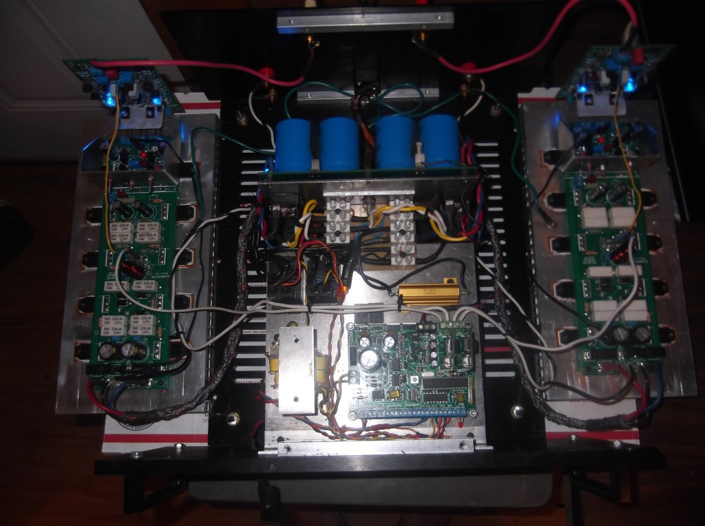

After them posts of what a 5 pair's Re measured , I finally get to listen (below).
I hit a few 200W peaks ... tested all 20 outputs after. All
were 12-13 mV except two (11.4 and 14mV).
Some of my builders go from design to a working prototype in 48 hours. I'm
a bit slower ... still - "take a leap of faith" , build and then perfect it.
Worst case , you will have to design a "R2" or "R3" (revision).
Nothing comes easy , man. 😀

Nice looking amp!! So you feed some high power signal to heat up the amp, then cut the signal and immediately measure the voltage across all the emitter resistors to see anyone has excess voltage across it?Digital music can have some pretty high transients. Finger snaps and
stick strikes I've measured almost 200W at slightly above normal listening
levels. FM radio - no such thing.

You use real speaker to do high power test? Luckily I don't live next to you!!!😀
Can I use dummy load to run it hot and read the Re?
Do you run high power until the heatsink heats up or you run it very short time before you read?

I run mine in on 4 ohm dummy loads.
