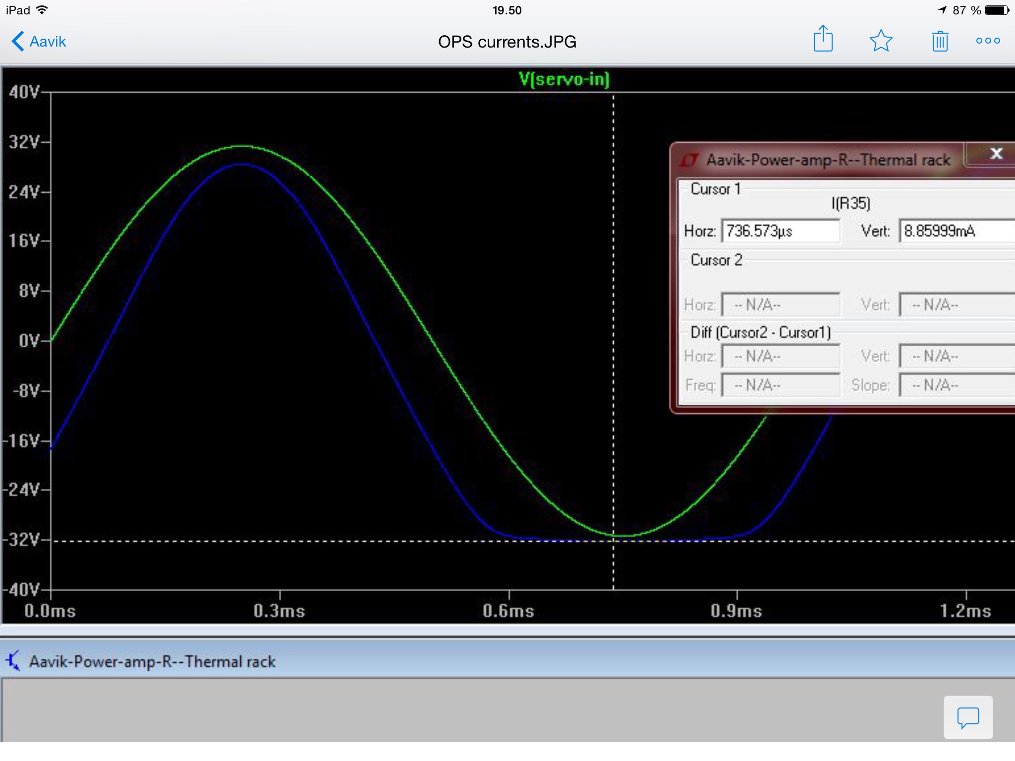

Why not make something non switching, Then you never leave class A region, even with a low bias of 60mA and 0,47 ohm Re.
Here voltage output and associated Ops current into 4ohm load.
One single set output transistors biased heavily into class A driving 8 pair Oliver biased dumpers creates a Non switching OPS (Dumpers spread with resistors to output)
The idea is that when the load demands more current, then the drivers will dalso eliver more current in balance withe the biased dumpers and thus keep them away from switching. In my setup switching only happens when the output is forced very close to the rail, and then also with the gradual turn off/on seen here

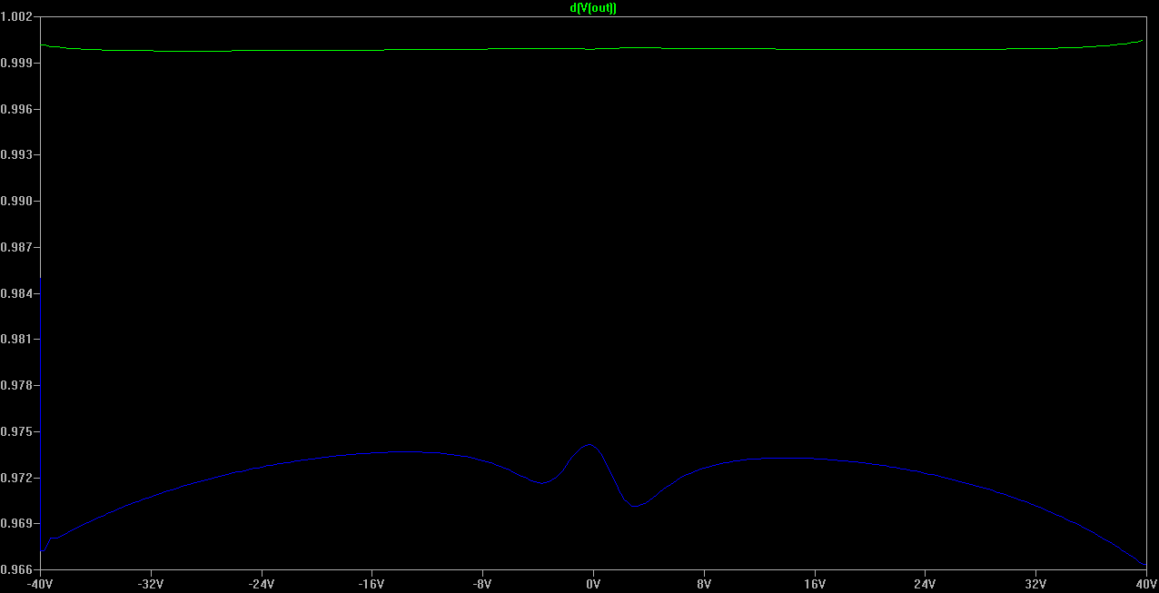

here is the plot of the derivative of V(out) versus V(in) for bipolar buffer amp with hec, http://www.diyaudio.com/forums/soli...ur-solid-state-pics-here-418.html#post4388005
green trace - hec on
blue trace - hec off
