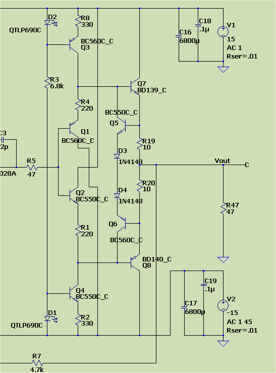

Please see attached schematic and graph comparing your arrangement to a “more conventional” arrangement. The setup here tests the current source current as the power rail varies from 10 to 60 V. Vce of the BJT is kept constant at 10 V for a fairer comparison. Green line is output current of your current source, blue line is output current of conventional design.
For those that have built diamond buffers - what do you all think? Do the current sources need to be “constant” current sources or is Alan’s arrangement just fine?
2Q CCS's for alan's higher current OPS app.
With a input stage diamond that is either decoupled or regulated ,
LED CCS's work well.
Reference from rail to rail , any ground connection makes PSRR
quite inferior.
Whatever CCS he uses (in the OPS) , it's unique Tc will have to be factored
into the OPS's total thermal behavior. It was this complexity
that kept my design a simple EF3 with just 6 PTC Vbe's to worry
about. 😱
PS - lower powered OPS powered by regulators - I used LED CCS's (below).
OS
You design an amp, you better know what rail voltage you plan to use and choose the right value of R3 in your schematic. I choose to run either 40V or 25V, you can see in my picture I have a 10K parallel onto the original 10K 1/2W resistor on the far right to make 5K for 25V as I am using 25V for testing. Later I can remove that to use for 40V rail.
I don't like two diode as you need more parts. I don't like to use extra parts unless I have to, more parts, more space on pcb and might compromise layout. I definitely don't like 2 diode because it's only 1.4V. I only get 0.7V drop to control the current. 3 diodes gives 2.1V, eating more headroom and one more component. The only way to get 1V across the current setting resistor is 2 diode and 1 schottky diode!!!
It's my personal preference. I never seen using LED for biasing in the industry, I am not comfortable with LED. I don't know the tempco of LED and what is the voltage variation. More important, they as specified at 1 or 2 mA, I want to run at least 4 to 5 mA.
I actually gave this some thoughts and I decided to go this route. Layout is important for me, it is a lot more components doing the diamond and so complicate to get the critical transistors to screwed together to get the best thermal tracking, this is the last thing of my concern.

Miib is right , "choose your poison".
Higher Re , more reliable/cooler - Lower Re , maybe better sound.
How about better Re , or non-inductive Re ?
I just ran my 4 year old triple variant , Alan's variant , and
a classic Locanthi.
A Plain old 3EF can ...
- run the lowest driver/predriver currents.
- have the most (predictable) thermal compensation.
- and have the lowest THD.
The only thing the diamond and CCS's do is replace the driver "suckout" cap
and burn off more current. Underbiasing the CCS's in Alan's or removing
the cap in the Locanthi do the same thing to distortion.
So , the tradeoff is a simple Vbe , no cap , more heat versus having
the cap and a compound bias spreader (and less heat).
I had alan's design and the Locanthi nearly equal in simulation. Alan's
required 20-30ma current to have the same performance as my
8ma setup.
Glad I did this , and glad I waited 4 years.
OS

Can you explain a little more, your comments are valuable. I don't know Locanthi.
I go for diamond mainly for the thermal tracking capability and may be little improvement in large signal linearity. I was thinking about in the diamond, the current through the pre-driver EF decrease while the current in the driver increases, or vise verse. The Vbe variation are always opposite between the two and have a first order canceling effect and lower distortion.
Besides the thermal modeling , I saw no difference in any FFT - cancelling.
NFB and the IPS take care of that.
What I did was simulate with a 5ppm blameless and A/B compared
The 2 OPS's. The EF3 also was "faster" , could do >350v/us (CFA).
Simple is better for speed ..... 😀
Locanthi is just your standard 3EF (class A /class A / AB -outputs).
PS - It's just better to leave the pre-drivers right out of the thermal
"picture" - run them at <3ma.
Since you want to pursue this diamond variant , you should continue
that EF3 thread I posted - 🙄
OS

1) Why is regular 3EF faster than diamond? If I run the pre-driver hotter so I never run out of steam, I should get the same speed. Yes, I might have to have more current, but even at 20mA is hardly in the big picture.
2) I have spent a little time reading how the CFA works. Most of the articles are from Ti, LT etc. that explain about their opamp. I yet to find a book that explain about the pros and cons of different variations like how Mr. Cordell did in his book on the LTP IPS. Do you have any suggestion in a book or articles that explain how to optimize CFA for low distortion? I have every intention to do a CFA in the next go around. Just not now, I want to do a conventional one as the first project.
3) Why leaving the pre-driver out of the thermal picture? I thought it's a big advantage of diamond being able to use the pre-driver to compensate the driver.
I would expect my OPS can keep up with your Slew Master stuff. I started out with 3EF(diamond), I use a very big driver transistor with 60MHz fT to drive the big output transistors. I use high current to increase the speed and keep it in Class A. I never done the simulation on the OPS alone, but I would expect mine can keep up with your fastest circuits.
If you don't think so, can you explain?
Alan

Never seen red LEDs used as the voltage reference in commercial designs? I have, many in fact. The tempco is pretty easy to figure out if you build the thing and measure it. As a hint for you, a 3mm led will fit inside the mounting hole on a TO-126 package. You may have to file some LEDs down slightly, but they are very, very close to a snug fit. Encase this in foam and you can approximate a zero tempco depending on relative current densities. Theory should help you there. Use the older, non-efficient 3mm red LEDs.
Diamond buffer circuits can have odd tempcos of their own. I have built some over many years. Experiment on the bench and forget the simulator for these simple circuit blocks.
Are you using 1% metal film resistors from China? Measure the the tempco of those, then buy a Dale 1% part and try the same thing. That should be a very quick lesson on what to expect from various parts.
I'll just say in closing that you are talking down to a bunch of people who have a great deal of experience. Don't do that.
-Chris
I’m under the impression that “Locanthi” additionally implies that the emitters of the drivers are connected via resistance that is not split with the midpoint connected to the output.
Isn’t it nicer to have something that will work on a range of rail values without alteration?
Apart from that, with your design at 40 V, if the voltage goes up 5%, the current goes up 6.4%. With the 2 diode alternative, the current goes up 0.7%. Presumably you are using an unregulated linear supply to give your 40 V rail? So as that rail is bouncing around, you’re going to get a nice 100 Hz component in the output of your current sources. I’d just like to hear from more people whether this is a problem, because as you say, your arrangement is simpler!
I don’t see the problem here. A smaller drop seems better to me as it gives you a wider compliance range of the current source.

So the question is how much power you are going to want out of your amp? Remember even though it looks very tight, but you still have 5 pairs!!!! No point of eliminate two pairs and only use 3 pairs, just don't work them so hard. Remember, with 5 pairs, you have advantage of better SOA limitation. I never understand why people push so hard to stay with two or three pairs and worry so much about the SOA and resort to use "the" transistor.
Bottom line, if all else are equal, I'll take your tight 5 pairs over any others with two or three pairs if you want to get the same power output. You just create hot spot on the heat sink if you use less pairs.
Alan, the OPS are to idle at slightly under 60mA per device, and the total heat sink dissipation at idle, including that of drivers and pre-drivers, is about 46W. The heat sink in picture measures 300W x 150L x 50H mm^3, has 28 fins. The 50mm height is made up of a 10mm base height and 40mm fin height, possibly came out of the same factory somewhere in China as did the heat sink in one of your recent pictures. I expected it to be ample for a 200-watt amp for domestic use, and was not concerned about the thermal problems as much as the VAS standing current problems, even with the OPS transistors lumped together.
After reading Ostripper's post a few times, I am curious in the dynamic voltage of the drivers and the big output transistors at different points.
Attached is the drawing showing the drivers Q1 and Q2 driving the output transistor Q3 and Q4 respectively, through 2.2ohm base stop resistors R4 and R5. Assume the emitter degen resistor R2 and R3 are 0.22ohm. Assume idle current is small. At idle, current through Q1 and Q2 is set by 1.4V/68=20mA. This is shown in black in the drawing. Assuming all Vbe are 0.7V.
Now let's look at the situation of large signal input where the -ve Vpeak = -50V at the output driving a 4ohm load. The peak current is 12.5A as shown in RED. Let us trace the voltage from the output CLOCKWISE all the way to the emitter of Q1.
1) -50V at output, Q4 sinking 12.5A.
2) R3 has 12.5A, so it drops 12.5A X 0.22ohm = 2.75V. Therefore the emitter of Q4 is -52.75V.
3) Assuming Vbe=0.7V. The base of Q4= -52.75-0.7=-53.45V.
4) Assume beta of Q4=50, Q4 sinking 12.5A implies the base current is 12.5/50=0.25A.
5) voltage drop across the 2.2ohm R5 base stop resistor is 2.2 X 0.25= 0.55V. Therefore the emitter of Q2 is -54V.
6) Assume again Vbe of Q2 is 0.7V, therefore the base of Q2 is at -54.7V.
7) The bias spreader is 2.8V, therefore the base of Q1=--54.7+2.8V=-51.9V.
8) The emitter of Q1 is -51.9-0.7V=-52.6V.
9) The voltage dropped across the resistor R1 between the emitters of Q1 and Q2 is -52.6+54=1.4V. The current through R1 does not change!!!
Of cause the current increase in Q2 and Q4 is going to increase the Vbe of these two transistor. Let's just say the total Vbe increase is 200mV ( this is a lot as it's a logarithmic function). The voltage drop across R1 is 1.4-0.2=1.2V. Current through Q1 and Q2 is 1.2/68=17.6mA. It's nowhere close to turning off.
Please take a look at my work. If this is correct, people NEVER have to worry about the driver transistor being turned off under signal as the current increase for Q1 when Q2 is driving low hard. You can lower the idle current to less than 20mA without even worry about any drivers being turned off. They will ALWAYS stay in Class A.
I'm trying to catch up on this thread after being out of the loop for a couple of days. Sorry if some of my comments are redundant or obsolete.
With respect to driver current and whether it turns off or not, and for the Locanthi-like topology where a single emitter resistor establishes bias current between the P and N drivers, the driver generally will remain in class A and not turn off. I consider this generally desirable, so that only the output transistors are not in class A. I also prefer fairly high idle current in the drivers so as to readily sweep out minority carriers on the turn-off slope.
In particular, at higher frequencies it becomes more difficult to switch off the output transistors quickly enough. This is especially the case when driving high current into lower-impedance loads because there are then more minority carriers that must be swept out by reverse base current to turn the power transistor off. This problem is worse for output transistors with low ft.
You never want the driver transistor to lose control over the output transistor.
This phenomenon is referred to as "secondary" crossover distortion or "dynamic" crossover distortion. I believe it was originally explained by either Bart Locanthi or Jim Bongiorno, not sure which one at this time.
Some authors and designers advocate the use of a "speedup" capacitor across the driver emitter resistor in order to allow the driver transistor on the other side to help pull current out of the power transistor base. It effectively attempts to make the driver push-pull. This approach helps, but is less effective than just running the drivers at higher bias current (20-60mA). I touch on this in my book.
When you simulate your power amplifier, look at the waveform of the current in the driver transistor when the amplifier is driving full power at 20kHz into a 4-ohm or even 2-ohm load.
