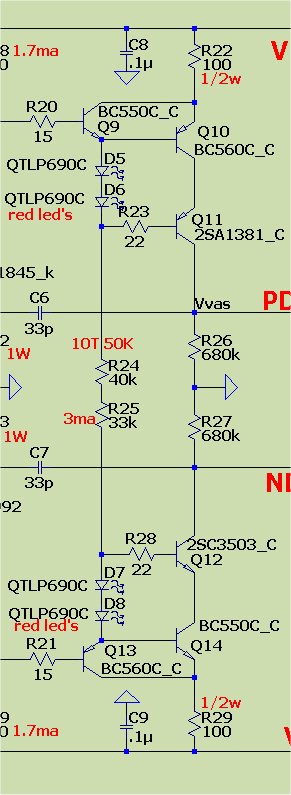

Nattawa , try the "exotic" VAS I just mentioned (below).
-self clamping
-beta enhancing
-ultra high Z
-Ivas trimmable (r24)
Superior to a Hawksford in EVERY way. You don't need
to bypass Re on the VAS to get sub PPM (below 2).
OS

Implementation of what is known as Boxall-Baxandall's (and some other authors) pair seems to be pretty tricky :
http://www.diyaudio.com/forums/solid-state/25172-baxandall-super-pair.html
They did not get too far , did they ? 😀
Quasi-sat of the BC550/560 as the super pair is the key to success.
Had it oscillate once with a very high OLG design , but it behaved
better than a Hawksford in that same design.
CLG and phase are stellar , drives an EF3 quite well. As with any cascoded
design , I would not drive LFET's or an EF2 directly with it.
(like so many horrible internet designs). 🙁
