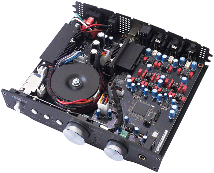

That's what I have planned.
As far as the RTA , it all comes down to what digital/analog environment it has.
Use this - (below) and trueRTA will have it's "grass" at -120db. It should
have the capability to accurately measure sub PPM.
I agree that most forum members are using typical 100$ internal cards. Not
really precision with a lot of variables that can not be avoided.

Looks nice. Have you seen any real measurements of your "planned" sound card?
Below noise floor of my old trusty Asus D2 internal PCI card.
