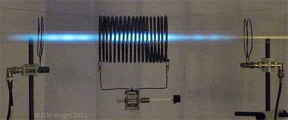

Output inductor is like a rail gun with it's field (field "shoots" out the ends) .
If it's parallel with a trace under/beside it , that trace becomes a "pickup".
Wow ! (below) An extreme example of a inductor field !
PS - would not want your input stage (or any other stage) in front of that !
OS
OS

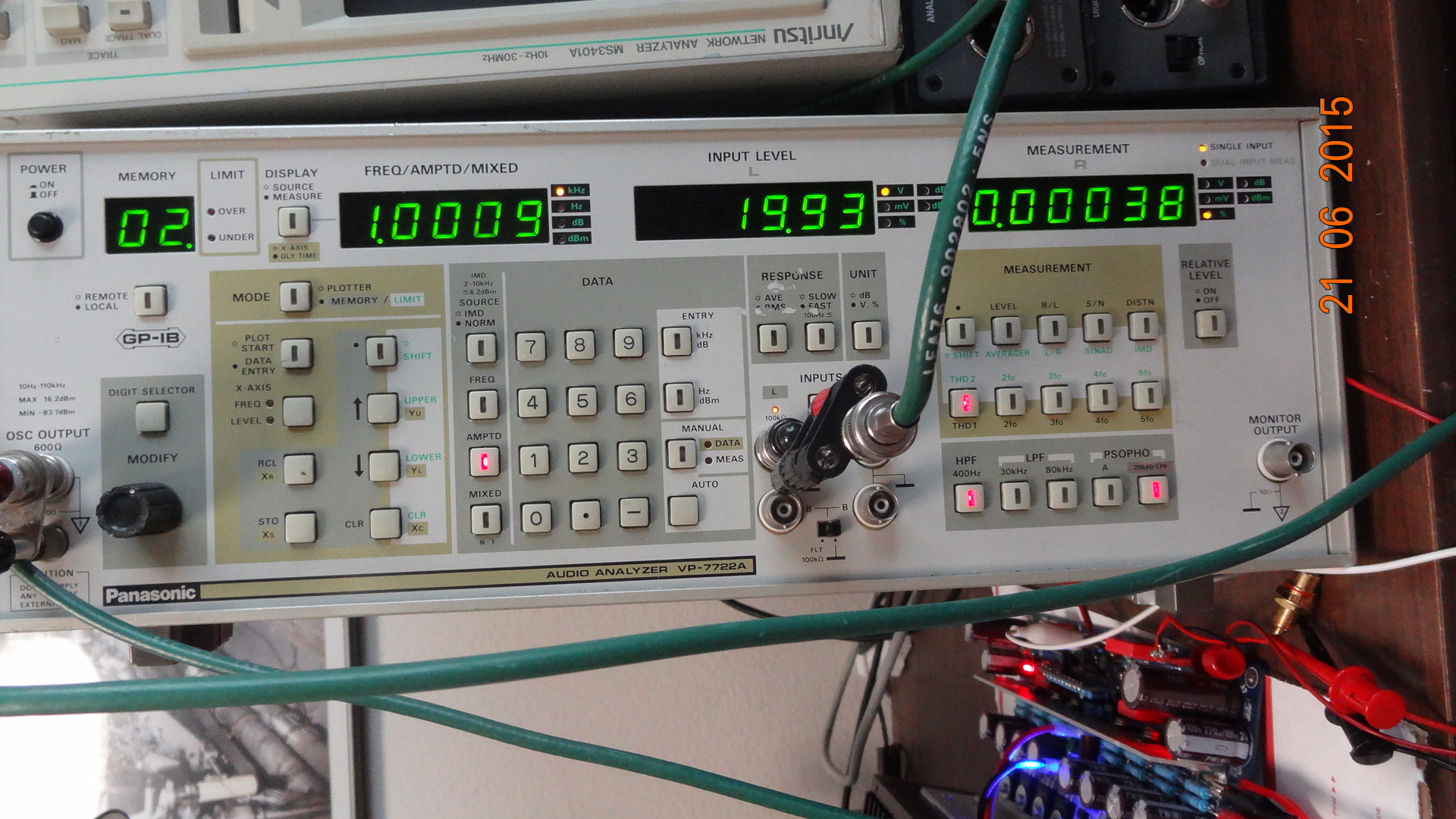

Any amp with thd below -100dB is going to be tricky with the layout. I can see changes (thd instrument monitoring thd in real-time) just moving the test setup wires..... grounds and spkr and input wires.
Here is 50W thd (1KHz/8 Ohm): .00038%
With short, well placed wires from/to PS and I/O wires, a true minimum thd may be found... but that requires a chassis, heat sinks PTransformer, caps/rect. I/O ports... in other words a prototype finished amp. That takes me a lot longer.
THx-RNmarsh
THx-RNmarsh

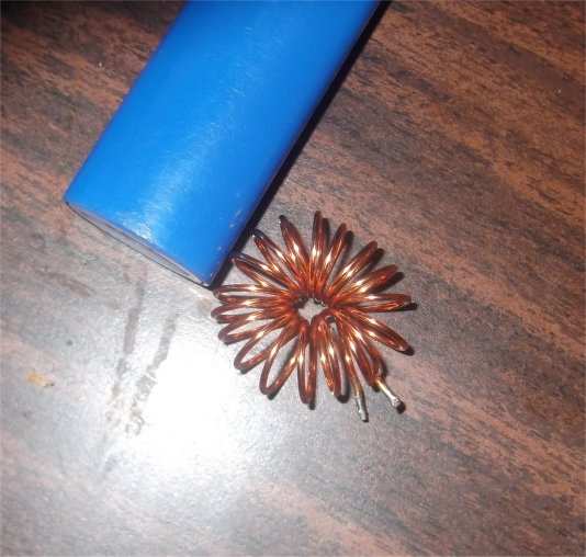

you can wind a air core toroid on a insulating former without any mag material - the numbers can be found in many online calculators
https://www.google.com/#q=toroidal+inductor+calculator
just enter u_r = 1
still some fringing field close in - but much reduced at distance vs cylindrical solenoid
just enter u_r = 1
just enter u_r = 1
Cool idea , JCX. Much more confined field. according to this - https://www.easycalculation.com/engineering/electrical/toroid-inductance-calculator.php
I could just take my standard straight16-18 turn coil , bend it to a toroid and still
have my <2uH inductance. Wonder if a toroidal air core would adversely
affect SQ ? Why is nobody doing it ?
THx-RNmarsh
I only do this when a remote coil is impractical. It costs significantly more.
with toroids you do get lower self resonance frequency from the added capacitance of the ends being closer together
should still be well above many power amp's Unity Loop Gain Intercept frequency where the cable load C decoupling is most useful
Just found a calc for that ! SRF is usually >100mhz for a 2uH .
Cool , two downloadable .exe standalone calcs. - Inductor Calculators
The toroid one just calculates for a ferrite core.
wiki says SRF for the toroid is just a tad lower than for a standard inductor.
The first calc is verbose (calculates the SRF).
Too expensive ... what ??? (below) I just made a 1uH in 10 seconds.
OS
Do you end up with the same number of turns or do you need to increase the turns to get the same inductance? What if you reduce the diameter of the turns with the toroidal winding, would it really make any measurable difference? I don't think we would have to worry about saturation in an open air core coil winding like that would we with so few windings?
