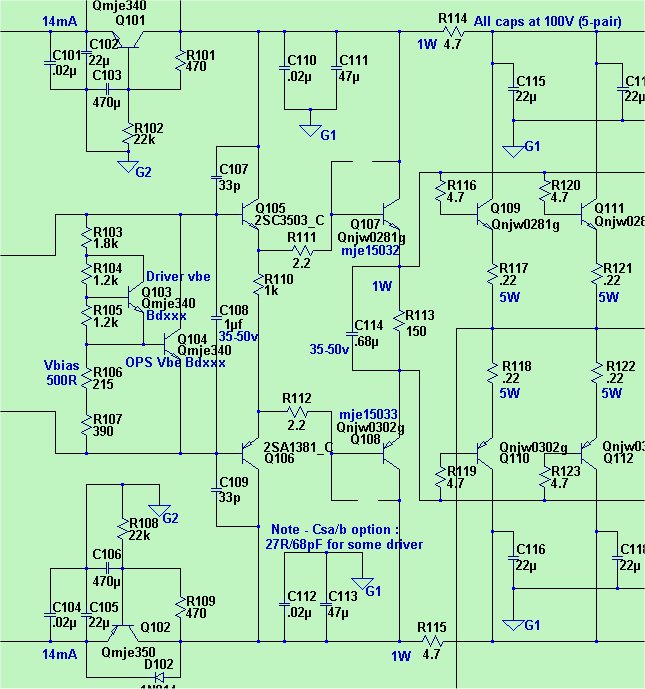

Re the EF2 vs EF3 discussion, I've settled on 100 W and below for EF2, but above this EF3. However, I do tend to run my VAS rich at typically 20 to 30'mA for the very reason that I want to keep any VAS current modulation due to output load as a small portion of the VAS standing current. I see many designs on the forum at 10 mA and below. In sims, I always look at distortion into a 2 ohms load ( yes 2 Ohms) which gives a good feel for how the amp is dealing with beta droop and VAS loading.
On an EF3 I think you can relax the VAS current a bit - but I would still run it at 15 to 20 mA.
I have had great success with EF3, and have to say the guidance in Bob's book on decoupling around the OPS, damping networks etc has worked very well - my e-Amp sounds fantastic to my ears and a lot of testing has confirmed there are no instability issues.
The NJL4281/4302 have a typical current gain of 100 at 5A, and the MJE340 driver transistor has a typical current gain of 70 at 50mA. That gives a total current gain of 7000, not 1000. For any other output transistors (and for strict worst-case design) I would be wary of using a double EF, but the new ONSemi ones have crazy current gain.
The heavier loading on the VAS is probably partly responsible for the higher HF THD in my design compared to some other Blameless type amps. I decided that I didn't really care if THD at high frequency and high power was 0.01% rather than 0.001%, but I did care about spending weeks chasing parasitics.
I didn't know about the diamond buffer triple at the time I built this, but I would certainly try it next time.
I use the ON's , too (for outputs).
I was like Carlo's- (DX) for while ... scared of the EF3.
Bob's idea of the 2 device Vbe is the ticket , both the Harmon/kardon "pricey" amps
use this (below 1) , and I do , too. NO issues.

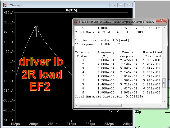

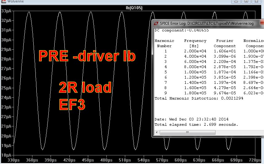

(Below 2/3 ) is the forums "badger amp" - EF2 compared to the EF3 (with a LIN).
Now you can run all your VAS's at 4-6ma - perfect for SMD voltage stages , as well.
PS - the EF3's current gain is > 50K !
OS
