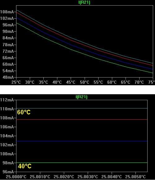

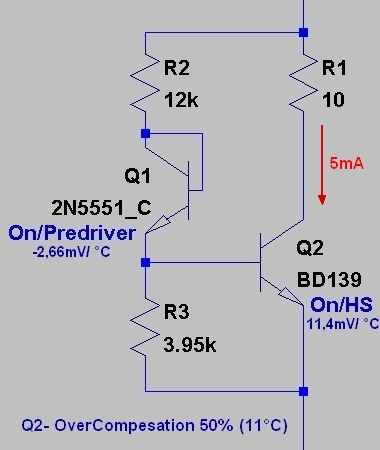

Note that with a Triple, one can also choose to mount the drivers on the main heat sink and keep the predrivers on the board with their own Vbe multiplier transistor (as part of a two-transistor bias spreader) and have that transistor mounted back-to-back with one of the predrivers (instead of using a heat spreader to mount the two predrivers and the Vbe multiplier). This assumes that the two predriver transistors are at about the same temperature. The extra heat sinking effect of the Vbe multiplier mounted to one of the predrivers will introduce a little bit of error into this assumption.
I used your tip, output transistors and drives the same heatsink, Predrives are in board with its own VBE multiplier.
Without compensation VBE in Predrives error is 20% for 10°C, with compensation error is of only 5% for 10°C which is reasonable for a simple circuit VBE multiplier.
Circuit VBE multiplier and simulation are attached, Thanks for the help.
The predriver Vbe multiplier transistors are not diode-connected transistors in what I described. They comprise a complete Vbe multiplier that is in series with the Vbe multiplier for the output transistors. I believe I covered this in my book. Works great.
In his book has several circuits VBE multiplier, but from what I've seen, none of them you write for use with 2 VBE sensor.
