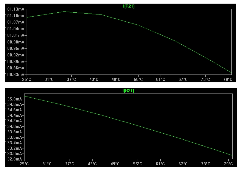

Bob, suppose you have designed your amp to operate at a temperature of 40°C and drivers in 45°C, but in summer, temperature internal rises 5° C, for all transistors 45° C and 50°C for drivers.
Simulating these temperatures in my circuit:
LTP 2,95mA-40°C, 3mA-45°C
VAS 4,44mA-40°C, 4,61mA-45°C
If not adjust the trimpot would take over bias, see the graph:

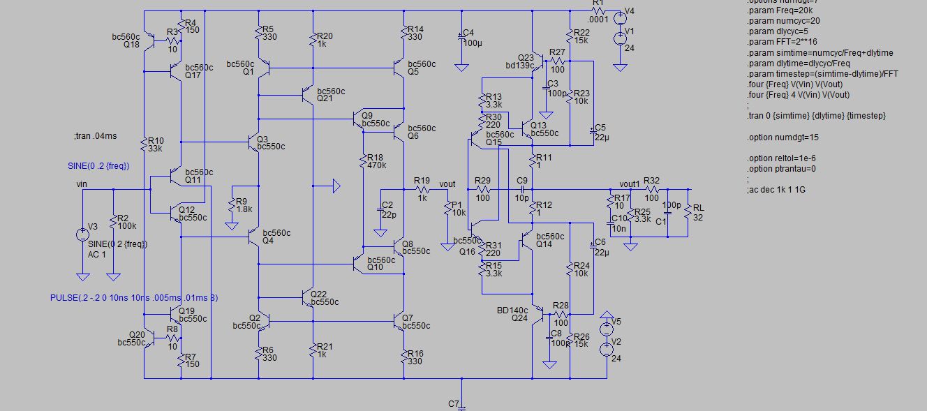

I suppose that what you call bufferd CM is what Cordell calls improved CM. My simulation does not support your claim about Wilson CM aganst improved CM. I simulated both in my GainWire preamp(current conveyor).
Improved CM at 11Vpp output (before output buffer) THD20k=0.000227%
Wilson CM at 11Vpp -''- THD20k=0.000308%
Can you post a link to the schematic?
In your circuit the current mirrors must be linear over a wide current range. The same is not true of a CM in astx's amp. Here the main distortion mechanism is CM output impedance.
Also, what about the 1K distortion figures? Output capacitance of a current mirror is doubled by CM action, unless you use a buffered CM where the buffer's Rm is << than that of one side of the CM.

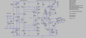

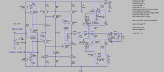

Here first improved CM, second Wilson CM
Damir

Normal mirror, same condition as before, THD20k= 0.000379%
Wilson mirror plus diode in series with the Q1, THD=0.000309% (same as without diode)
The comparison with the buffered CM is unfair because the output of the widlar is cascoded, whereas in astx's and in most other circuits it isn't. Remove the cascodes and then compare THD between the Wilson and buffered CM. I'm pretty sure the Wilson will outperform.
Same condition as before.
Ordinary CM THD20k=0.019543%
Improved CM THD20k=0.010530%
Wilson CM THD20k=0.021373%
Damir
Hi Rafael,
It looks like you may be missing the compensating effect of the Vbe multiplier transistor being mounted on the heat sink. If the room is hotter by 10C, then everything, including transistors and heatsinks, will be hotter by 10C, in principle. Then, if the thermal design and bias spreader are correctly implemented, bias should remain unchanged.
A good test for this is to put the entire amplifier in the oven and rig a couple of wires out so that you can monitor the quiescent output stage bias. Perhaps look at the voltage across RE of the output stage. Use 100-ohm probe isolating resistors at the attachment points to the output stage RE resistors so that if something goes wrong you wont smoke the amplifier.
Bob

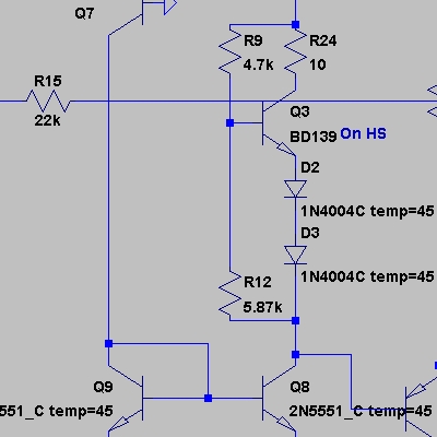

No, I'm not forgetting the transistor compensation the VBE multiplier, I do not know if you know this feature in spice, locking all transistors/diodes in a fixed temperature. I lock all transistors for the temperature internal of case, only the output transistors and transistor sensor VBE are unlocked.
I forgot to mention in the previous topic, in my circuit use a triple output (T), pre drives and drives will not in heatsink.
Doing some simulations, found that the culprits by changing the bias current is the change of VBE pre-drives and drives, an increase of only 5°C you will have an increase of 30% in bias current of output transistors.
The circuit in Figure is my VBE multiplier for a triple (T), as I am not using ThermalTrak the circuit set for over-compensating in 10°C (40%), this difference in temperature between the transistor output and monitor VBE mounted on heatsink, this according to book D.Self (3 edition).

Hi Rafael,
I was not aware of this temperature locking feature in SPICE. Thanks for bringing it to my attention.
As we all know, 3EF Triples tend to be more difficult to temperature stabilize because there are a total of 6 junction drops effectively in series. One of my favorite approaches is to use two transistors in the bias spreader. One on the heatsink and one on a board-mounted heat spreader bar onto which are also mounted the pre-drivers and drivers.
Bob
