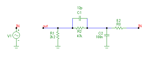

Cherry's FB network

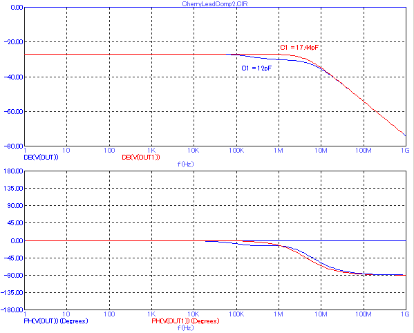

Hi David,
It's just the opposite. It provides some lag compensation. See pic.
Hi Wahab,
With a constant frequency FB ratio, the phase will also be constant (except in case of an all-pass filter, of course. But this is not an all-pass filter).
What we see is some lag compensation, due to paralleling of R1 with C1 and C2 in series.
BTW, the value of C1 is a bit too small. Actually, it should be 17.4pF for equal time constants (see red curve)
Anyhow, I don't understand the rationales behind this FB network. Besides, it might introduce a little bit extra distortion, as distortion free caps of 100nF are hard to get and expensive.
E.

Hi David,
Hi Edmond ,
The 12pF cap will in principle act as a high pass network whose effect
should be reciprocal of the zobel network and hence provide a frequency
constant feedback ratio but it will also provide inherently a phase lead
compensation.
Hi Wahab,
E.

Agree that the rational of such a design Escapes me as well
but Cherry must have his reasons...
As you pointed it the cap value is sub optimal and i also
find a nearby value , 18-22pF, as being more adequate ,
simulation done with a whole amplifier schematic.
