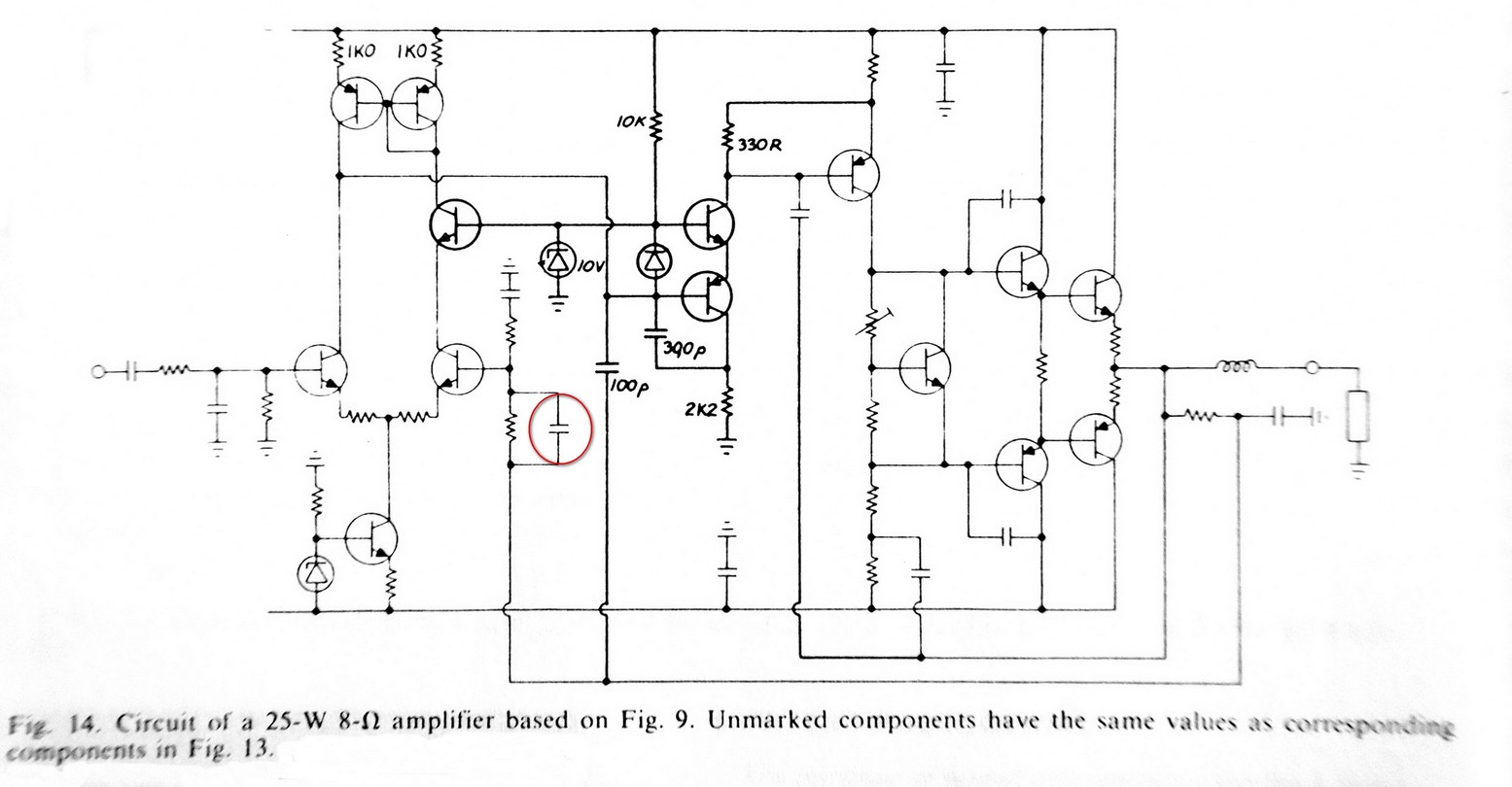

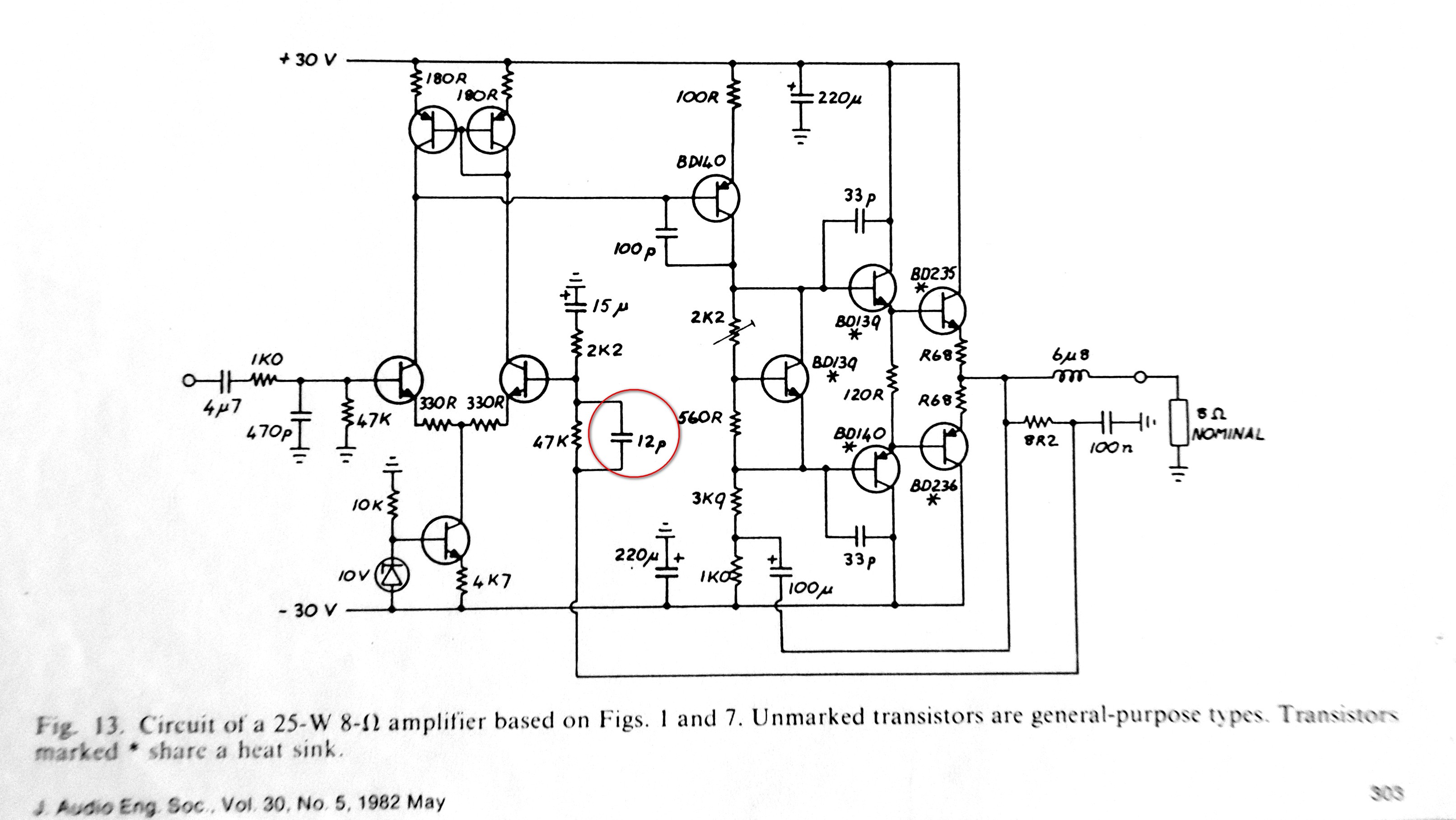

Hey guys, are you talking about the red encircled 12pF cap as shown below?
edit: or the cap in the next picture.

... the red encircled 12pF cap as shown below?
Yes. "a...small capacitor in the overall feedback network B can be used to correct the group delay and improve the reproduction of transient waveforms"

Hi David,
Okay, that cap. This one is not connected to the output. Instead, it is connected to the Zobel cap. As a result, it doesn't provide any lead compensation. So no fear for extra HF ingress. Same story as outlined in post 2809. The two circuits from my website behaves exactly the same. (and please, ignore what Mr Troll said about it. He doesn't know what he's talking about)

Hi David,
It is connected to Zobel cap but I think that Cherry's quote implies it still provides some lead. Not sure this is relevant to my question anyway since I am interested in the extent of EMI in a more conventionally connected amplifier.
Hi Edmond ,
It is obvious that the feedback path going through a shunt RC network
will result in non linear frequency response past the said RC -3db frequency ,
and will result in a peaking at about 600Khz with the values in your schematic.
The 12pF cap will in principle act as a high pass network whose effect
should be reciprocal of the zobel network and hence provide a frequency
constant feedback ratio but it will also provide inherently a phase lead
compensation.
