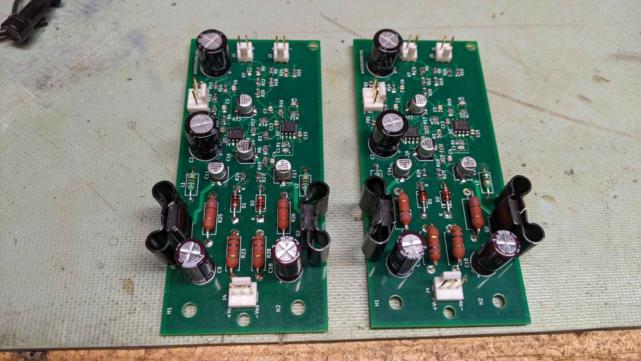

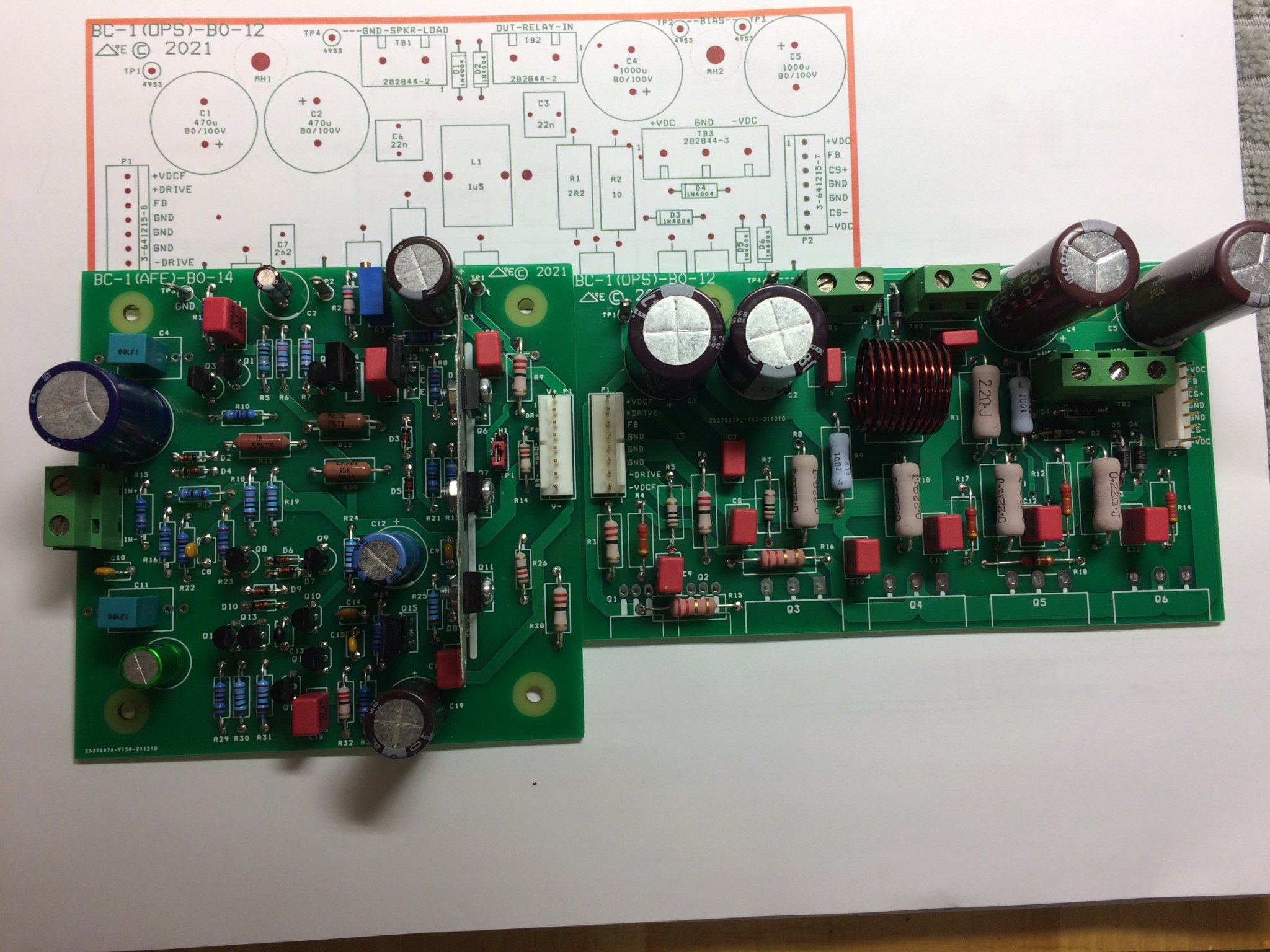

I would imagine for flexibility of placement. A single PCB for this would limit construction options.No, I mean why the BC1 is divided into 2 pcbs.
https://www.diyaudio.com/community/attachments/bc-1-assembled-pcbs-2-jpg.1086035/
For AFE & OPS, its because, that is the way Bob wanted it to be done. He also wanted them to be mirror imaged too.No, I mean why the BC1 is divided into 2 pcbs
Actually he wanted all three on the same Heatsink, AFE, OPS and Protection, it wouldn't fit on the 300mm HS
There are pros and cons to this arrangement

BC-1 is the same as Fig.3-13 in the 1sr edition, with all the "finesse" parts added (base-stops for output devices, better bias reg, etc). In the demo version the amp is the usual asymmetric input stage with current-mirror, feeding an EF-improved TIS, then an EF3 with 4-poairs of output devices. This is the high-power PA that the design evolution ends with after the incremental improvements have been added to the basic design. Truly, Ch.3 of the 1st ed (which seems toi be Ch.4 of the 2nd?) is probably the best demonstration of how to go from a very common and lack-luster circuit to one that has highly respectable performance, while explaining what each improvement does. Kidos to Bob !!
Looks good Zoji6645, worth all the effort and $?
Yes it was. Additionally - it kept me off the streets!
With my transformer - which is an ancient IPL toriod. I got 174W/chan, both chan. driven into 8ohms. 264W/chan both chan driven into 4ohms. Single channel driven 4 ohms, 350W. Single, 8ohm, 200W. 120VAC power input controlled by variac.

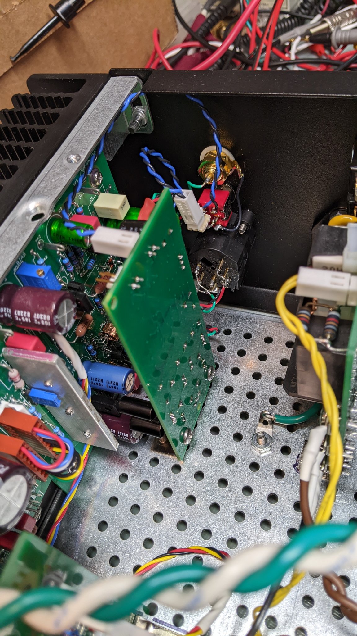

I designed and made pcbs of a low noise differential input circuit, inspired by Self. I can sell you a couple of blank pcbs if you're interested. BTL mode was realized by 'mis-wiring' one channel's input cable.Hi Zoji, what method / input board did you use to run it in BTL

I am looking at self's balanced input also but I will likely need to design my own pcb to suit the case and layout I am using....
