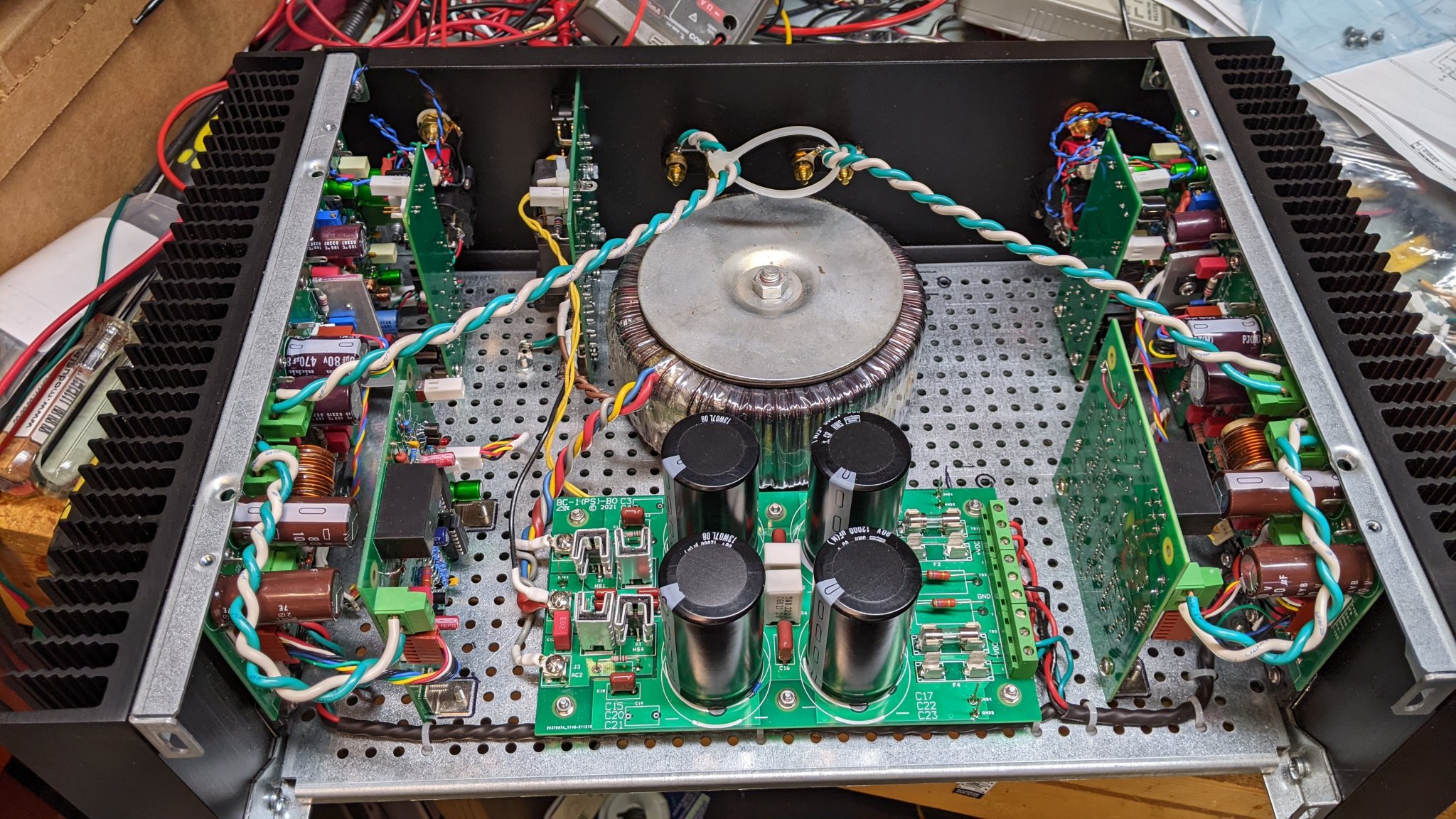

Well we are finally there with a few builds complete and a few BC-1 still being built and beta tested by two members that have taken on the challenge. They been given a set of pcbs to build and review the documentation.
It’s been a while I have forgotten but we will eventually make the design available. I won’t be giving out the fab data but we can make arrangements offline if you like to take it on. I’ll have to order more pcbs since I am all out of the first batch.

Rick: Looks like that someone is you!
