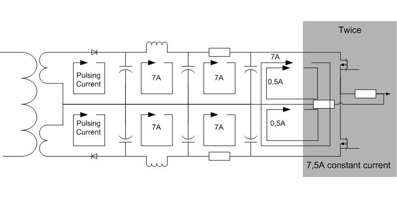

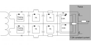

Hi all!
I have been following this thread with interest, because it came up just as I was designing the grounding for my new amp. 🙂
To sum a few of the points up that I absorbed (I am sure I missed plenty of the details):
1. Check the current loops, and make sure they have clear paths (hence no diodes in the ground connection to the transformer)
2. Try to avoid multiple currents to one wire, because they will influence each-other.
3. (not really mentioned) try to make stars. Loops pick up radiation much easier.
4. When connecting to chassis earth, do this on a point where current total is zero.
5. The current coming through the diode bridge is high, with a pulsing character. (EMC!) Keep separate from all other signals.
So, I am building an Aleph-X. This is a Class A amp, which makes things a lot easier, as current has a continious character. The design amplifies separate + and - signals to which the speaker is connected. So the speaker is not grounded, but is floating. (two resistors to earth keep it from floating too far from ground)
I made a schematic about the main currents. In the following post I will present my solution for the grounding paths.
Greetings, Harry

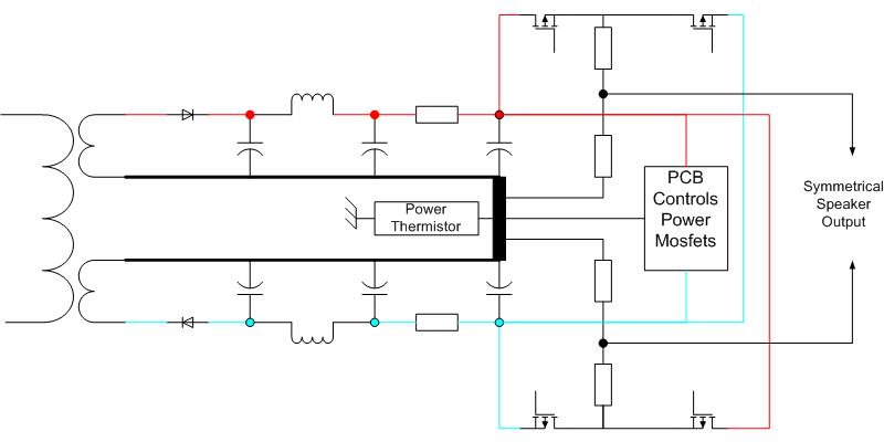

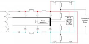

Part two: my solution.
The solution is why I want to have the opinion of this group, as it does not comply to most of the designs showed.
I do not presume to present the correct solution. But I would like to know is I made an error in my reasoning.
Most currents flow from the last positive capacitor to the last negative capacitor. Twice a 7A constant current that is biasing the mosfets. The PCB only takes 40 mA constant current, also between + and -.
The speaker is grounded with two resistors, these generate a maximum of 0,5A from + or - to ground.
The other currents are just feeding the last capacitors.
So, when I try to use the rules from the previous post, I end up not with a star point at the "center tap" of the transformer, but between the last two caps!
The other solution I could think of was running a lot of wires from each capacitor to the central tap, but still the two 7A currents that bias the mosfets have to go from ground capacitor- to ground capacitor +.
Did I make an error in my reasoning? Or is this a good design? 😕
Greetings, Harry

Re: Actual example
Hi Harry,
Grounding is like religion, and five engineers will give you at least six different solutions. My view is this: Star grounding is good, but don't feel compelled to follow it religiously. When I think it is appropriate, I do star-on-star grounding, where a local star will close some current loops locally. Just remember to understand the nature of the current flowing in every wire, and what voltage drops it may be causing, and what those voltage drops may be doing to affected circuits.
Bob

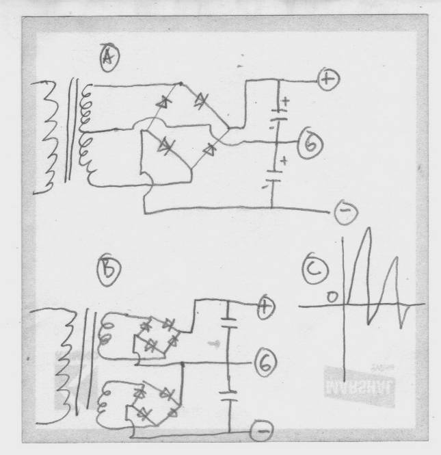

Thanks, Babowana.
Here's my Question of the Day for you guys:
There are two popular ways of connecting the transformer-rectifier-reservoir capacitors to provide the pos and neg rails for a power amplifier. In the first, a center-tapped transformer has its center tap grounded, and its two arms go to the a.c. inputs of a single bridge rectifier, whose + and - outputs go to a pair of reservoir capacitors whose common node goes to ground. This is the most common and popular setup.
In the second, a transformer with two isolated secondaries is used (no center tap). Each secondary goes to a bridge rectifier. The pos and neg outputs of each bridge connect to a reservoir capacitor. The two reservoir capacitors then share a common node connected to ground.
Some claim that the second approach, which uses two bridge rectifiers, is superior. However, I have never seen a clear explanation of why it is superior. Indeed, the second arrangement appears to suffer an extra diode drop in the rectification process.
Is the second approach superior?
If so, why?
What are the tradeoffs?
Bob

Hi, Bob,
I'm not EE, but I try to answer your "Question of The Day" 😀
First, is it right that the first case is A and second case is B?
If it is right, then it makes sense if B is better (not perfect, but better than A).
I've looked at osciloscope that music signal sometimes is like drawing C, where positive half and negative half are not the same magnitude. Let's consider an instance of the positive half.
In the case of positive half, the energy will flow from positive rail to the speaker to the ground. This will cause a "dip" in the positive rail.
In the case of A, if the positive dips, then the negative supply will also dip, because of the flux in the transformer will decrease wholy, making all +rail and -rail dips because of positive load to the speaker (then to the ground). This seems "not fair" for the negative rail, because the load is happening to the positive part (none is in the negative side), but making the negative rail dips.
This happens because the positive part-the ground-and the negative part is actually all 1 wire from top to bottom (like auto-transformer). If the "positive to ground" part is loaded, the "ground to negative" part will be disturbed much because of this "1 wire" system.
In the case of B, the negative dip (because of positive load) will be less, because it comes from fully different secondary winding. The effect is from less magnetic flux only, but none from "1 wire" system effect.
I said it is not perfect, because the better one is 1 transformer (+rectifier+cap bank) for positive rail and another transformer (+rectifier+cap bank) for negative rail. This way if positive load occurs, the negative side will not be affected (as long as the input electricity to the primary is not dropping voltage).
This also depends on the PSRR of the amp itself. The better the PSRR (especially for higher frequencies), less of this effect will be.
Like example above, if the PSRR of the amp is bad, if there is a negative dip because of positive load, it will still enters the differential system from the negative rail, even though the load is positive. This negative supply ripple still enters the system, not only the positive supply ripple.

lumanauw said:
.....In the case of B, the negative dip (because of positive load) will be less, because it comes from fully different secondary winding. The effect is from less magnetic flux only, but none from "1 wire" system effect....
Lumanauw,
this is unfortunately completley wrong, the drawings of two diffrent rectifier scheme with or without a common center tap you provided is just cheating your eyes, at least that's not the way transformers should work.
The magnetic coupling in the transformer should normally be highest possible else it would be a lousy transformer if else for a special purpose(especially in SMPS technics) we would want some stray inductance (= looser magnetic coupling), so what happens in one winding will always be seen in other windings despite being completely galvanically isolated due to the magnetc coupling.
Cheers Michael

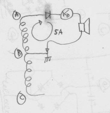

lumanauw said:The cheaper one (worse) is (B) where 0-110V-220V is all "1 wire" system
Commonly known as an Autotransformer. 😉

Bob, i see no advantage in using 2 bridge rectifiers, in the contrary, additionally to the doubled diode drop you also get double the diode ringing... In my opinion, 2nd approach is better to sell because more devices need to be better...
Some tell that 2 bridges would half power dissipation on the diodes, but obviously they have no clue what they are talking about.

Hi, Michael,
You're right. The magnetic flux drop off between Bob's A-case and B-case will be the same.
But this is what I'm thinking about. CT power supply system is like autotransformer, from A to B to C is actually 1 wire.
In case of positive load, the current will be flowing from A to diode(+cap bank) to output transistors to speakers, and then returned to ground (a.k.a CT). There will be current circulating between point A to speaker to point B (eg=5A).
Because A-B-C is actually 1 wire, do you think current circulation of A-B will not affect B-C at all? If we make A-B and B-C are 2 secondaries, it will separated loops, thus the only thing that makes negative supply ripple is only the magnetic flux drop-off inside the transformer, but none from the "autotransformer" effect.
If I borrow NP's term, if there is any "Blip" happening in the loop of A-B, it will enter B-C because A-B-C is actually 1 wire.

Bob Cordell said:
Thanks, Babowana.
If so, why?
Bob
This subject has been covered before both on this forum and I believe I remember seeing an article in TAA about it. Don't have time to search details right now, but the issues for "Case B" involved no ground return path through the transformer. This would seem to benefit the small loop approach discussed earlier. Also, each winding is fully used for each polarity of charge, instead of half of a (CT) winding. This was said to provide friendlier flux issues in the transformer core.
Hi Lumanauw,
ok, but it doesn't make any differences to speak of, the 1~ transformer have always just one magnetic field which all windings share together.
Irrespective of wethere two windings are coupled in series or not there's no difference, you will see the "blip" at every winding if it occures in one winding, the "blip" is coupled through the magnetic field.
Cheers Michael
Cheers Michael

I have never seen rational grounds for this either.
Good thing you brought it up; perhaps someone will come up with a good explanation.
Bob Cordell said:Some claim that the second approach, which uses two bridge rectifiers, is superior.
Bob
