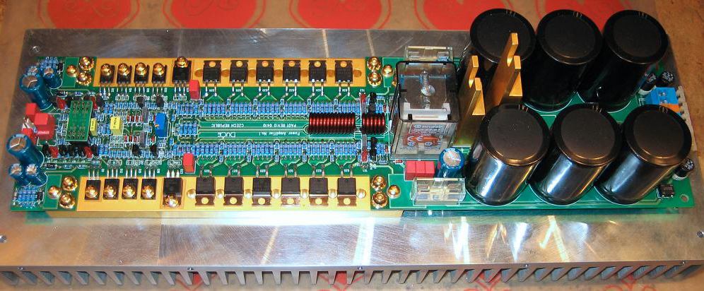

Let's see, you want the star point at the amp itself? I actually missed that you had drawn the local decoupling to the star point in your diagram. In that case, yes, you must probably have the star point at the amp. However, I think the more usual solution is to connect the local OPS decoupling to the load return at the amp, rather than directly to the star point. In that case the star point can be located where I suggested. This comes back to the previous discussion on taking everything to the star point or closing some loops locally.
lm3875 with bigger ps-caps:
le monstre with substitute-parts:
ksa-50 with integrated output-stage and 4x10.000 uF ps-caps.
Made to fit particular heatsink.
Note: in my opinion there are serious flaws in these designs, some of them are clear to me now thanks to this thread and this forum.
Only amp that i actually got built using my own pcb's is the le monstre.
Klaas
Klaas
