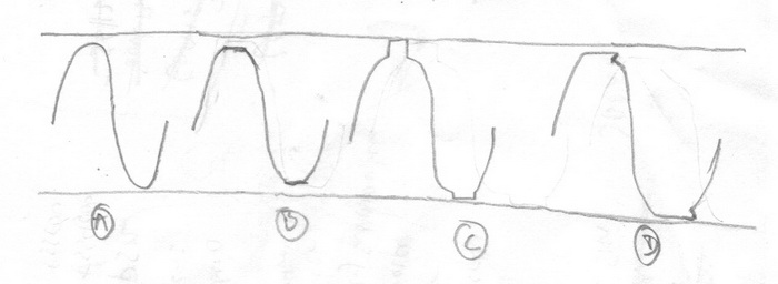

I got something from my recent experiment. I make an experiment on overcurrent detection (voltage accross RE). With ordinary music with 4ohm speaker, it trips. With test tone to 4ohm dummy load it doesn't. Single pair output transistors.
John Curl suggested about the importance of high current capability of output stage. About speaker impedance dropping somewhere to very low ohm, for very short time. It don't show up with test tone+dummy resistor load.
I narrowed the suspicion about feedback sound to 2 points. 1 is crossover distortion+output current capability of output stage. 2 is about clipping behavior. Square waves (where inherently have high order components involved in global feedback=nasty. The more clipping, the more front end pushes). I really suspect these 2 factors makes the feedback sound. I compared test tone, pure sinusoidal, pure square wave, clipped sinusoidal. The clipped and square wave has exactly the same sound as the fatiguing sound.

This is what I can see on scope, about the difference between feedback and non global feedback amp.
A is the wanted sinusoidal from an amp reproduction.
B is the waveform from non-global negative feedback amp near rail voltages. It flatten a bit below the supply rail. If the gain raised from this point, it forms trapezoidal and square wave, with normal chopped edges.
C is the behavior of a global feedback amp. No baker clamp or anti clipping installed. Near voltage rails, suddenly there are "sticking", making square waves. Or, it can make D, trapezoidal with extended edges/spikes on edges.
If the gain raised from this point, it makes trapezoidal to square wave with sharp edges (unlike B).
B and D are different. On the flat section (clipped signal), B is natural (only chopped), while D have additional spikes besides chopping.
While in scope viewing it makes a little difference, in FFT analysis (using 192/24 soundcard), the difference is quite large. D exhibit much more high harmonic content than B. I think this is because of global feedback.
If the output stage cannot provide sufficient current (to real loudspeaker load, which demands more current than dummy resistive load, like JPV said above), or have no clipping management involved, the sound from that particular amp will be harsh.
