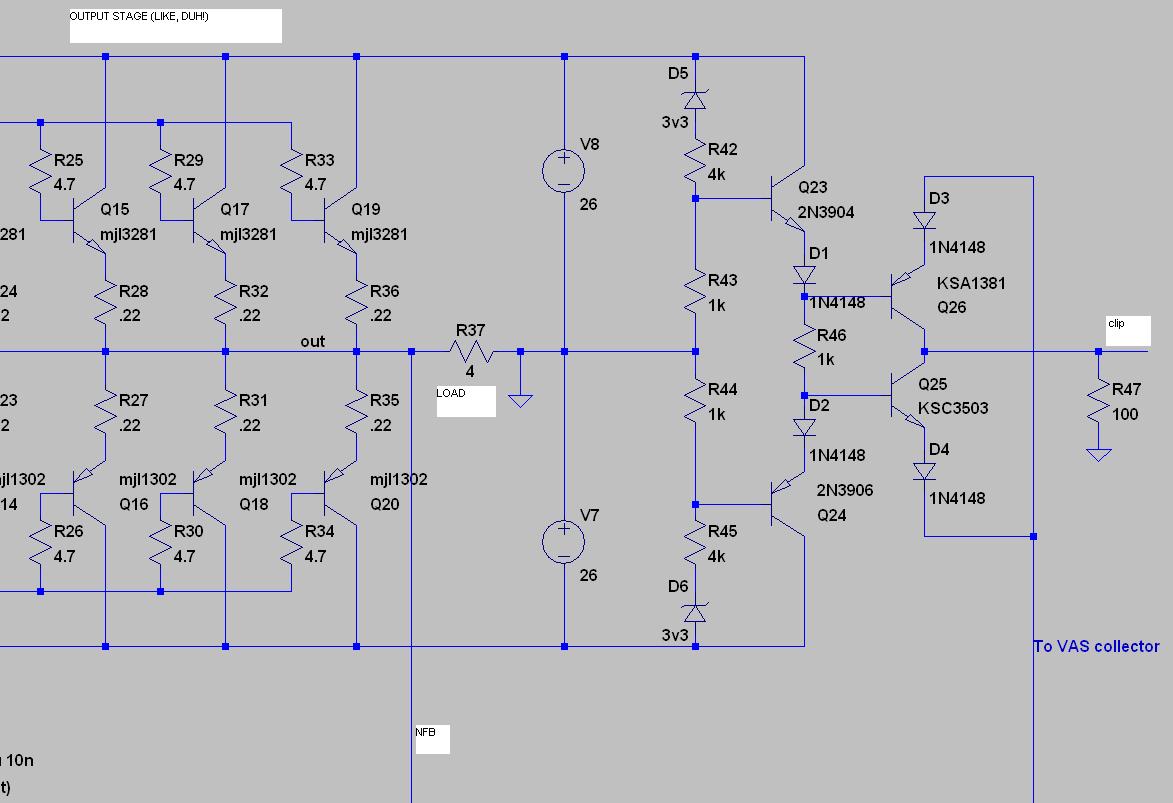

VAS clamp for OPS with voltage gain
Reviving the previous discussion on VAS clipping and nfb clamps.
Here is what I have come up with as a VAS clamp for one of my current designs, which has a current feedback output stage configured with a voltage gain of 5.
The circuit tracks the supply rails for the power output devices and prevents the VAS collector voltage (of the front-end) from overdriving the CFB OPS.
The circuit is pretty self explanatory; the 4k and 1k resistors are proportioned to give a /5 ratio (which is equal to the voltage gain of the OPS).
The collectors of the clamp transistors (which are returned to ground via the 100R resistor) can be utilised in a clipping indicator circuit, or the 100R resistor can be removed to use the circuit as a nfb clamp.

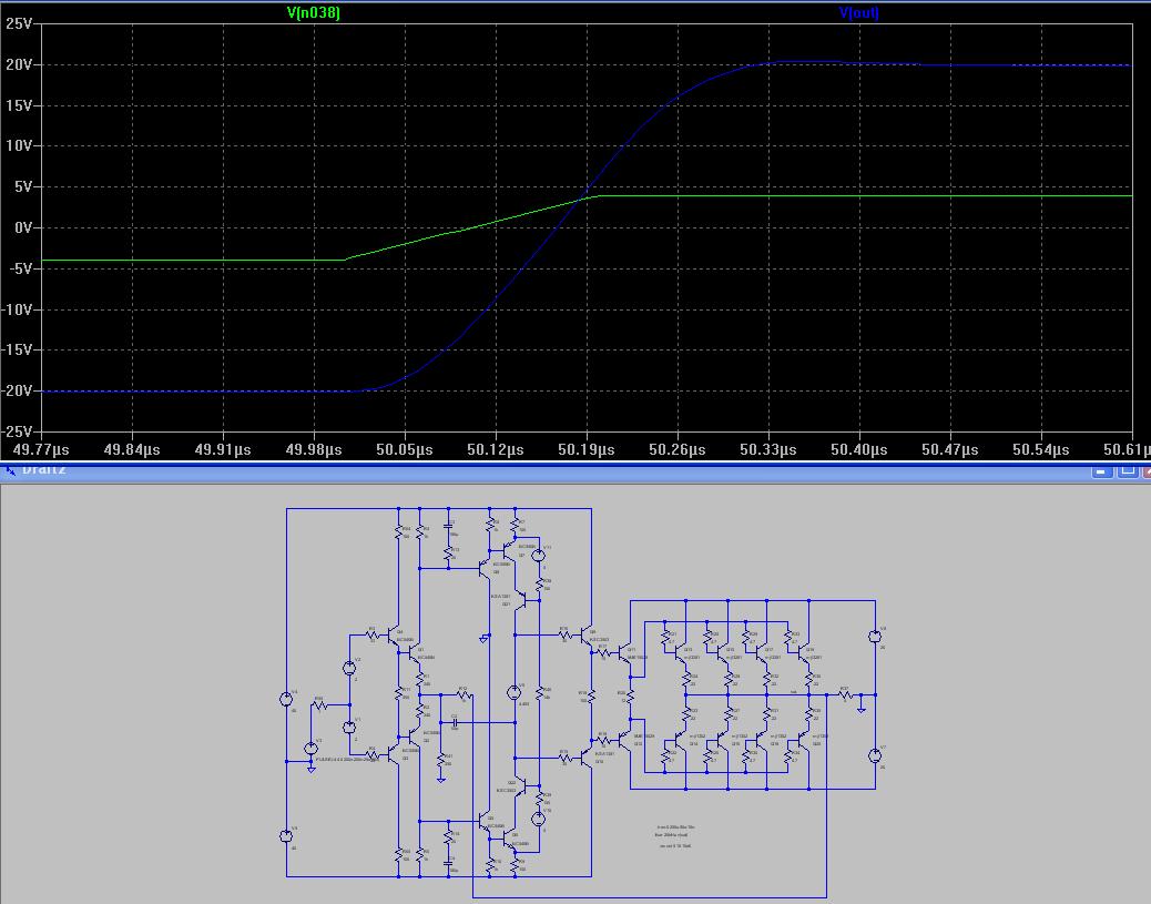

The waveform diagram shows the end result. The green trace is the output voltage, the blue trace is the VAS collector voltage (of the front-end / which is the CFB OPS input voltage) and the red and cyan traces are the output transistor rail voltages.

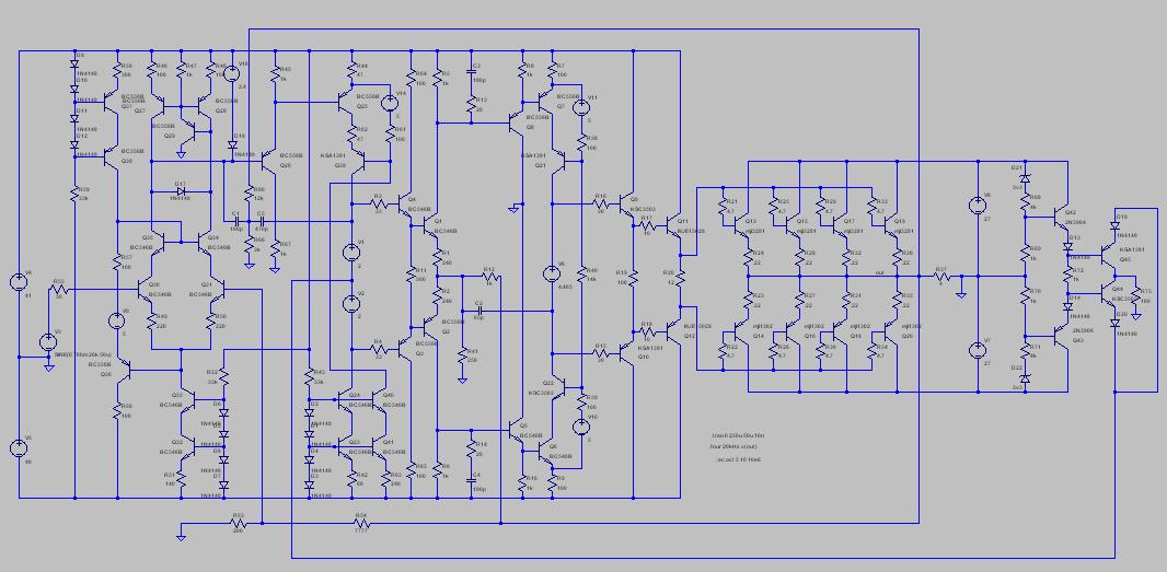

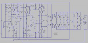

Oh, and here is the complete amp (minus supply rail filtering / OPS over current protection) just to show the complete topology.
Hi Glen,
Very interesting! Thanks for posting it. I've got a couple of questions.
1) I think one of your earlier posts showed the Miller comp of the output stage having two capacitors, each one going to an emitter of its corresponding transistor in the CFB arrangement (can't see the reference designators). Now you've got a single one going to the junction of the resistors that connect the emitters. Were you just trying to reduce parts count, or was there something more subtle going on there?
2) The global compensation is interesting - looks like some combination of TPC and TMC? Given that the output stage has gain, I guess there's some "magic ratio" of the resistors in this network?

magic ratio?
Hi Glen,
[snip]
Thanks.
Hi Andy,
As usual the component values are unintelligible, but IF these two resistors have the same ratio as the ones that define the gain of the OPS (1:4) then it's simply TMC.
Edmond.

Hi Andy.
I just posted that overall schematic to give an idea of the topology. I have not fully build and tested the whole thing yet. I only really wanted to show the "brute force" (non-nfb) VAS clamp here.

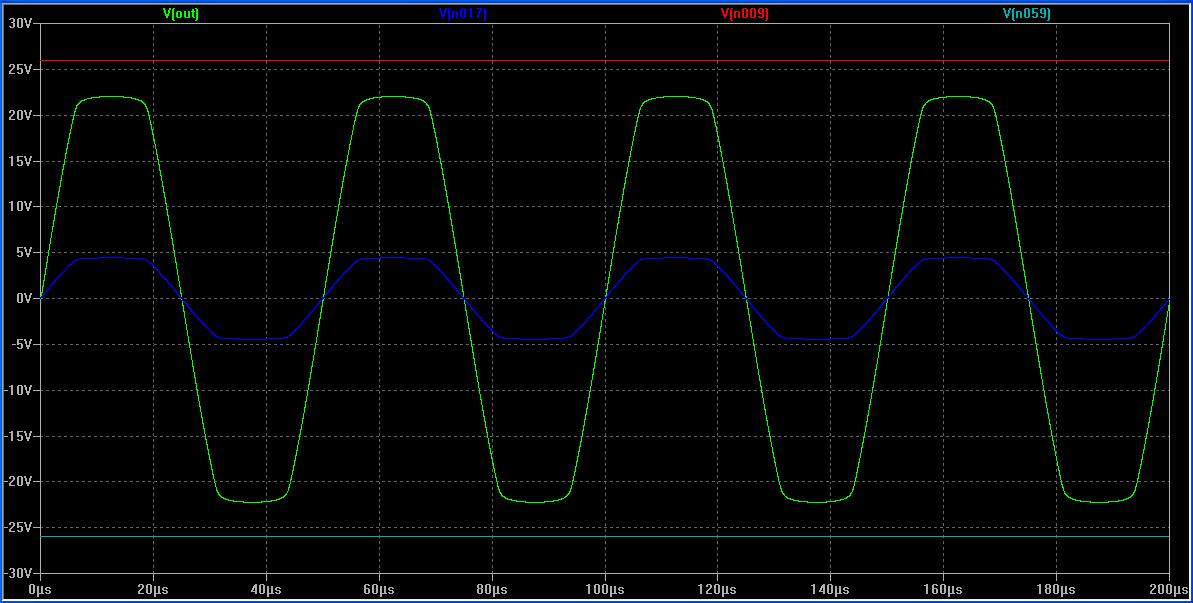

1) I've found the single compensation cap in the CFB OPS to work just as well as too caps, so I went with the simpler one. The OPS has a really good transient response (see attached pic).
2) I am using TPC in this amp; that global compensation network was just a TMC experiment (the TMC feedback resistance just takes the form of a 1/5 voltage divider to compensate for the gain the the CFB OPS. I'm doing the OPS PCB with privision for TMC or TPC in the CFB OPS as well; this isn't shown in that simplified schematic either.
I should also mention that that waveform diagram I posted (of the clamp operation) was just the CFB OPS alone (driven with a voltage source with a 500R series resistor. The complete amp has about 800ns of sticking when clipping.
