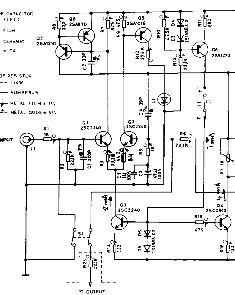

I've not tried this one, but it is one example:
http://sound.westhost.com/project57.htm#top
Bob's suggestion of what is essentially a null test is good also but you have to compensate for the amp transfer function. Here it is:
http://sound.westhost.com/sim.htm
I agree that any of these should have a one shot, to provide a long enough pulse to the LED so that it is visible.
The Adcom GFA-555 I think it is has a very simple circuit around the VAS as a clipping indicator, don't remember the details.
Pete B.
mikeks said:However, if the intention is to monitor the input error voltage (red trace) for unusually large spikes, then, as Bob has pointed out, this may be a workable approach.
Did you notice the blip in both the red and blue traces at the end of the clipping period on the positive output waveform but not the negative. Have you expanded that blip along the time scale? I'd expect that it looks like ringing from what I've seen in simulation.
Pete B.
Hi Pete,
-Chris
Right you are, sort of. It's triggered right in the diff pair. The collector of Q2 draws enough current to trigger Q5 and light L1. See attached schematic. It's assumed for an AC signal, a DC fault in the wrong polarity would not light the lamp. Close enough for rock 'n roll!The Adcom GFA-555 I think it is has a very simple circuit around the VAS as a clipping indicator, don't remember the details.
