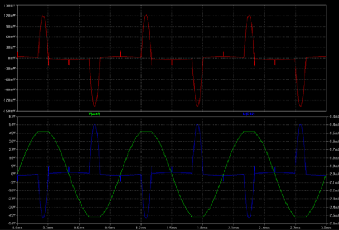

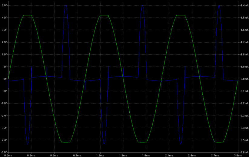

Hi Chris,
This is an undoubtedly an excellent way of establishing if the first stage is in current clip.
But the amp. may be driven to voltage clip at its output, without causing the former:
Blue trace: Current in one of diff stage BJTsm (tail-current~4mA).
Green trace: Output voltage.
In other words, this approach will not detect clipping at the output, and is, therefore, fundamentally flawed.

mikeks said:However, if the intention is to monitor the input error voltage (red trace) for unusually large spikes, then, as Bob has pointed out, this may be a workable approach.
Mike, your simulations are both showing that it is easy to detect output clipping from those input waveforms.
You might notice a very low amplitude sinewave shape of about 10 mV amplitude in the red trace, until the clipping starts, then the large (>100mV peak) half sine looking peaks are seen. This is the input stage trying, and failing to correct for the clipping. Similar half sine peaks can be seen in the current waveform.
Note the small blips aligned with the output zero crossing which are the input stage correcting for crossover distortion.
If you reduce the input level until there is no clipping I'd expect that you'll see a clean ~10mV sine, with blips at the zero crossings.
Comparing the input differential voltage, or current to a threshold value does work.
Pete B.
Pete B.
You're right about the input error voltage-i misunderstood Chris.
As for the current peaks, you may have a point: after all an anomalous increase in error voltage must necessarily lead to an accompanying increase in current in one or other of the Diff. stage BJTs.
Any concrete ideas in respect of circuitry?
