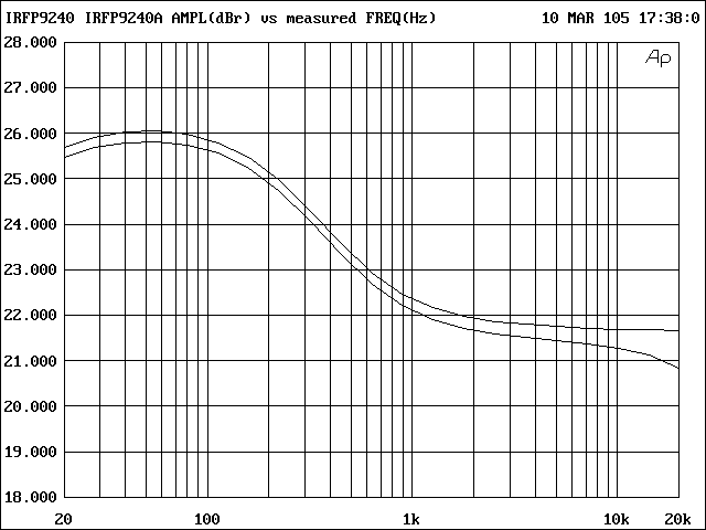

Nelson Pass said:Interestingly, the higher distortion is at mid-band, declining
somewhat toward the top end.
Hi Nelson,
Actually, that seems to make sense, as the "effect" in the P-channel IR devices appears to cause a transition in gm in the frequency range between a few hundred and a few thousand Hz.
Bob
Magura said:Does that hold true for the IR devices as well ?
Only the IR P channel. IRF9XXX devices from other manufacturers
have not exhibited this, which iswhy Harris or Fairchild are
recommended for CS applications.
Bob Cordell said:Actually, that seems to make sense, as the "effect" in the P-channel IR devices appears to cause a transition in gm in the frequency range between a few hundred and a few thousand Hz.
Yes, it's consistent with about a 4 dB shelf from 100 to 1 KHz.
Just as interesting, in the complementary followers I described
the distortion rises about 5 dB from 100 to 1 KHz, and then
declines as you go up to 4 KHz, returning to close to the
low frequency value. I haven't looked into the details of that,
but possibly with the phase shift the 2nd harmonics are not
cancelling well under transition.
I consider this artifact minor in Follower applications, and
comparisons to the Fairchild / Harris parts has not shown an
audible degradation.
When I looked at this awhile ago, my guess was that the "true" gm of the device was the upper frequency part of the shelf (i.e., lower gm), and that the higher gm at dc and low frequencies was possibly from some kind of parasitic charge injection that enhanced the gm somewhat at low frequencies and dc. I seem to recall doing some experiment to try to see which was the "real" gm, and at some point discarded the notion that it was some kind of LF effect that degraded gm at higher frequencies. Either effect is likely to be somewhat nonlinear, so it is not hard to believe that distortion would be created at frequencies where the effect is "in play".
I never got a satisfactory answer from IR in response to my inquiries.
If my speculation about the effect were true, then the true "dynamic" gm of the P-channel device would be less than we think. I can't say that I am comfortable with drawing that conclusion. I have not looked at any of the Fairchild P-channel devices. If you try to compare apples to apples between the IR and Fairchild devices, does the Fairchild device gm look more like that of the IR device at high frequencies or low fequencies?
Bob
Bob Cordell said:If you try to compare apples to apples between the IR and Fairchild devices, does the Fairchild device gm look more like that of the IR device at high frequencies or low fequencies?
I only recall that the Harris and Fairchild had a flat transconductance
across the audio band - I failed to note the absolute values.
However, I can infer from examination of the data sheets
that if you assume the IR data to have been taken at lower
frequencies, we get agreement at 2.5 S from my test conditions.
The Fairchild equivalent has a slightly higher number at 3 S.
Above midband the IR figure is 1.6 S.
I conclude that we are probably looking at a drop off from spec.
