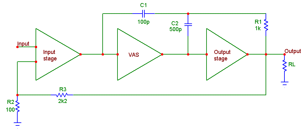

Also, it depends on proved "prior art". Now, I'm getting more serious. Let's look, for example, at my claim that "Transitional Miller Compensation" (TMC, see picture) markedly reduce the distortion. Quite a few people (not you Bob) are not convinced, because I never build it. The point is that 99.999% of a TMC amp has already been built and tested by others, that is, D. Self has measured that a two pole compensation does improve thd and E. M. Cherry has demonstrated a comparable improvement, by including the output stage inside the Miller loop. TMC is just a subtle variant on these two techniques and combines the advantages of both of them without the disadvantages. So, there is no need questioning the validity of my claim, which is only based on a simulation, and I have no intention to build the thing, just to satisfy the unbelievers.
