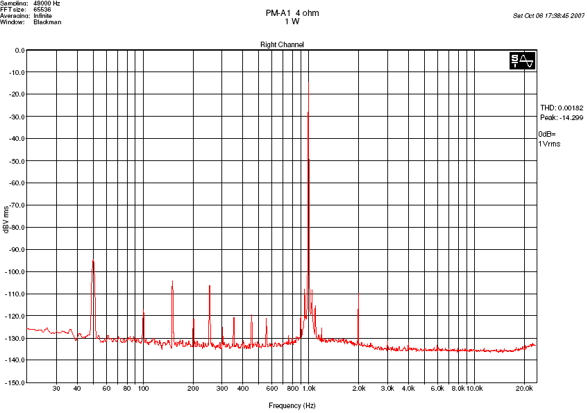

PMA said:He finds it advantageous, though high order harmonics he has are quite high!
And this is 1W. We often hear that first watt counts 😀
Look at the favorite 7th harmonic, it is the highest!! John, how would it sound??

Thanks for your input, Charles. It didn't make any sense to me, either. OF COURSE, our 1W distortion is almost nothing, and is usually some residiual 2'nd, if we decide not to bother nulling it out.
John. you were speaking about the 7th. It should have been -120dB or so according to you. Now, when Ayre has merely -93dB or so (at only 1W !!) it is fine. Of course. And there are also results of V-1 and V-3 in Stereophile. I guess they do not count as well.

It would be useful to mention a note John Atkinson placed just above these graphs:
"(Note that the higher-order harmonics visible in these two graphs are almost certainly mathematical artifacts.)"
If John himself admits it there what all the fuss is about?!

Why do not these "almost certainly mathematical artifacts" do not appear with another really good amplifiers, like Halcro etc.? Simaudio ... ?
You are pulling our legs, but you do it to wrong people, who are qualified and experienced!! We are not any dumb commercial crowd!! And probably some of us are more qualified and experienced in EE than you, who call yourself experts!!

Jan and Pavel It appears that the higher order residual is in the oscillator or the fft. Get some experience with comparing the distortion WAVEFORM with the distortion FFT.
This would be an innocent question IF you were polite about it. However, you two CHOSE to attack Charles, rather than understand the situation.
John Atkinson should not have published this pair of 1KHz measurements, because they are misleading. They show higher order distortion, but it is NOT generated in the amp under measurement. This can be easily proved by comparing the two graphs and noting that the higher order distortions do NOT increase while the lower order harmonics DO increase. This is not realistic.
At low levels, UNLESS there is significant crossover distortion, we expect only 2'nd and 3'rd harmonics at any significant level. This is because higher order harmonics are almost impossible to be at any significant level in a class A or class A-B amp. It is a mathematical series that shows the change in the harmonics with level. Higher order harmonics just don't get generated to any degree, compared to lower order harmonics. Now if Charles has significant crossover distortion in his amp, then maybe, higher order harmonics could be generated by a dead zone caused by very low bias.

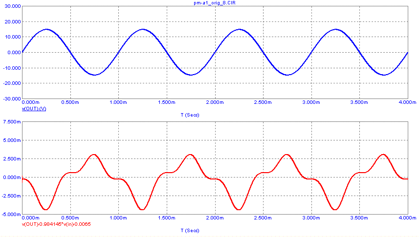

Fundamental notched
For those who can read so much from distortion residual (fundamental notched) a small question - what is the spectrum of this:
The image is to scale (read Y-axis of both curves, m means milivolts), not no-scale like Stereophile.
Re: Fundamental notched
Even harmonics, phase shifted?
Jan Didden
PMA said:For those who can read so much from distortion residual (fundamental notched) a small question - what is the spectrum of this:
Jan Didden
