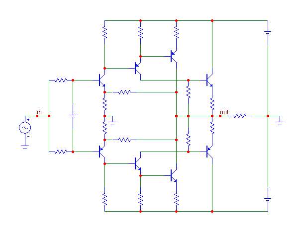

That cross-conduction flaw might be why Crimson who majored on three stage CFP (both quasi and complementary) have an HF detector around the VAS that cuts off supply to the LTP and VAS CCSs, operating at about >=50kHz.
Below that they amplify superbly.
Terry Demol said:
Thanks Bob,
Very interesting, I haven't seen these other designs.
So they still use the CFP+EF but insert a cascoded ollower 'above'
this whole OP structure.
To me it does seem like added complexity for relatively small gain.
I would think that the current modulation due to OP load causes
way more non linearity than voltage modulation across OP
devices.
One thing it would do is give much higher PSRR for OP stage
(sans FB), maybe that is a design motivation.
cheers
Terry
Yes, I don't completely understand why Bryston continues to use a stacked output stage for their higher-power designs, except that it allows them to use a lot of the same circuitry up front.
I guess if it works, don't fix it?
Bob
if EF works and quasi which is half EF and half CFP also works, then CFP on it's own should also work.
When all those can be made to work individually then please explain why combining them as Bryston have done in their EF+CFP quad output stage cannot work.
And why do Bryston offer a 20year warranty if this HF cross-conduction thing is such a big problem?

Jim Hamley said:Chris,
Very surprised to hear of Bryston reliability problems not only because of the 20 year warranty but also because a significant portion of their business appears to be in the professional market.
From their schematics, Bryston appears to use the Onsemi NPN-PNP pairs (not ThermalTrak). Their topology market differentiators are the "proprietary" power output configuration and the use of discrete opamps.
How do Bryston amps fare on the test bench? See:
http://www.stereophile.com/solidpoweramps/725/index.html
...Jim
The answer, in my opinion, based on the CCIF IM results: not bad but not great. Below is how it fares against the Parasound JC-1. The Bryston numbers are on the left, the JC-1 on the right. The Bryston has more energy from the 9th on up. All numbers are dB down:
order Bry JC-1
3rd: -90 -84
5th: -101 -98
7th: -98 -98
9th: -101 -102
11th -105 -109
13th -110 -110
15th -99 <-110
Bob
