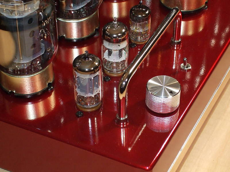

Sorry, bro, that's a RatShack knob. I used 'em for years, still have a few. Their part number 274-424.

bjut how many carver amps like the one pictured do you own?
knob is machined aliminum billet,,ask the man that owns a pair.😎

ain't no rat shack knob--pic taken by the owner of the amp that was won in the raffle at carverfest
The one in the picture is a Radio Shack part.
I can't speak for what you have and who said it has to be the same part?

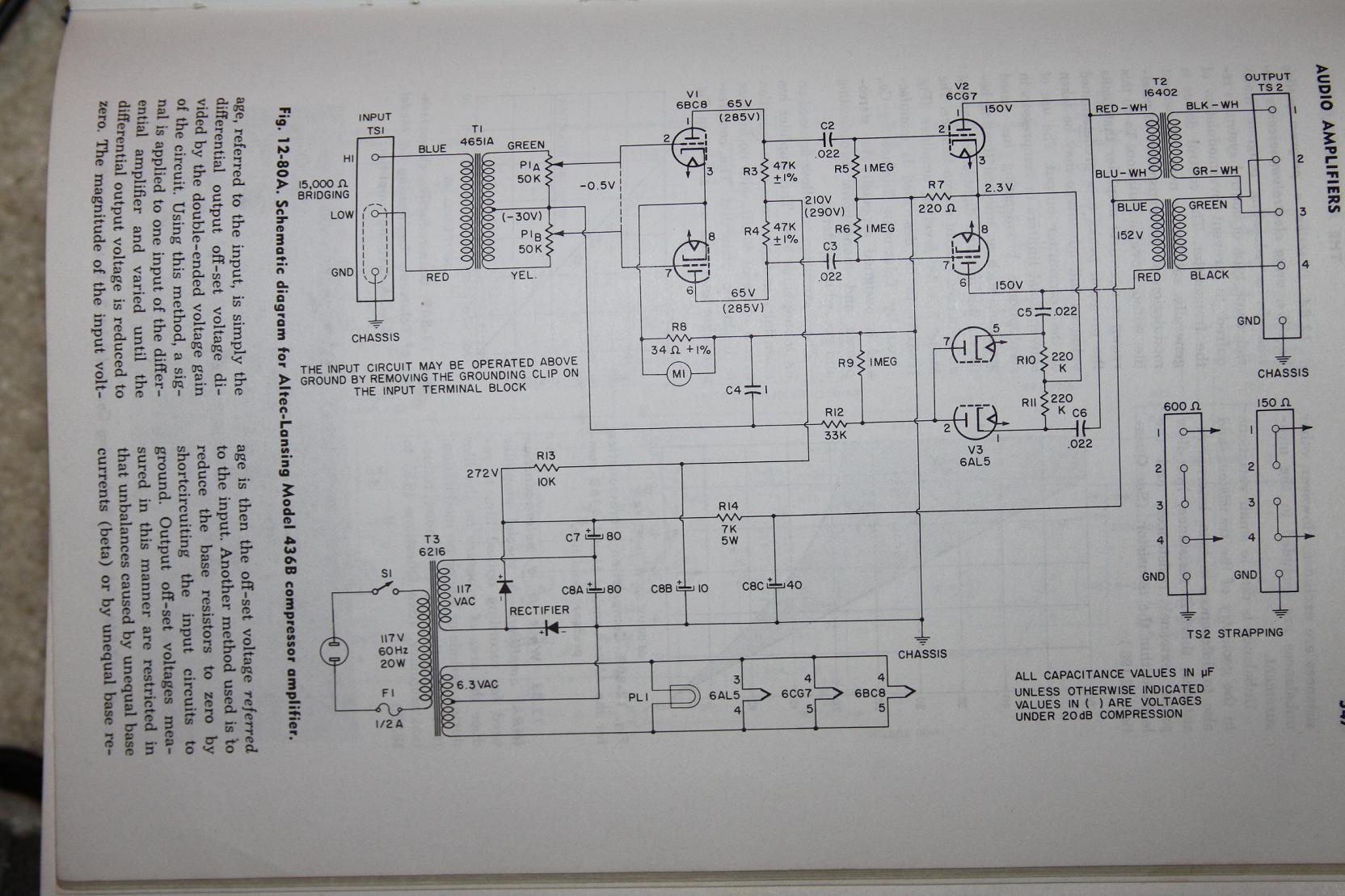

"Q: . . . would you mind explaining how your DC Restorer works please?
A: . . . As for the DC restorer, first a bit of history: A class AB amplifier works by having the positive part of the waveform amplified by the top output tube, and the negative part by the bottom tube. In the case of a sine wave, the positive part is half a sine wave, or HAVERSINE, and similarly for the negative half. During the hand-off from positive HAVERSINE to negative HAVERSINE, that is, during the crossover period, the amplifier operates in class A. For the rest of the time it operates in class B - hence AB. Now the top tubes deliver a half sine wave signal to the output transformer, and this half sine wave possesses a DC value which depends on its amplitude. For lowest distortion, the drive signal on its grid should be a mirror image of the transformer drive signal and possess a corresponding DC value. It should be an identical haversine, differing only by the gain of the tube. And the two signals should be in perfect synchronism. Normal practise is to drive the grid with a standard sine wave that is symmetrical about the zero axis, so its DC value is zero. The DC restorer clamps the bottom half of the grid drive signal, thereby imparting a DC value to the grid and simultaneously providing a mirror image of the plate signal. The result is that both plate and grid have corresponding DC values. The best part is that idle power is cut to about one third, distortion to about one third, and finally, NO DC shift! The old way required enormous (by my standards) idle power in order to overcome or minimize these problems, never properly fixed the problems anyway, and has vexed designers since the very beginning. Often the output tubes were idled right at their maximum possible power rating, or even slightly beyond, often glowing cherry red. They got too hot, and didn't last long. WHEW! I hope you're still awake! Bob."
Every vacuum tube amp in the world suffers from shifting DC operating points, and this unfortunately has remained a functional limitation and maddening sore point for amplifier designers ever since the very beginning of vacuum tubes. Consequently I had to invent a DC restorer circuit using a 6AL5 / 5726 tube; it eliminated every last vestige of DC shift, while simultaneously reducing distortion three-fold and vacuum tube idle power by the same amount. As Tim would say, "Nothing new under the sun", just the same, it's never been done before, and it works flawlessly.
Sorry Bob,
My Audio Cyclopedia dated 1959 , on page 547, has shown that the Altec Lansing 436B compressor amplifier also used the same "a DC restorer" circuit that you have claimed invented, what a coincidence, used the same 6AL5 tube. Care to clear-out the smoke? Attached is the schematic.
