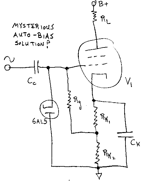

I had correspondence with him about a year ago regarding the "6AL5 DC restorer" circuit.
I'd be interested in any details you could share. Carver is a truly innovative engineer.

That's the one exactly!!
The DC restorer with 6AL5. He sent me some drawings of this in his latest vintage amp build that was sold on ebay.
...The DC restorer clamps the bottom half of the grid drive signal, thereby imparting a DC value to the grid and simultaneously providing a mirror image of the plate signal. The result is that both plate and grid have corresponding DC values. ...
The circuit above doesn't clamp the bottom half of the grid drive signal. Bob also said the DC restorer doesn't have a time constant. The self-bias with bypass cap above seems to have a time constant.
"For lowest distortion, the drive signal on its grid should be a mirror image of the transformer drive signal and possess a corresponding DC value. It should be an identical haversine, differing only by the gain of the tube..."
The plate voltage signal is a whole sine wave. The plate current is a half-sine. I'm not following why the grid "should possess" a DC value corresponding to the DC value of the plate current. I think I'm still missing something.
Michael
Yes, in case of an ideal tube. But an art of amp design would not exist then.
